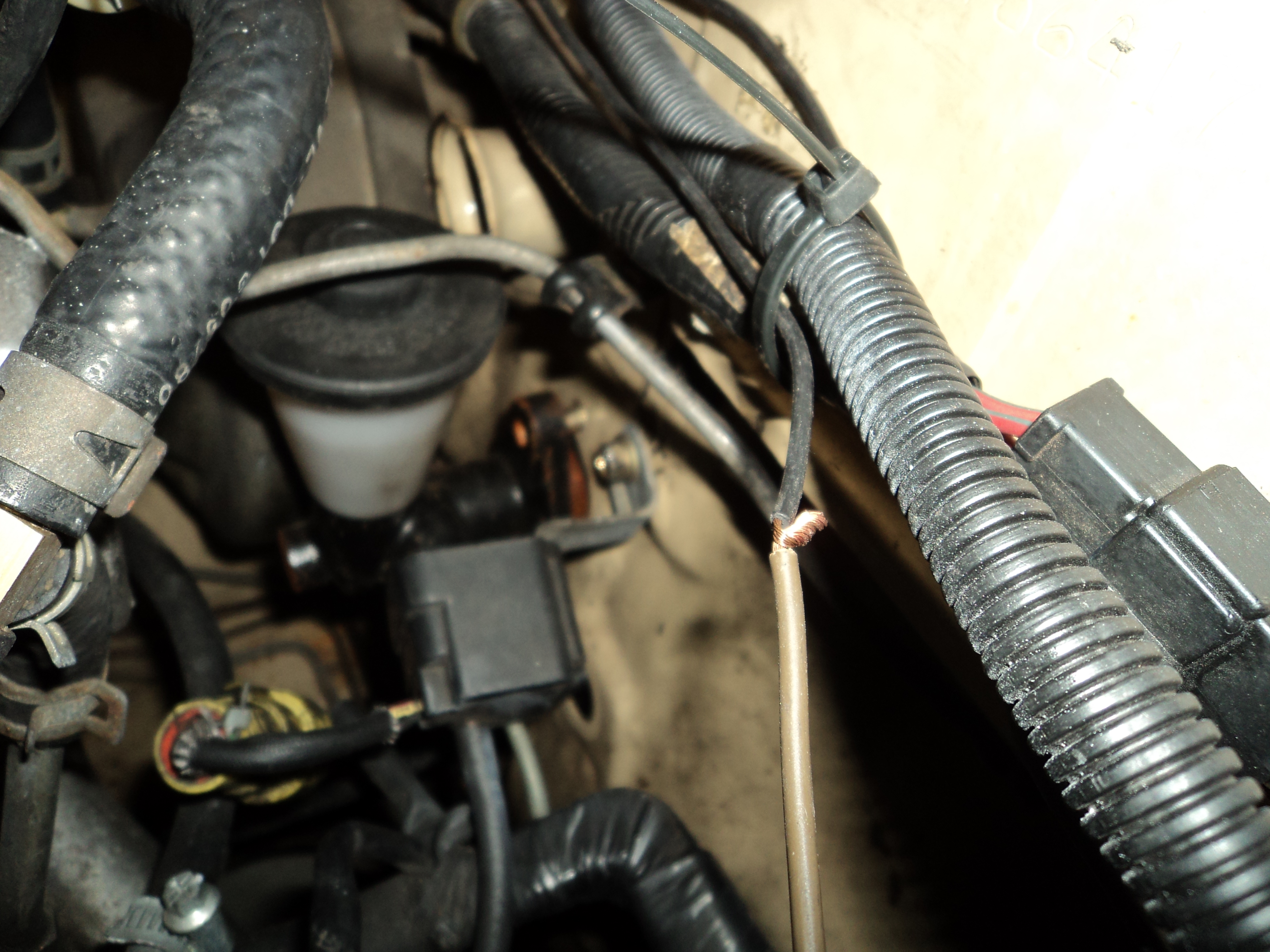

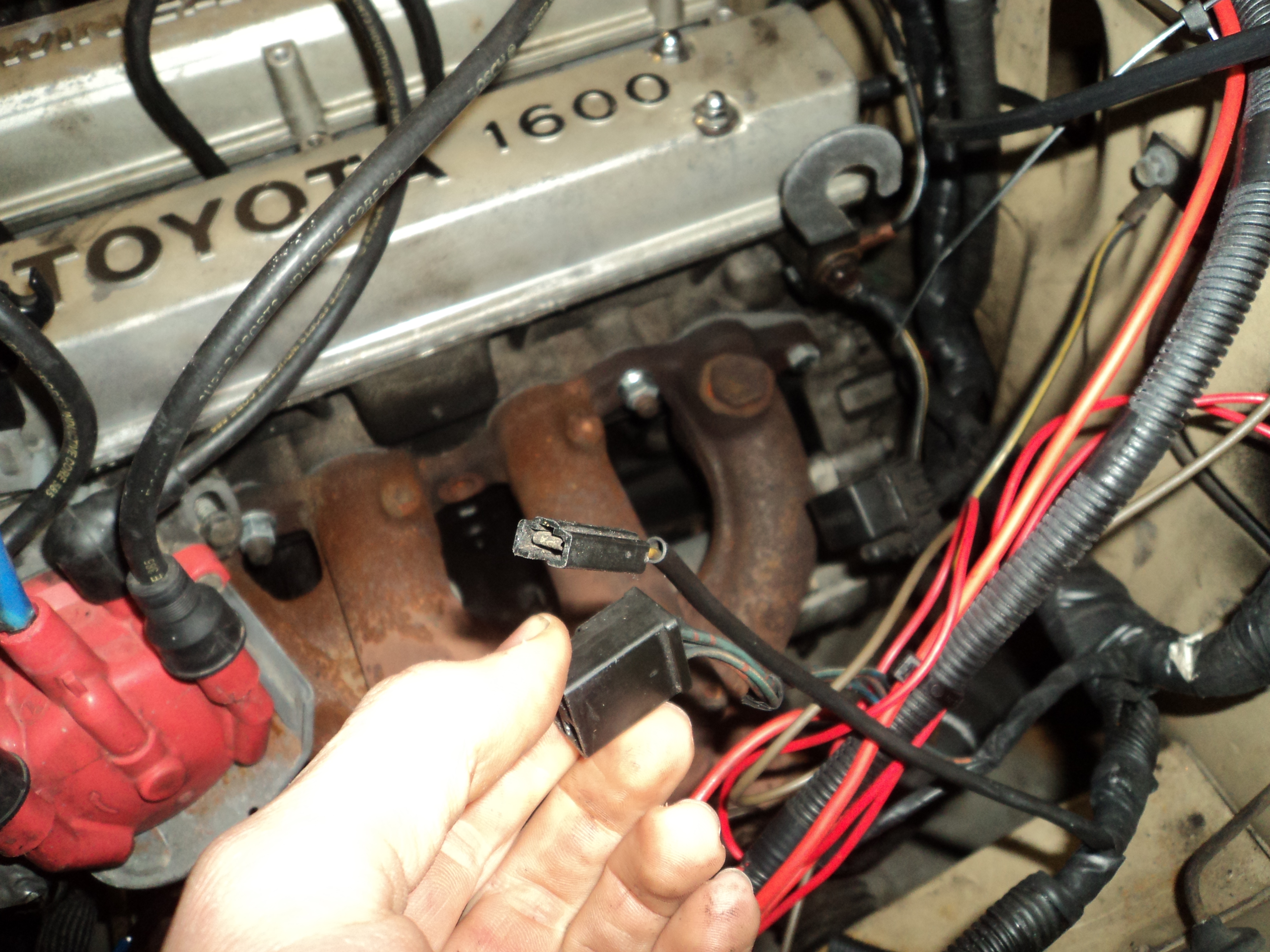

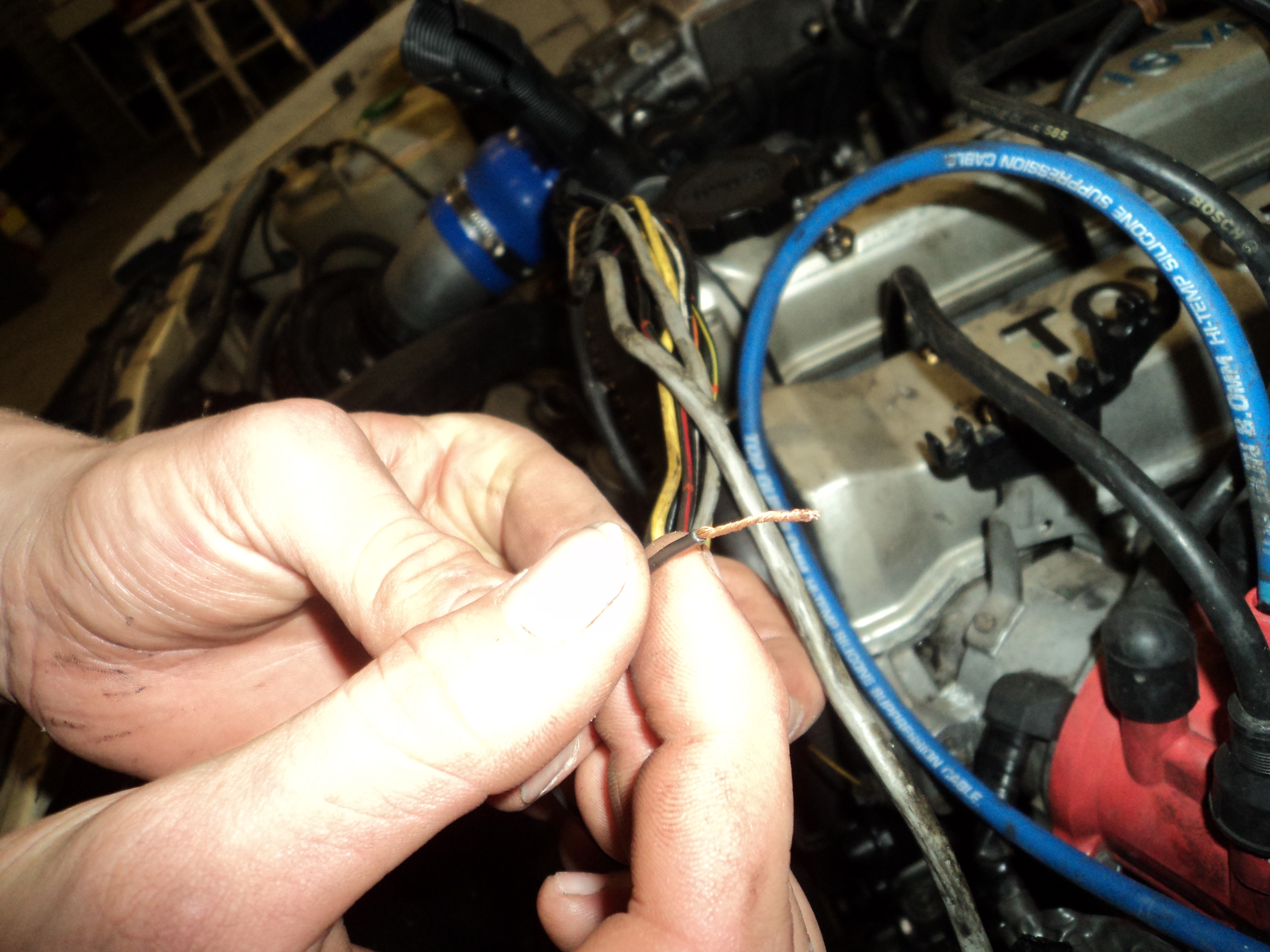

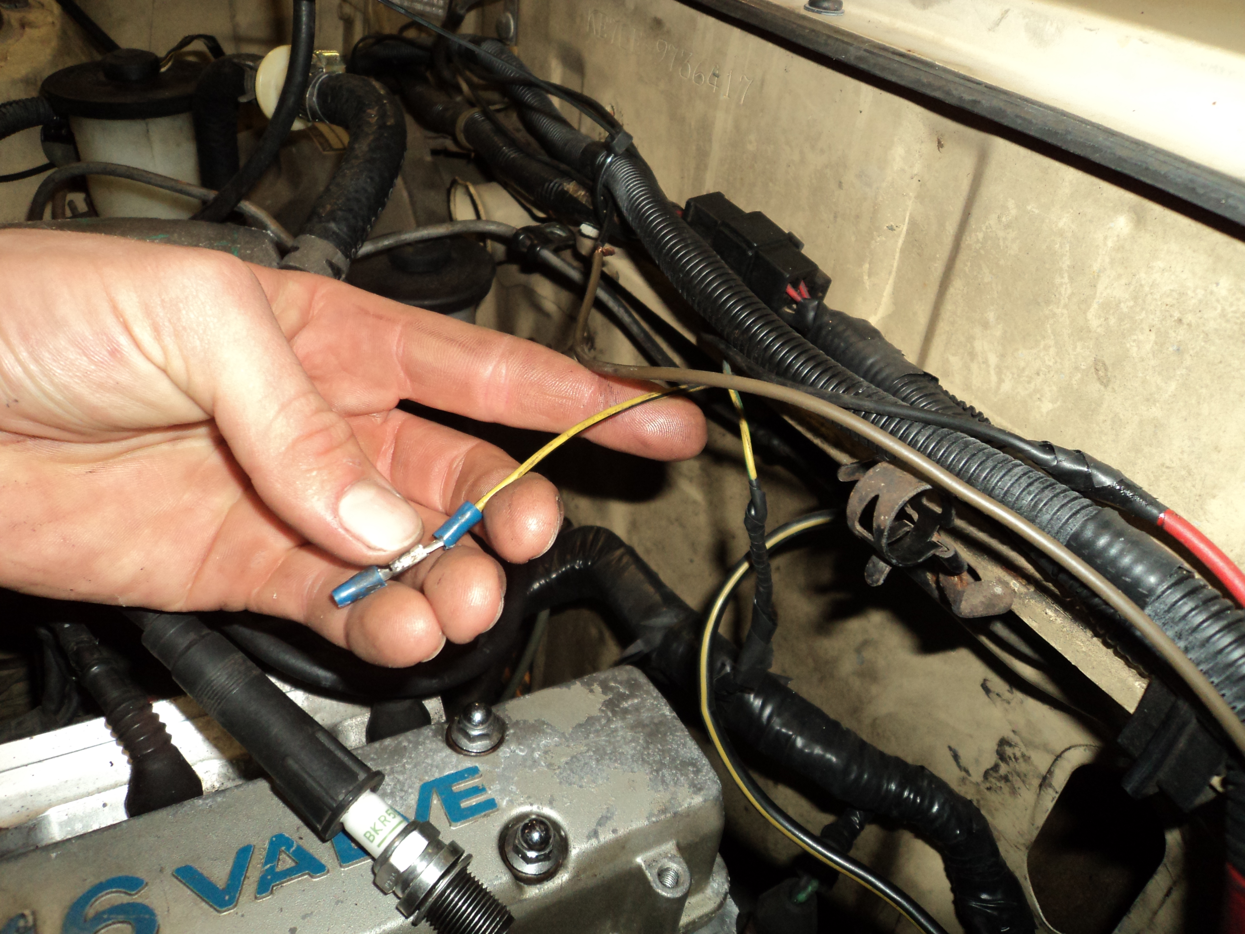

ok here are some things that arnt connected
#10 CommonhoreSlayer
CommonhoreSlayer
    New Member
  • Members
  • PipPip
  • 20 posts
  • Real Name:Dan
Posted 27 July 2011 - 10:27 PM

Sounds like the ecu isnt getting power or the earth isnt decent.
Only like 5 wires need to be hooked up when doing the conversion into KE70

Posted 28 July 2011 - 09:36 AM
that little black plug is important.
find out where it goes and get back to us.

To me it looks like the one that connects to the oil pressure sensor. Its located on the left of the extractors by the oil filter.

Hay there is a ground cable that was conected to the body near the fuel lines near the bell housing. Buut not conected to anything then there is another one on the gear box that isnt connected to anything thoughts guys
