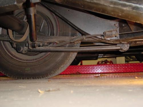

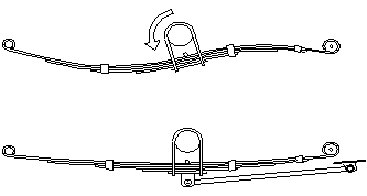

I thought it wasn't a big problem on the suspension but believe me it is. Front will be lowered like that but there needs to be some space for the tyre to work so i have to modify the front arch 99% but i have to wait for the shocks so i can start modifying the struts in to coil overs. Rear not sure but i think the way to go lowered the way i want it and to look nice is to modify the car and do a 4 link and the car will sit on coil overs at the back. I know that it could be done on blocks but i do not want the car to have a 4 inch block to be lowered. Its basically just for looks only. To give you and idea where i am at the moment i removed the shock and left the car on one spring. The car lowered to the point that the diff came touching to the body and still there needs to me more lowering so i need to make space for the diff housing under the seats. Any ways that will be handled later on. This is like what i had originally bought the t50, had the longer tail shaft housing which when i when to fit it in my car the leaver came really back wards. Then started to look on the the web and forums and there is a gearbox that has a shorter tail shaft and it was a t40 with only 4 gear. I wanted the car with 5 gear so had to opened the two boxes and swap gears and linkages which wasn't that difficult. You have to just remember what you removed first and reciprocate.
