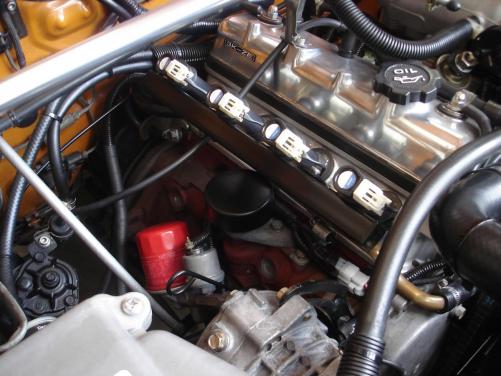

I don't know of a pre-made cover/conversion but I just cut the old top off the distributor and the shaft to keep the bearing section, then machined the housing down and simply fit a welch plug over the end to keep out all the junk/ keep the oil in. was the neatest solution that I could come up with.
there is machining involved but it is an easy 10 min job so shouldn't cost much to get done at a machine shop.
you can sort of see it in this pic

A few guys on here have done what you are suggesting. Pretty relevant if you are going waste spark or COP (coil over plug), where you don't need a distributor at all.
Brodie in S.A. did a very neat job on his Rolla when he went COP.
I went waste spark, and just cut the dizzy down with a hacksaw & cleaned it up with a file. No machining needed.
Waste Spark Commode Coils X 2 mounted on the block so little HV cable movement.
I also blanked off the mechanical fuel pump, as it is now going EFI.
It doesn't show in my pic, but I think I found a coffee jar lid that fitted perfectly over the "cut down" dizzy.
Off memory, I think Brodie did a similar thing with a lid from a biscuit tin or something.
However, the idea of a welch plug with a bit of machining, is probably the best solution, if you want something that is perfectly sealed, and oil drip free.
Cheers Banjo
