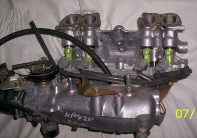

7K-E
My knowledge of the 7K-E only extends to those delivered in Australia, I have not been informed of any 7K-E engines delivered outside of that area, if you do know of any other regions, please contact me so I can update this entry.
UPDATE : I have been in contact with a person in SRI LANKA who owns a KR42 Van with a 7KE!
I have also scanned a copy of the 7KE Manual which may be downloaded directly from here:
http://www.rollaclub.com/hosted/7KE-manual.pdf (50.1 megabytes large)
The 7K was the final revision of the Toyota K series engine before it was dropped from production in 2002. Boasting 1800cc and plenty of torque, this was an engine designed for and destined to be used in Toyota's Commercial series mini-vans. These can be found by searching for any later model Toyota Vans whose chassis codes begin with KR4xxxxxx
Essentially the 7K block was just a revised 5K (1500cc) design with identical piston width and specs? but the 7K was "stroked" ~300cc larger overall. This meant an engine with plenty of torque (pulling power) but not intended for huge revs or racing.
There was also a 7K-C (Carburettor) version earlier on, with the main difference being crank diameter was a couple of millimeters larger in the EFI engines to handle the higher torque. Also there are some holes in the 7K-E head that don't exist in any of the other K engines.
With a bonus for people with KExx chassis id'd cars, these engines are a much more straight forward "bolt-in" option (compared with Twin cam installations) with the promise of Bigger Torque, Bigger Power and the best benefit of EFI !
The 7K-E inlet setup features a much shorter and efficient runner design than the 4K-E did.
Once again, modifying a 7K-E injection setup will require a little bit of forward thinking and planning, but at the end of the day, this setup could quite easily run forced induction with an aftermarket ECU and a well designed exhaust manifold - you would of course want to make that all "low-mounted" and heat sheilded due to the fact that the Inlet and Exhaust is all on the same side with K Series engines.
Availability : It is becoming more common to hear about them now, but mostly people steer clear of the "truck" engine :) I would love to hear from other people using 4K-E and 7KE series engines in whatever application as it interests me quite a bit. Once again, these sell on eBay for varying amounts and at one stage or another, some of our members have owned / played with a 7KE setup.
Here is a link to a PDF file of a 7K-E setup that sold on eBay, showing that there is much demand for EFI setups 7KE on eBay
Troubleshooting : I do know of someone who has access to the Toyota factory 7KE manual, and obviously being a newer engine a lot of dealerships would still have to carry it. UPDATE : We have a copy hosted now - http://www.rollaclub.com/hosted/7KE-manual.pdf (50.1MB in size)
