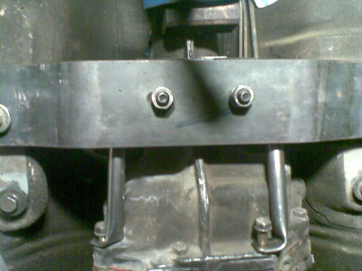

cuzzo Posted June 16, 2010 Report Share Posted June 16, 2010 Does the gearbox have any crossmember mounting points or it mounted off the side of the box? Quote Link to comment Share on other sites More sharing options...

78_7kRolla Posted June 16, 2010 Author Report Share Posted June 16, 2010 Cuzzo - Because it is an actual townace gearbox the mount from factory is actually at the top of the extension housing and no mounting points are on the bottom of this particular housing. Si - No problems mate, when it's all done i'll put together what i did to carry out the conversion. I am trying to take pics as i go along :lol: JP - Peace of mind and reliability should be nice. Should be able to handle what i throw at it! In terms of updates there will most likely be little progress this week as we are short staffed at work :( Meaning little time for side projects aka my car. Quote Link to comment Share on other sites More sharing options...

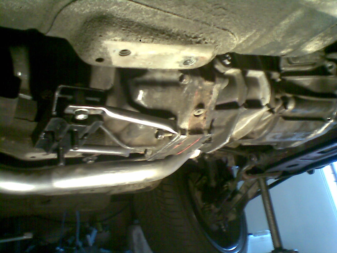

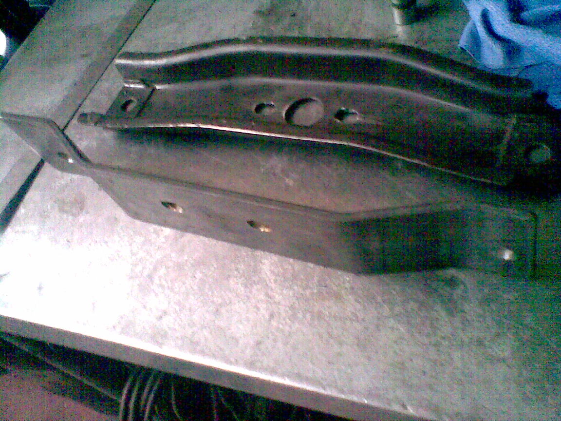

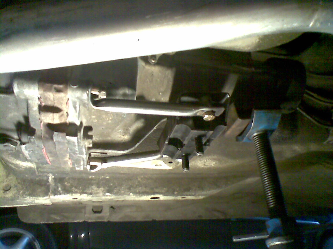

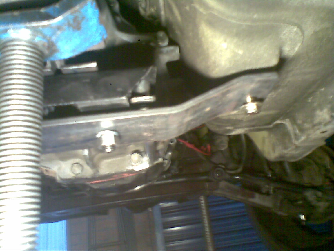

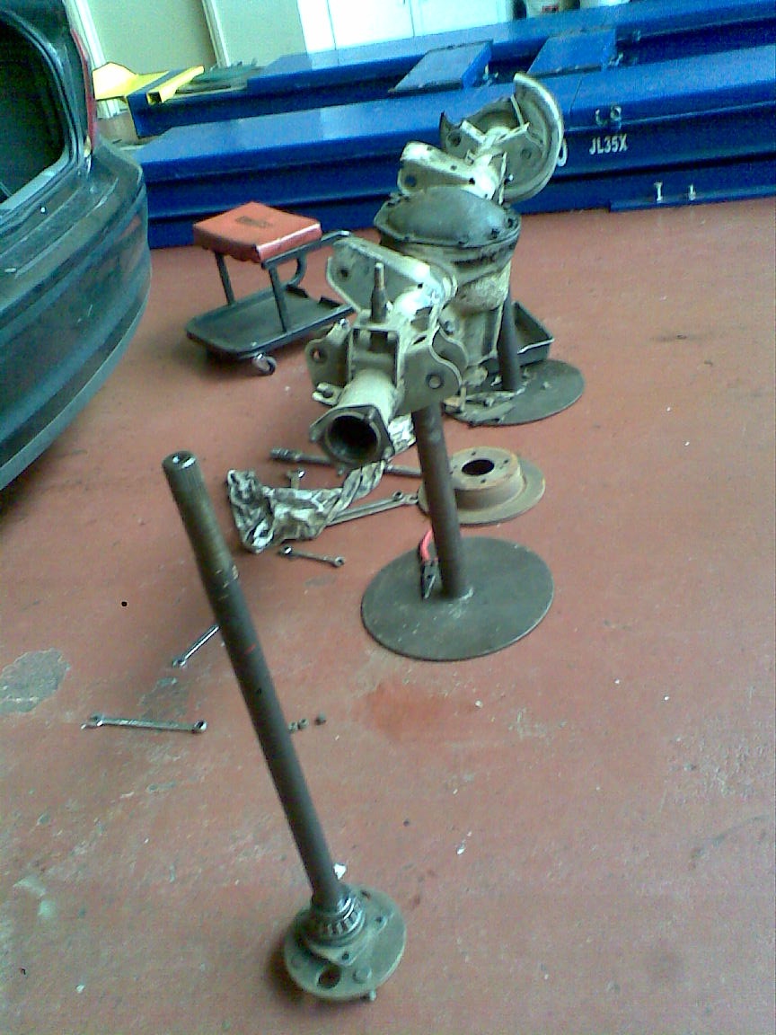

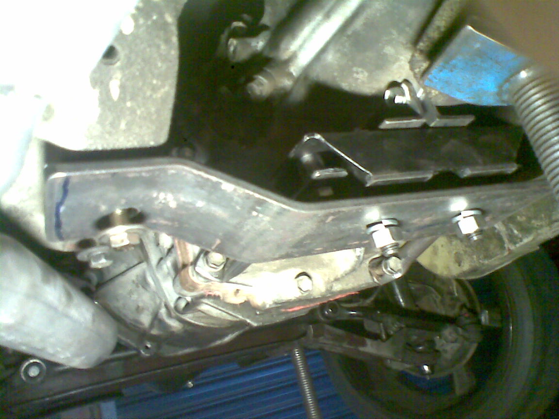

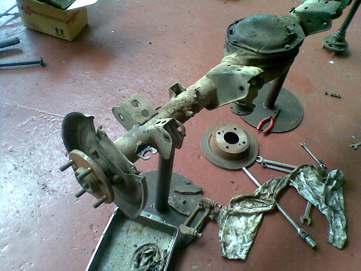

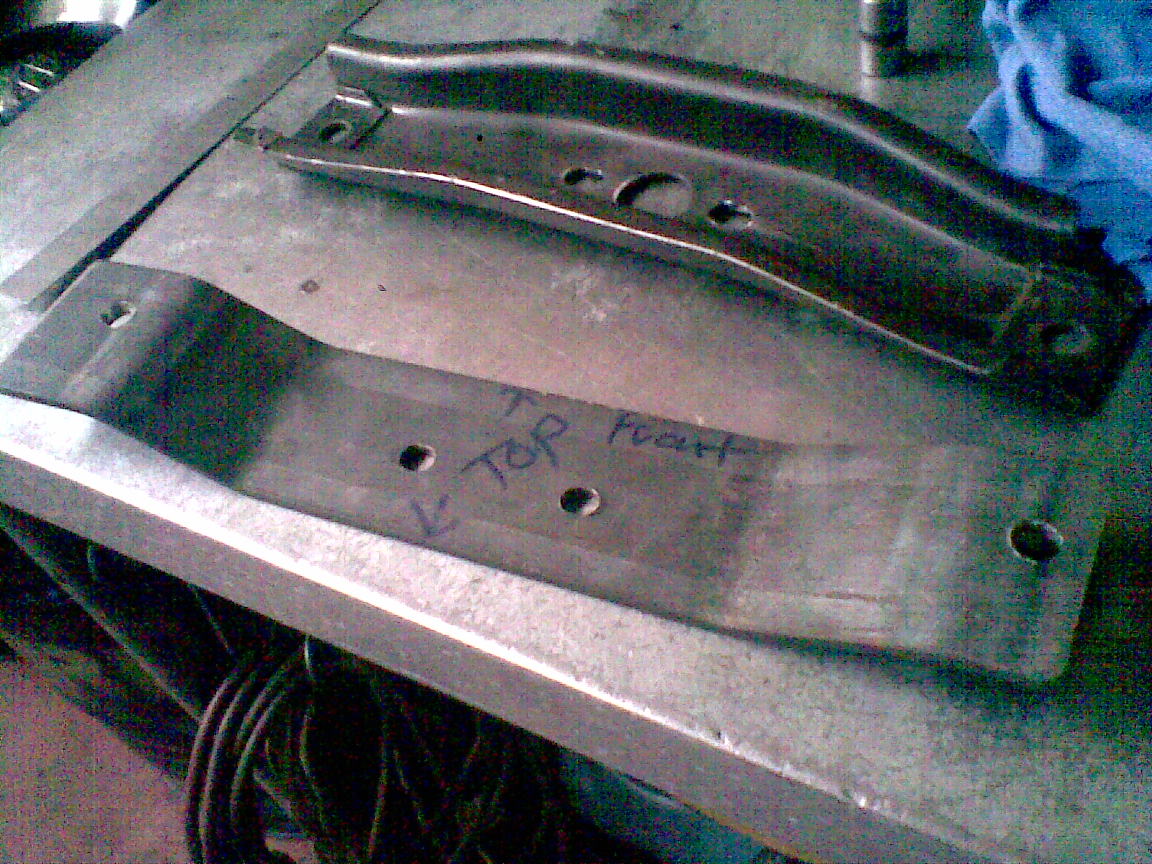

78_7kRolla Posted June 19, 2010 Author Report Share Posted June 19, 2010 Your gearbox is most probably a ke70 5 speed as the shifter was further back on them. UPDATE! Got my new clutch yesterday and ta22 clutch master cylinder. Got a shetload of work done today :dance: Gearbox is pretty much mounted up and we have now sorted out the crossmember. Ended up making one out of flat bar instead of modding the old one as this will give much more ground clearance. Also begun work on part two of the upgrade. R31 diff ;) Here are some photos. Crossmember mounting... R31 diff deconstruction... Mmmm 28 spline.... Clutch Still to do: - Modify pedal box and firewall to carry out hydraulic conversion - Remove dummy fitted gearbox and fit clutch and clean up all the bits and pieces - Get a 3.7/3.9 center for the diff and LSD to suit - Get diff shortened and mounting brackets fitted - Custom tailshaft to suit all the above - Work out the braking situation (will cross that bridge when i come to it) That's all for this weekend. Matt. Quote Link to comment Share on other sites More sharing options...

78_7kRolla Posted June 20, 2010 Author Report Share Posted June 20, 2010 Nah mate, used existing one as the shifter hole lined up perfect. I'm not sure how well you can make out from the photos but you can see two tubes/pipes going from the extension housing bolts to the gearbox mount that is also attached to the back of the gearbox via two L-shaped brackets back to back. Quote Link to comment Share on other sites More sharing options...
Doogs Posted June 20, 2010 Report Share Posted June 20, 2010 Good progress Matt, I didn't realise you were going for the diff upgrade too. Top stuff ! ;) Does the R31 diff require shortening to fit ? What's the width difference between it and your standard diff ? Cheers Quote Link to comment Share on other sites More sharing options...
