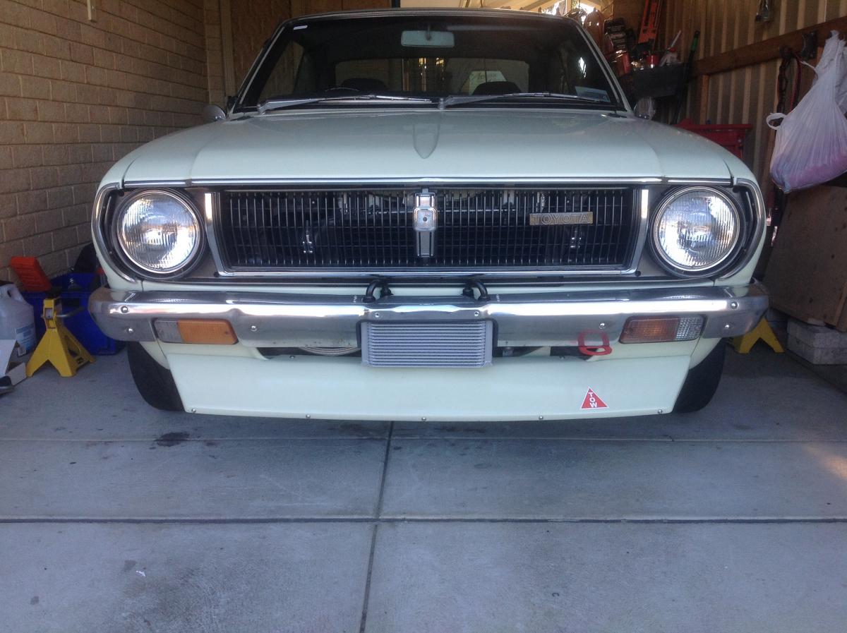

Have added and changed a few things since the last post, new turbo back stainless exhaust, and also dropped one of the mufflers.
Made up a cooling panel to divert more air towards the radiator, and during last couple of events I have been adding some bonnet raisers to help vent out some heat.
Some serious heat build up in the engine bay, with the new turbo glowing after each session.
Also hooked up an intercooler spray, and in the process of fitting an oil cooler and larger sump.
Some big changes coming soon though, as it develops into more of a dedicated track car, full weld in cage, linking front and rear chassis, and new seats and harnesses.
And if there is any tax money left over, some wider race rubber.
So will be stripping it down, hopefully only out of action for a month or so.

Pics of the air diversion panel.
Have started the oil cooler and thermostat set up, wasn't many option for placement.
Running out of room!!
And didn't want to go full Boso style, Although I did have to cut the front bumper for it to fit.
Number plate covers it nicely for any road driving, the only thing that gives it away are the tops of the fittings poking out.
On the track plates are off and it will have full airflow exposure.
