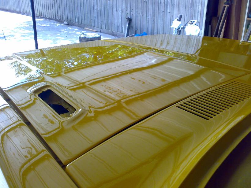

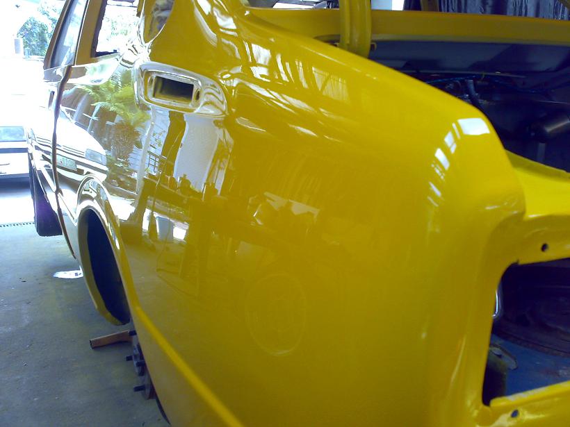

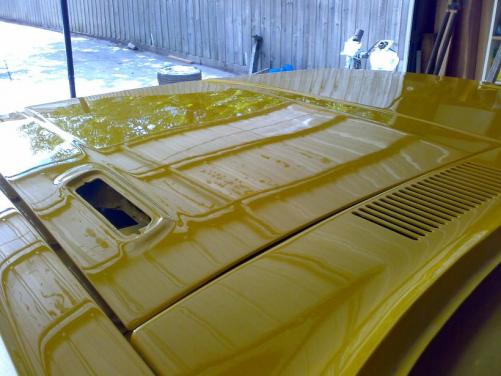

kangaroosa Posted December 16, 2009 Report Share Posted December 16, 2009 (edited) You thin your paint to a certain consistancy....not to a ratio. Ratios may get it in the ball park, but getting the right mix will perfect it. I have never used Supercheap paint, nor would i ever. You get what you pay with Paints. Reading a book and doing some googling may help save you money infact. When you put the first pot of paint onto your car and it runs like crazy.....its going to cost you wet and dry paper, more paint, more thinnners plus your time. You will need 15-20psi in pressure, but you will need a steady supply. A compressor running out of puff midway through a panel is never fun. I've written a few how to's on painting already and i'm not going to do it again. But find a spare panel and practice first. Get your pressure and spray pattern right. This is my car that I sprayed a few months back in Automotive Acrylic. Just so you know what finish you can achieve if you spend some money on 'decent' paint and thinners. Edited December 16, 2009 by kangaroosa Quote Link to comment Share on other sites More sharing options...
KESR20 Posted December 16, 2009 Author Report Share Posted December 16, 2009 wow that looks great! hmm ill look into it more n check out ur posts on painting! Quote Link to comment Share on other sites More sharing options...
