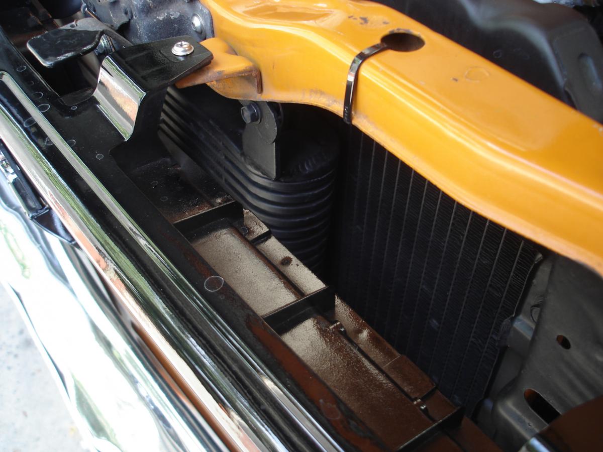

This shows the intercooler, believed to be a colorado/dmax item, between the grille and radiator.
Radiator has been remounted about an inch higher, be redrilling it's mounting ears, to allow 2" intercooler pipes to pass neatly underneath. NOTHING was cut on the car.

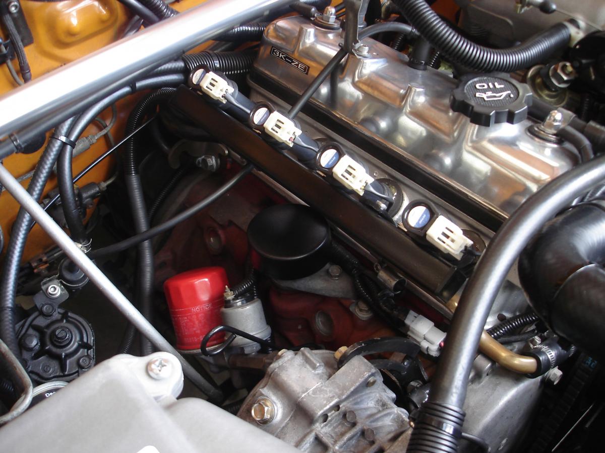

Finished dizzy cap arrangement. Old dizzy has been cut down. Still need to neaten up the boots of the COPs though, will get to that with some sikoflex one day.

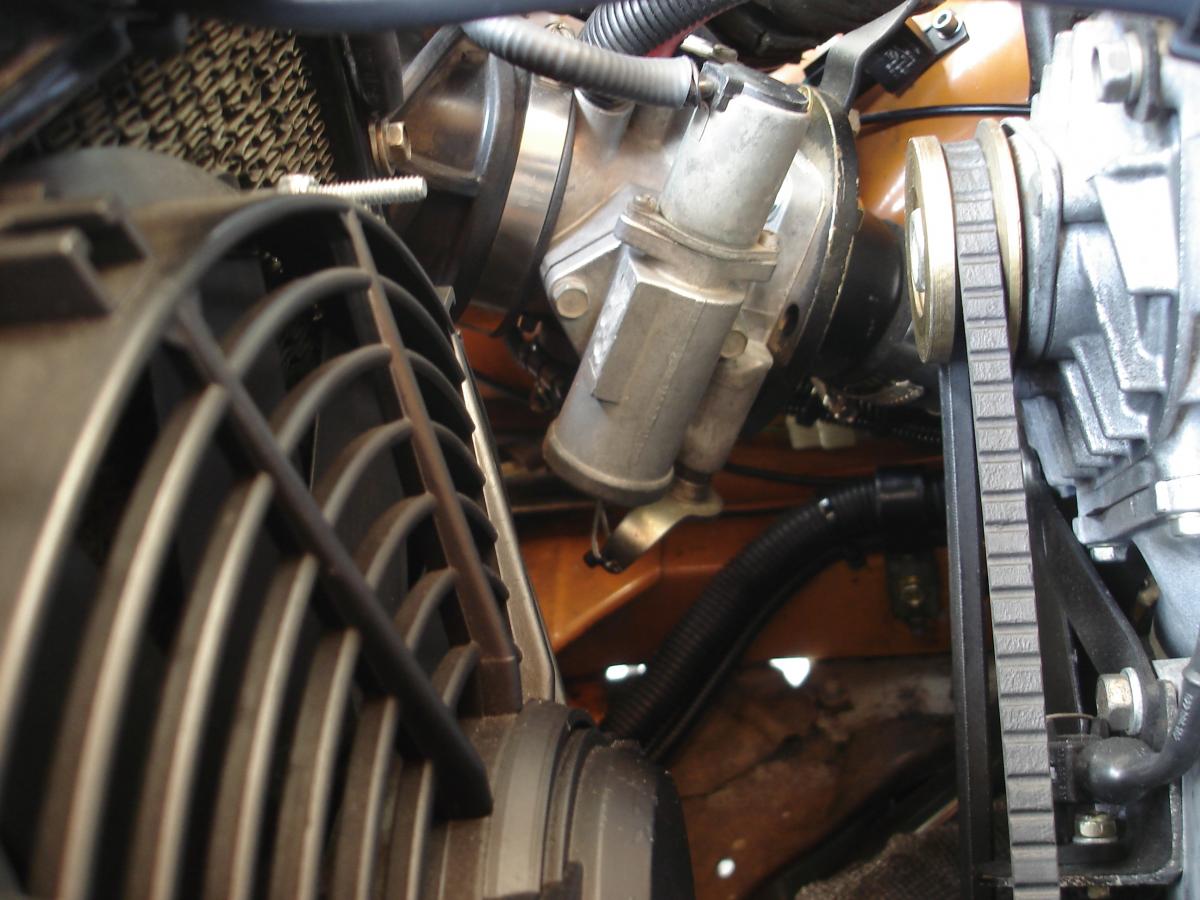

This shows the secondary throttle body, which sits under the airbox & in front of the charger. These days its paralleled with the pedal, rather than the vacuum-controlled arrangement I once had. It keeps things much much quieter. Note the large cylinder on the front of it, that's the bypass which is controlled by Megasquirt.

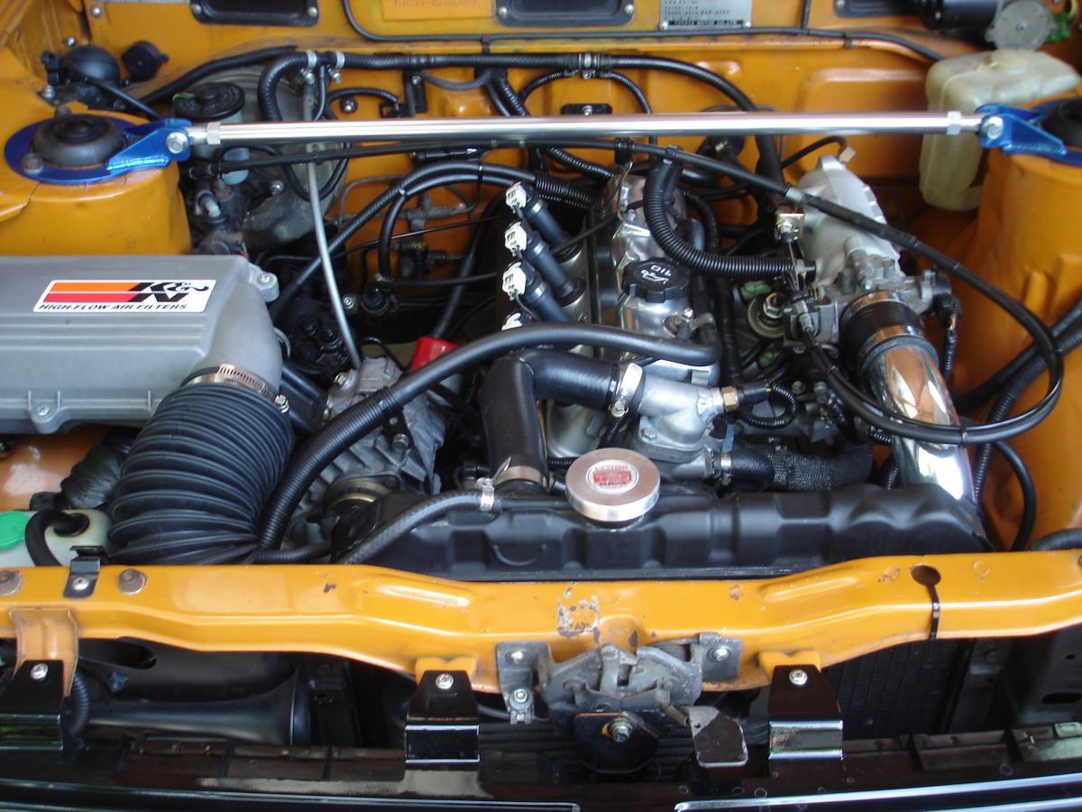

Current engine bay pic.
