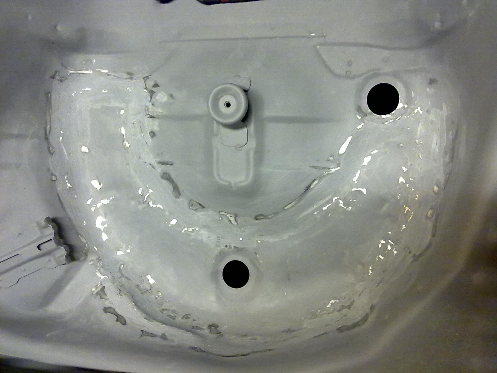

This process had to be repeated a few times, as I'd grind to clean up the last weld only to create/find a new hole :bash: Frustrating but worth the effort in the long term I guess, more metal than metalmend seems a better idea! Shown here getting a good hit of rust converter.

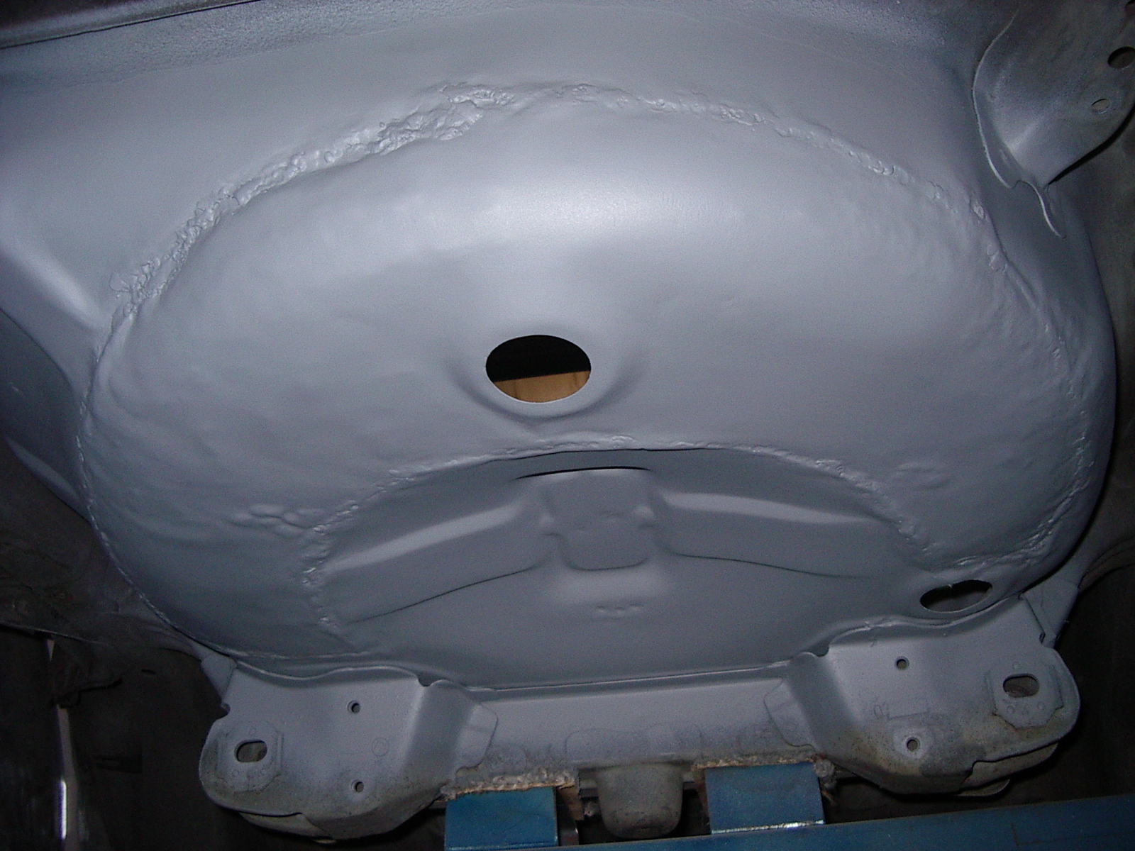

Underneath.
Today all this is destined for a hit-up with a fine grade wire brush & a wash with wax/grease remover. Then some metalmend repairs to the worst of it, then sand that back & hit up with some normal filler. If all goes well I might even get some primer on it! *crosses fingers*

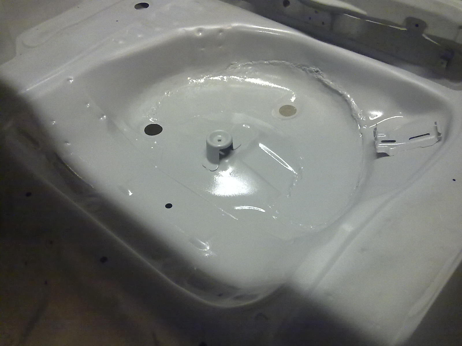

Mmmm...shiny.
We have primer! :yes:

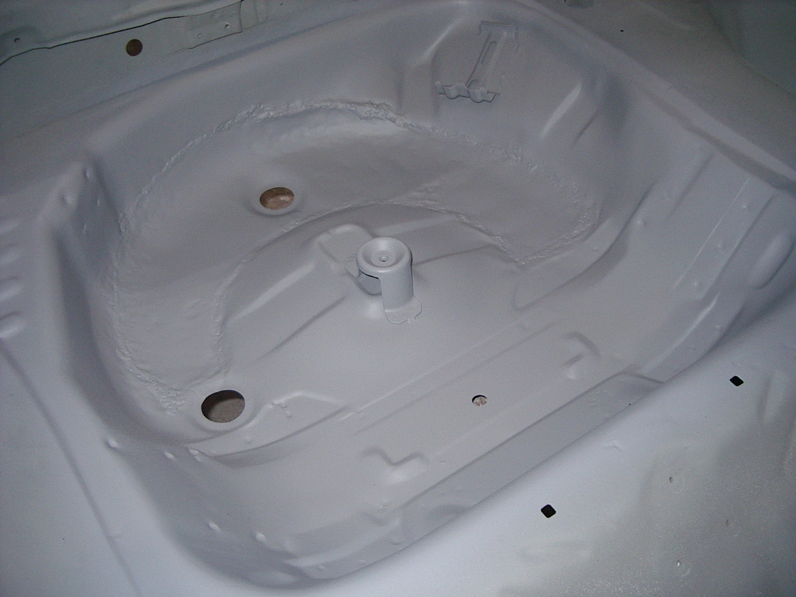

Righto, progress! Photos coming courtesy of 3.2 megapixel digi-cam as opposed to 5.0 megapixies phone with scratch on lense.
Primer's nice & dry.

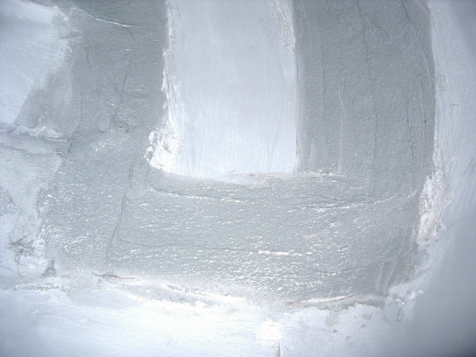

Quick scratch up with some sandpaper inside...
...And some MetalMend love!

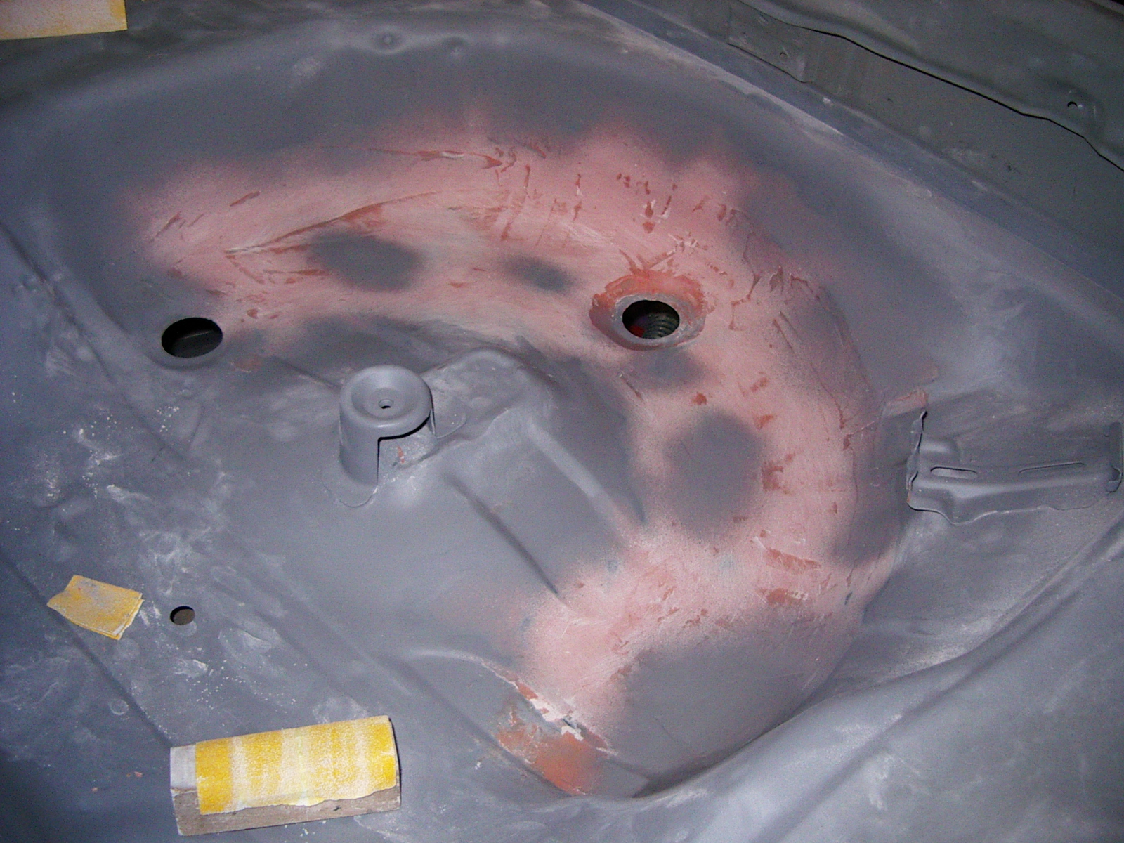

While that was drying, I sanded up the MetalMend & put on a second lot.
With a smoother finish than before :wink: Less sanding!
