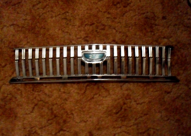

Jono.C Posted March 21, 2011 Author Report Share Posted March 21, 2011 Got a tip for you My corolla's bumpers had been sitting in weather for months if not years, they'd gone flat and had a bit of surface rust. Before you invest in re-chroming Give them a good wash, and give them a once over with some cutting compound. You would not believe the difference. Unfortunately i didn't take a before hand photo, but i will have an 'after' photo up soon. Bar a few tiny little chips they look amazing. It's worth a try. Cheers! Quote Link to comment Share on other sites More sharing options...
Jono.C Posted March 21, 2011 Author Report Share Posted March 21, 2011 (edited) This is the result from a short time spent with a rag and some cutting compound. No more crappy black paint. Also, picked up this manual off ebay a few months back, printed date is '68. Very useful, if you see one, buy it. Edited April 23, 2011 by Jono.C Quote Link to comment Share on other sites More sharing options...
Guest pmp16 Posted March 21, 2011 Report Share Posted March 21, 2011 Problem wiv using cutting compound is u will need to keep polishing bumpers n grill etc so they don't get surface rust or become dull from using te compound Quote Link to comment Share on other sites More sharing options...
Jordain Posted March 21, 2011 Report Share Posted March 21, 2011 Thats why you 2pak clear them if you are worried. Quote Link to comment Share on other sites More sharing options...
jimi91 Posted March 21, 2011 Report Share Posted March 21, 2011 or ya just use brasso :lolcry: see ya jimi Quote Link to comment Share on other sites More sharing options...

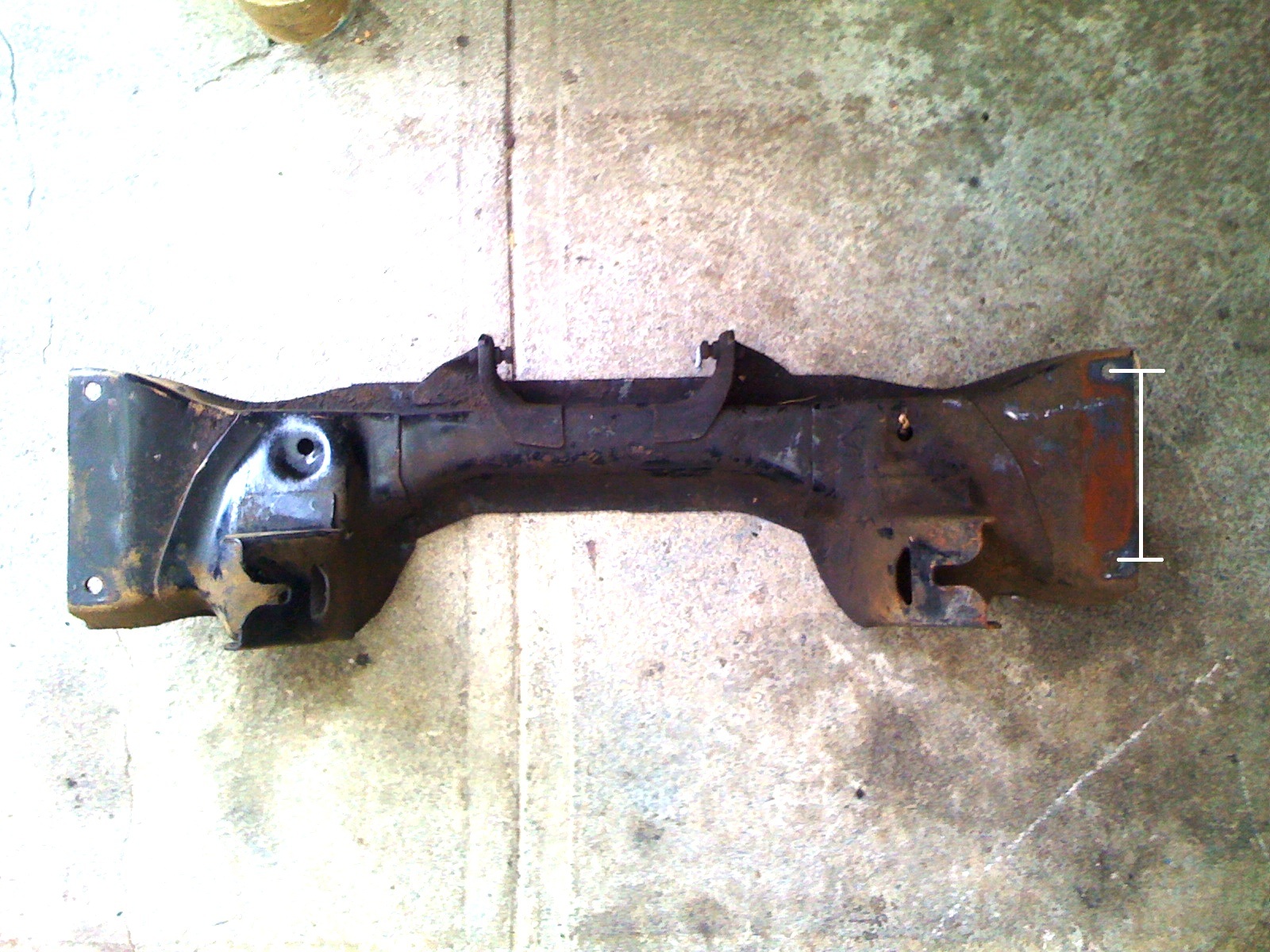

Jono.C Posted March 22, 2011 Author Report Share Posted March 22, 2011 Nah, should be right, you can wipe the cutting compound off with petrol or similar if you feel the need to, still looks the same. Had a scope and measure up of the 2 corolla crossmembers The measurement from middle of each hole (as indicated with the white lines) on a ke20 is 135mm, on a ke10 is 100mm. So i'll have to redrill 2 or maybe all 4 of the holes. The reason i say 4 is i noticed on the otherside of the holes the is a plate which i presume is or strength which has a raised up section right next to here i need to drill. So if i drilled there i couldn't bolt it on properly. I might have to heat it up and flatten that bit down. We'll see. Jono Quote Link to comment Share on other sites More sharing options...

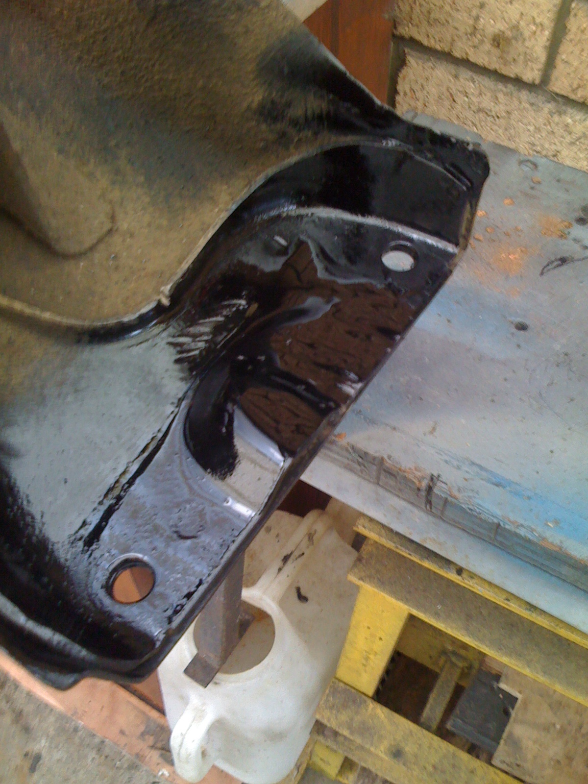

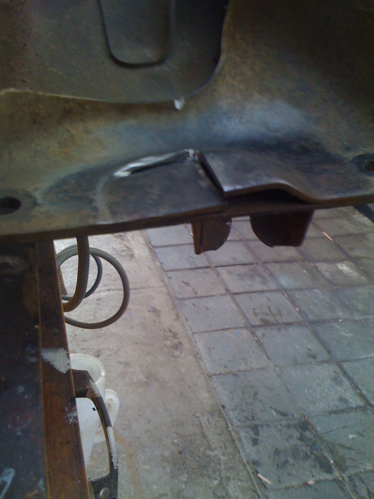

Jono.C Posted April 23, 2011 Author Report Share Posted April 23, 2011 (edited) So today i started working on getting the Ke20 engine crossmember in. Not as simple as it may seem. You need to redrill atleast 2 of the holes, except you can't! because toyota put a rasied up strengthening bar right where you need the hole (omg lame) So, out comes mr grinder. Relief cut to allow it to be flattened Press flatened and surrounding metal hammered down to allow for easier/ cleaner welding Edges welded together and ground smooth Sprayed black for neatness and or filthness (omg, hektik) Next up is holes being drilled. As this comes up in question i'll be doing this step by step in my build thread as well as maybe a faq thread if people think it's worth it Edited April 23, 2011 by Jono.C Quote Link to comment Share on other sites More sharing options...
