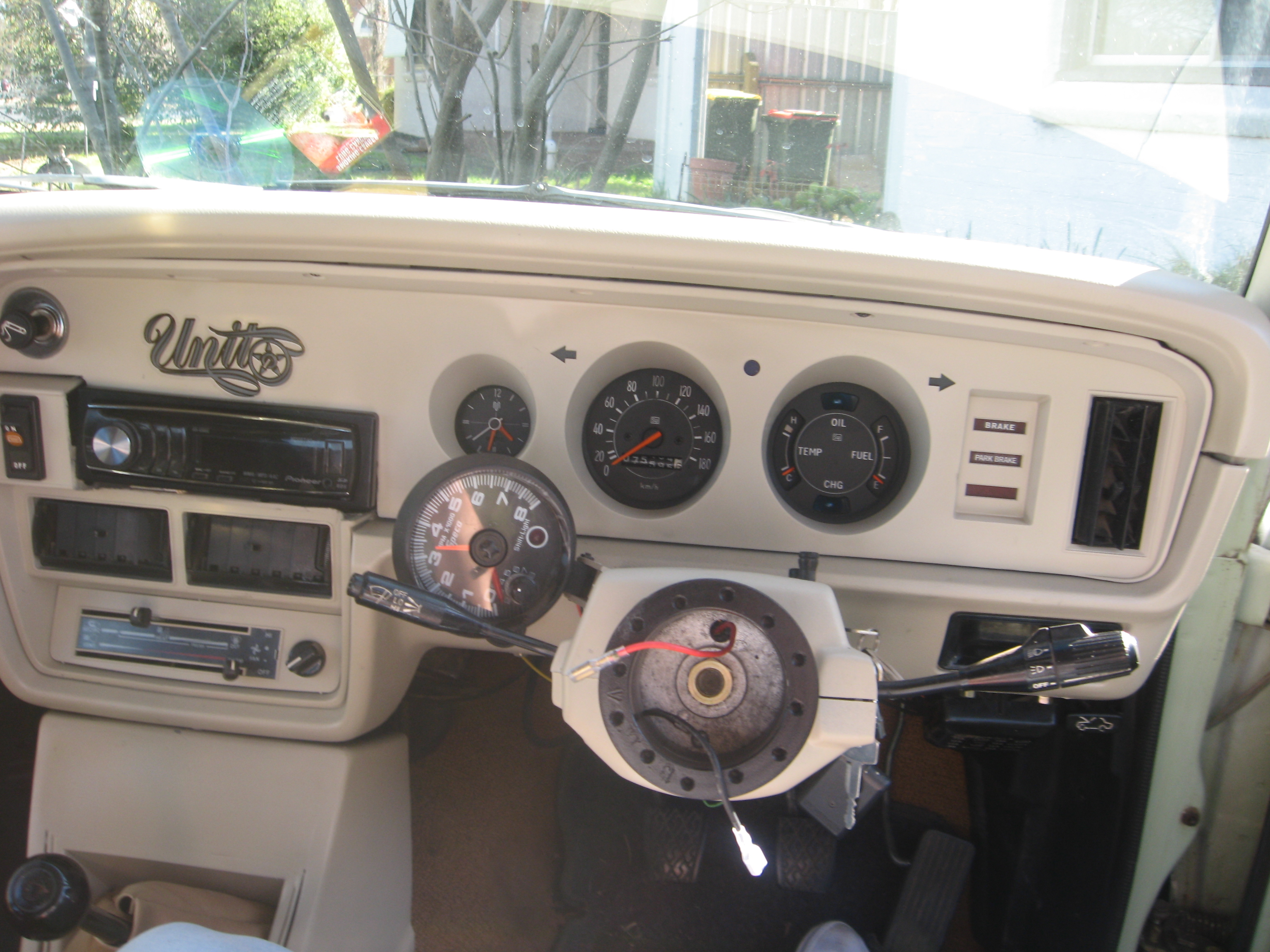

make sure you prepsol/wax and grease remove the surface REALLY REALLY GOOD.. i have done it before and didnt prep it properly.. within a week the 4 cans of $30 vinyl dye went to waste cause it started flaking off..
this is because the vinyl treatment stuff people use are silicon based and paint really doesnt like to adhere to it.
Link to comment
Share on other sites
I rubbed my rear door cards over with thinners and then used black vynal spray, Came up pretty well!
But it sticks like arse when you're spraying it! So avoid spraying bits inside the car and you wont have to burst out of the car gasping for air like i did :lolcry:
