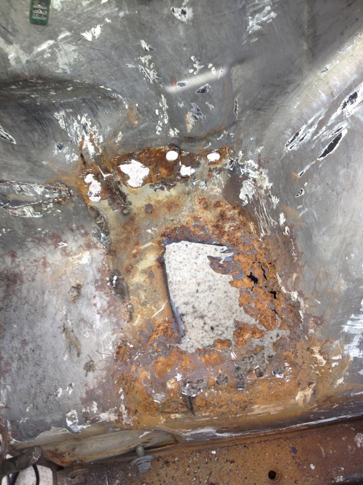

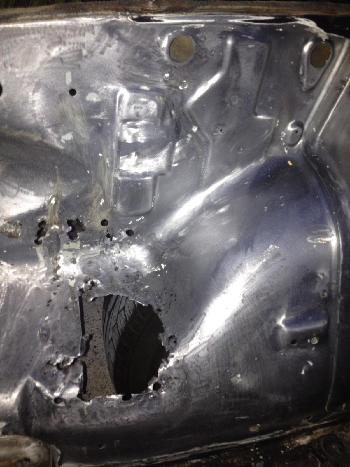

flawless-paint Posted October 25, 2012 Author Report Share Posted October 25, 2012 massive hole in the engine bay under battery tray gotta weld it up this weekend..... Quote Link to comment Share on other sites More sharing options...

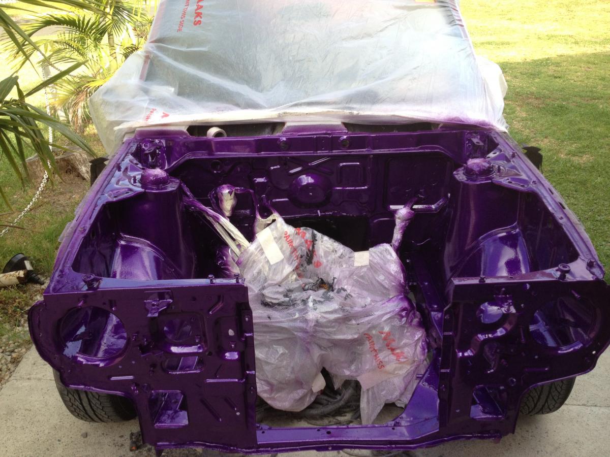

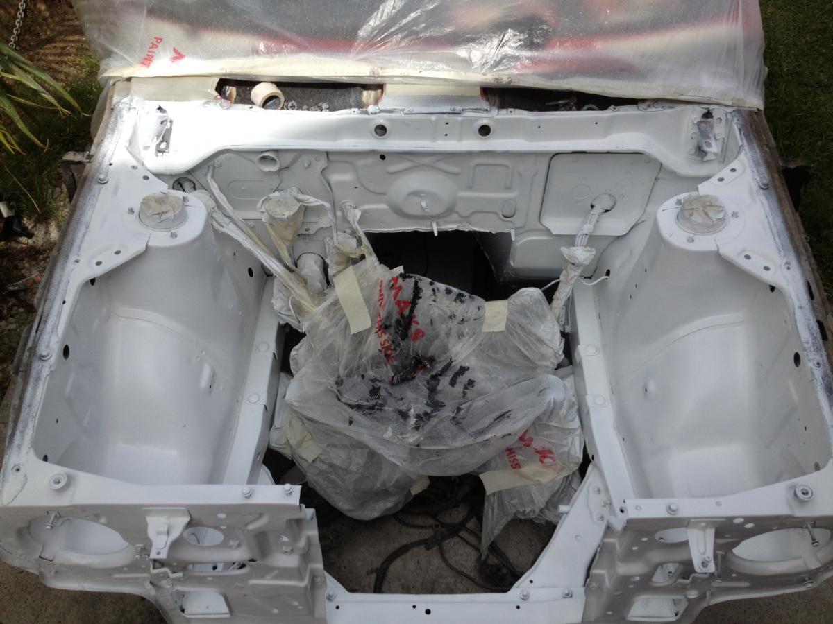

flawless-paint Posted October 28, 2012 Author Report Share Posted October 28, 2012 bays all painted ... got my hubs brand new from toyota.... Quote Link to comment Share on other sites More sharing options...
Crostek Posted October 28, 2012 Report Share Posted October 28, 2012 Hi Looking good, what did you use to strip back the engine bay? Quote Link to comment Share on other sites More sharing options...
flawless-paint Posted October 28, 2012 Author Report Share Posted October 28, 2012 paint striper and wire wheel .... was quite easy compared to some of the cars I've done Quote Link to comment Share on other sites More sharing options...

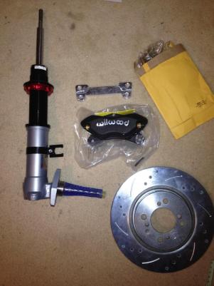

flawless-paint Posted October 28, 2012 Author Report Share Posted October 28, 2012 (edited) wilwoods came today :) Edited October 28, 2012 by flawless-paint Quote Link to comment Share on other sites More sharing options...

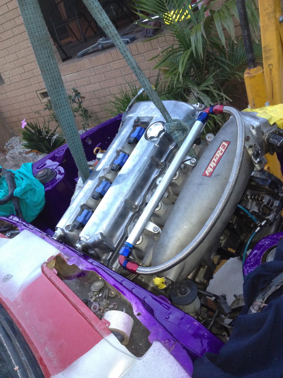

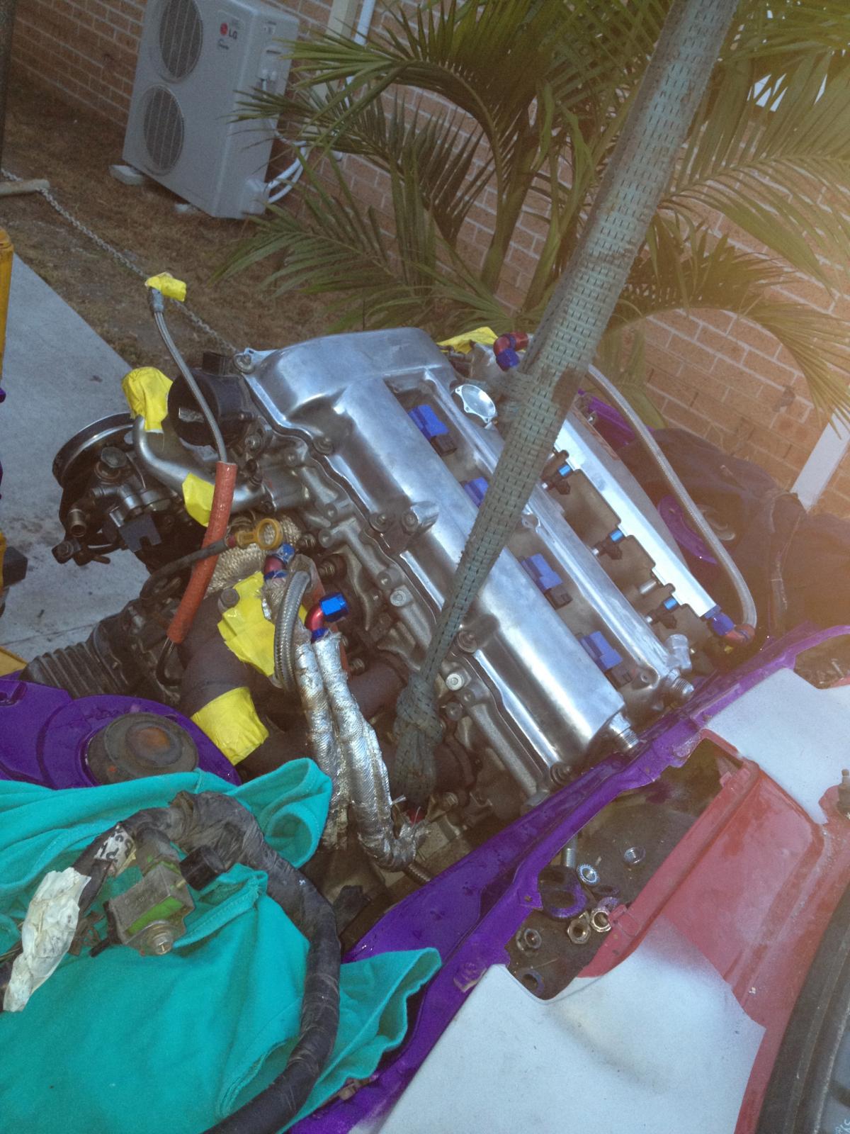

oh what a nissan feeling! Posted October 29, 2012 Report Share Posted October 29, 2012 (edited) wow, this is going to be a quick build, paint looks great. Â So the motor/ box being built atm, or ready to go? Â Just remembered looking at your pics, should have flattened that circular lump behind the engine, it pushes the motor forward a fair bit, would have been worthwhile. Edited October 29, 2012 by oh what a nissan feeling! Quote Link to comment Share on other sites More sharing options...
flawless-paint Posted October 29, 2012 Author Report Share Posted October 29, 2012 wow, this is going to be a quick build, paint looks great. Â So the motor/ box being built atm, or ready to go? Â Just remembered looking at your pics, should have flattened that circular lump behind the engine, it pushes the motor forward a fair bit, would have been worthwhile. Motor and box all ready to go trial fitting right now :) will post pics when finished Quote Link to comment Share on other sites More sharing options...
flawless-paint Posted October 29, 2012 Author Report Share Posted October 29, 2012 (edited) no go today... can see what u mean about the circular lump :( the motor won't get over the steering rack / crossmember.... going to try get a bigger jack tomorrow and slowly roll the gearbox and motor back at the same time over it so it goes in straight..... or..... anyone else got a better idea?????????? don't really want to have to unbolt the whole front suspension / cross member and try slot the car onto the motor and gearbox.... ill have to grind a new hole for the shifter and weld up the old one aswell heres how it sits till tomorrow Edited October 29, 2012 by flawless-paint Quote Link to comment Share on other sites More sharing options...
