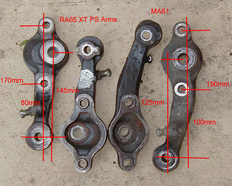

bruce Posted November 19, 2012 Report Share Posted November 19, 2012 (edited) G'day Banjo, did you get a camber measurement when everything was stock in the KE30? Not sure if it's zero or slightly positive: http://www.reocities...883/e3-sus.html With the KE30/KE55 struts having KPI measuring to be 9 deg. and the RA65 struts 8.4 deg., along with the same length LCAs, the resulting camber is quite close, or the RA65 struts would give slightly more camber, since it has 0.6 deg. less KPI. However due to the offset of the mounting hole for the lower ball joint in the steering arms between KE30/KE55 and RA65, the camber can be affected. I wonder what would be a nicer way: weld and redrill the mounting holes in the steering arms, or make new ones from scatch? Something like: https://technotoytun...les-ra64-celica Had any thoughts on the effect on bump steer with the RA65 struts and modifications to the steering arms?: http://www.rollaclub...3d-explanation/ http://www.toymods.org.au/forums/tech-conversions/40227-ae86-xe7x-ra40-60-struts-bump-steer-3d-explanation.html Edited November 19, 2012 by bruce Quote Link to comment Share on other sites More sharing options...

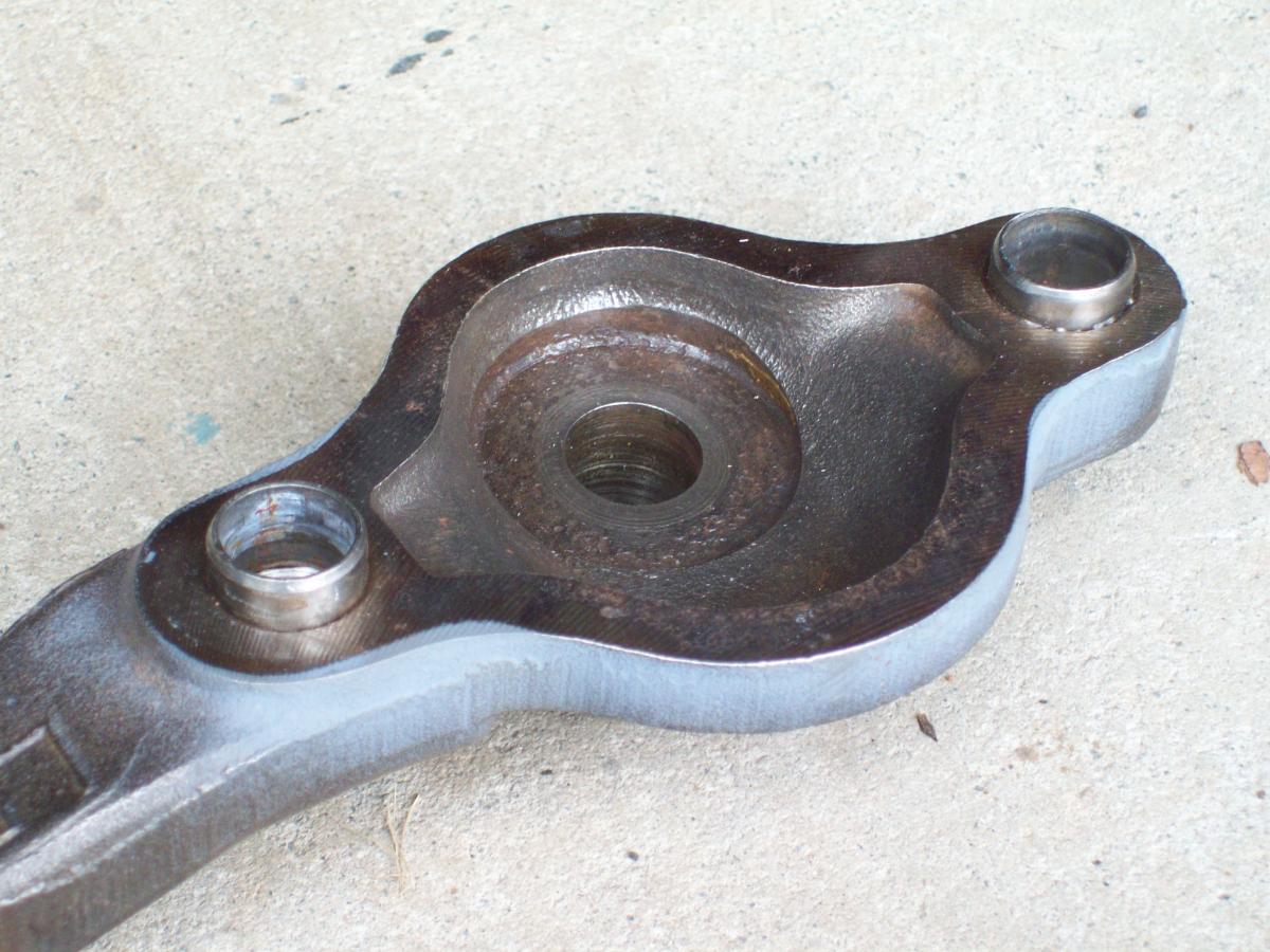

Banjo Posted November 25, 2012 Author Report Share Posted November 25, 2012 (edited) Finally got around this weekend to modifying the other KE30 steering arm so they would fit to the bottom of the RA65 struts. I ran into a slight problem, once the KE30 steering arm was attached to the lower ball joint, & I then I tried to attach the RA65 struts. The mating surfaces of the upper side of the steering arm, and lower end face of the struts would not come completely together. (gap of about 1 mm) This was because the tip of the ball joint threaded taper was touching the inside bottom of the strut. This is not an issue with the RA65 steering arms, (shown below) as they are deeper, & have a recess in them to accommodate the ball joint and retaining "castle" nut. I did find that not all lower ball joints are made equal. I have a couple of brand new brand "555" Japanese replacement ball joints to put in finally, and their threaded section & "castle" nuts are not as high. To quickly test, I ground the protruding section of the ball joint thread back to the top of a shallower nut. These ground ball joints will not be used again, so it didn't matter. With everything now in place, it was time to drop the donor car onto the dead level contrete floor & measure the camber. The results were dissappointing. My original calculations earlier in this post said I should finish up with about negative 0.6 deg camber each side. What I finished up with was negative 1.3 camber on one side, and positive 0.1 deg on the other. Now it might not be the same when I put these in the final KE30, but it goes to show the problem of camber in these early mass produced Corollas with no suspension adjustment facilities whatsoever. The major problem is that the two critical mounting points for the front suspension, being the inner LCA pivot point, & the top hat of the MacPherson strut are on two different parts of the car. The LCAs are connected to the cross member, whereas the top of the struts are connected to the body. I have often wondered how much 'sideways" movement is available in the cross member to the chassis, and may undo the four cross member to chassis mounting bolts, and try this next time I have an engine out. To my way of thinking, you could probably jig the car on a straightener in a body shop & then seam weld the car in the front area, but there is no guarantee that it would all come out straight, and the cost would be great. The idea of a triangular strut brace between strut towers & to the mid point of the firewall is looking like another cheaper option option. Something like this. I'll put the struts in the final KE30 car & see what camber result I come up with. I may then have to go to camber adjusters to get both sides equal. Any one got any ideas on the best KE camber adjusters available locally ? How many degrees of camber adjustment can you get out of these ? Cheers Banjo Edited November 25, 2012 by Banjo Quote Link to comment Share on other sites More sharing options...
