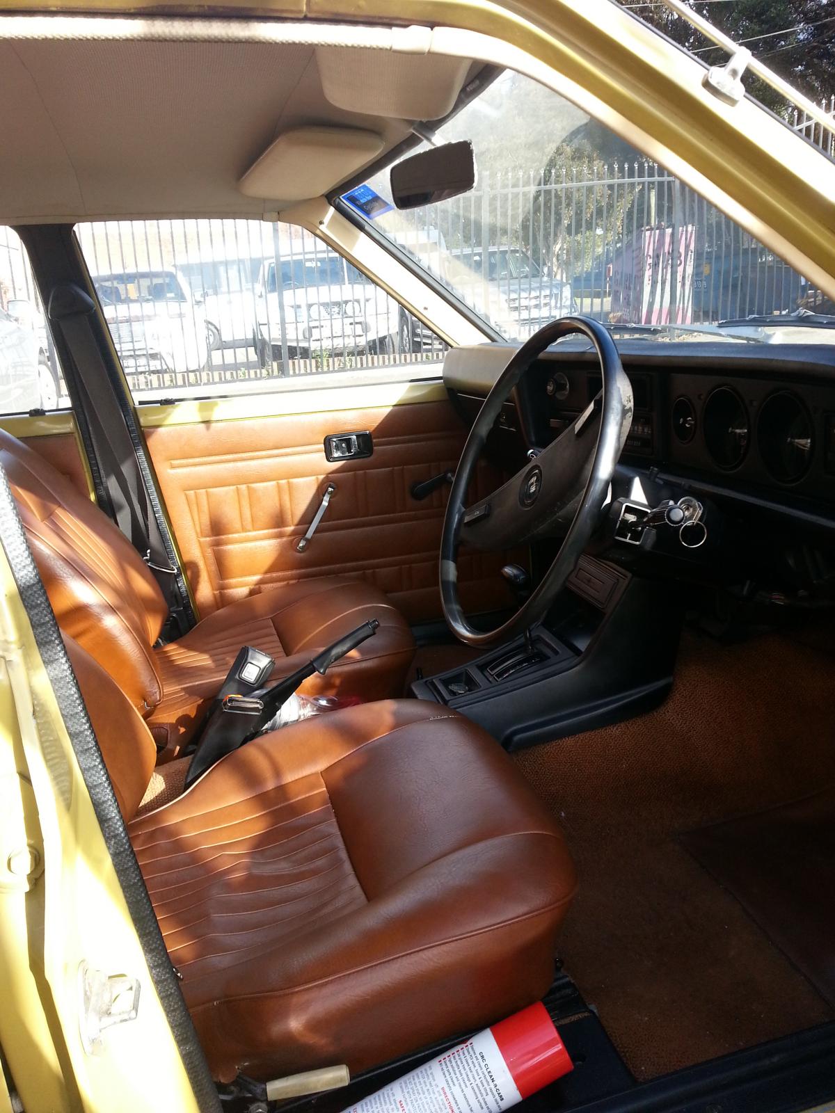

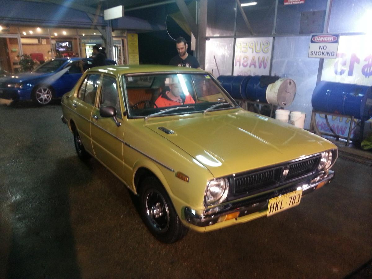

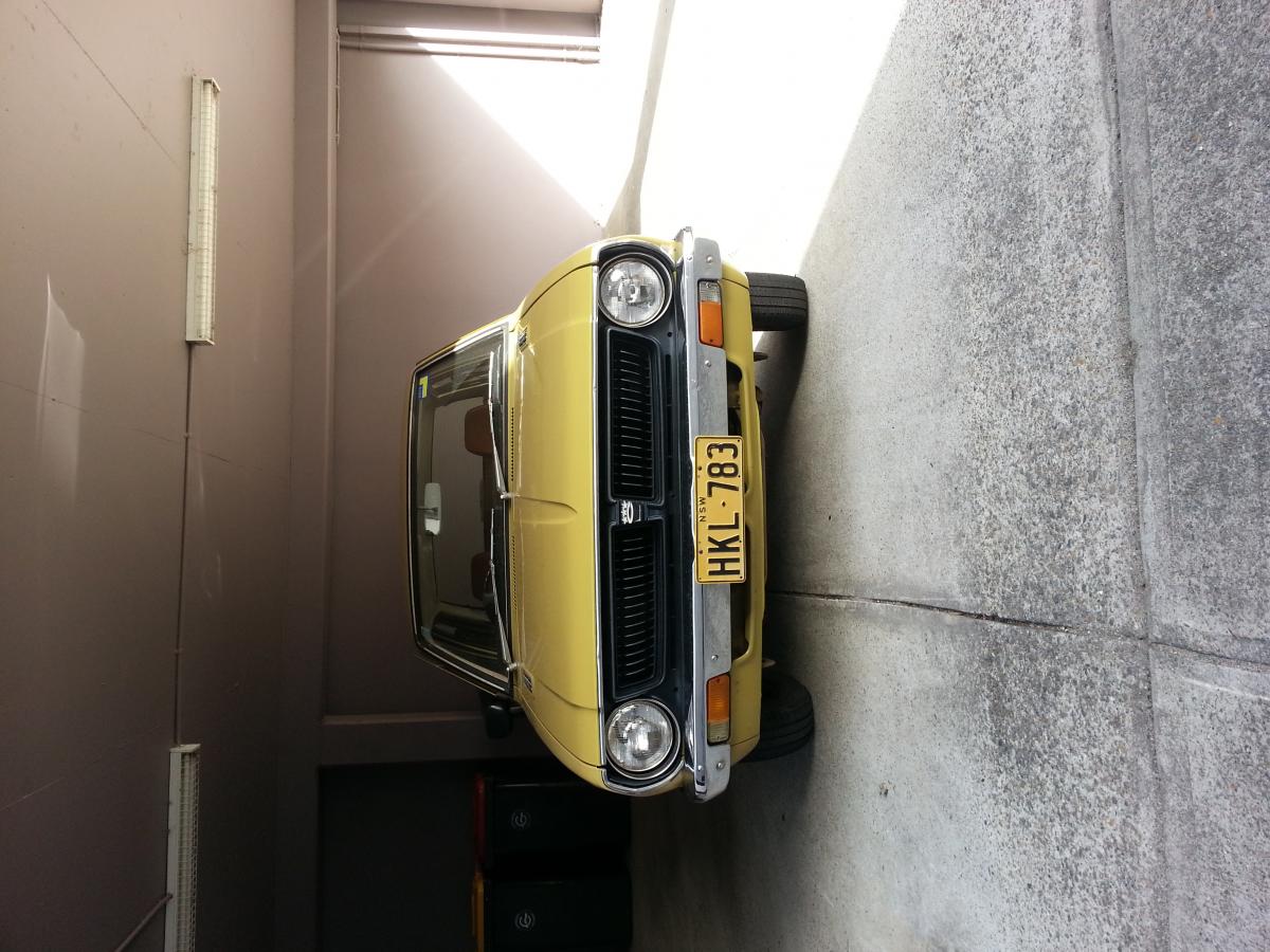

Souli Posted November 21, 2012 Report Share Posted November 21, 2012 Hi Guys, New member so forgive any rookie mistakes. finally getting started on converting my 75' KE30 into a jap spec S15 6SPD MANUAL SR20 turbo. i know this gets asked alot although i will ask again. i need a few tips on what diff to get and at what ratio best suits an everyday driver. keep hearing hilux hilux etc, although i am open to other alternatives. also with brakes- what would best suit a project like this. i am lucky to have access to an uncles mechanic where we will be doin the job ourselves. but jus curious to see what would be my best option in regards to the above mentioned. although its not super cheap doing this sort of conversion, I'm not goin all out either in regards to top of the range bits n bobs. but for the important stuff like diffs brakes n exhaust where the money has to be spent I'm all ears. ive attached some pics of the little beast as she is now. ill be posting pics of the progress as we go.. cheers! new guy! Quote Link to comment Share on other sites More sharing options...

oh what a nissan feeling! Posted November 21, 2012 Report Share Posted November 21, 2012 (edited) Nice starting point there, the interior looks good. Edited November 21, 2012 by oh what a nissan feeling! Quote Link to comment Share on other sites More sharing options...
