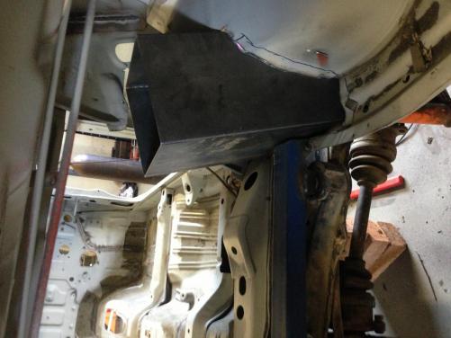

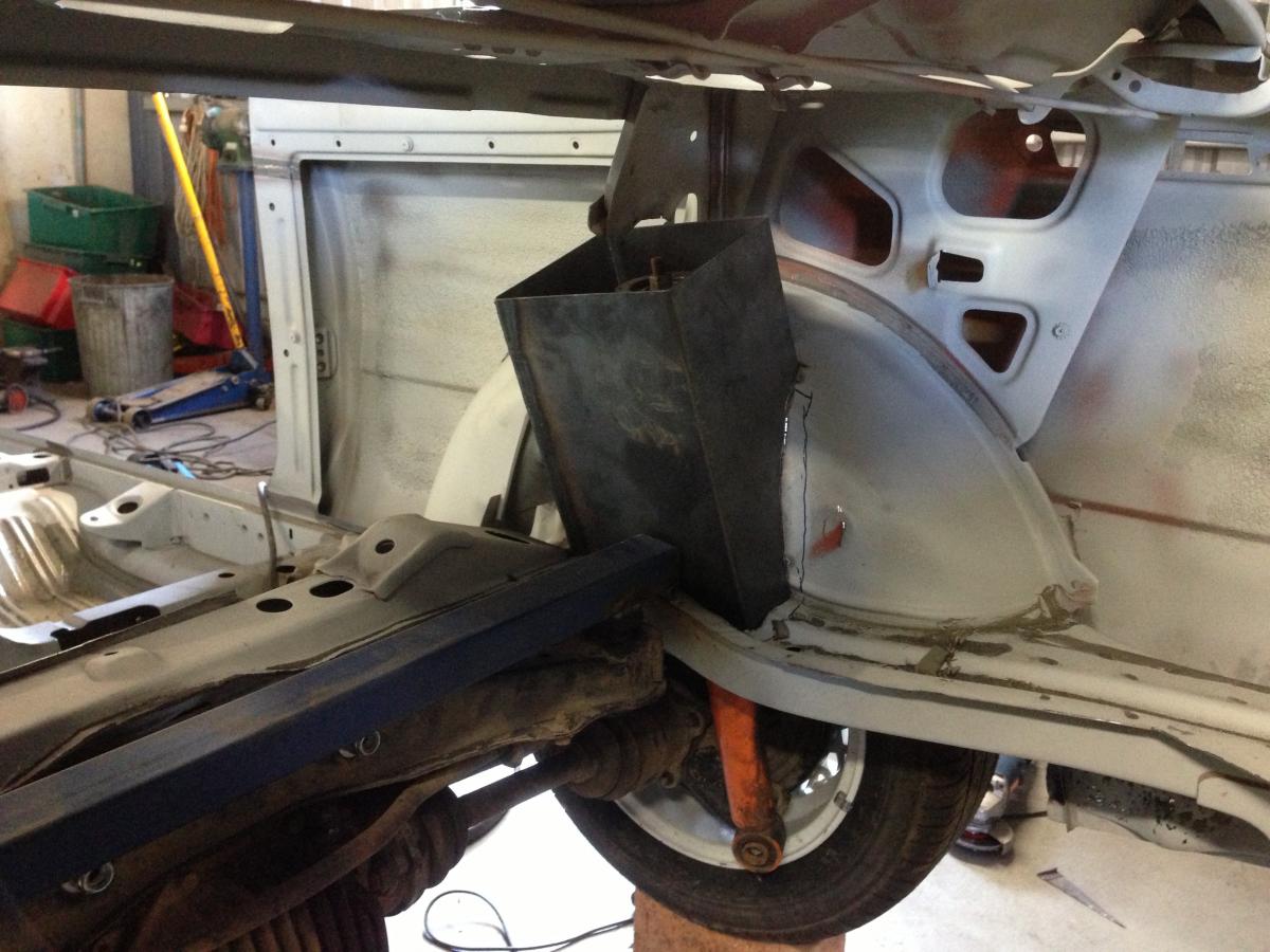

Tough_little_ke20 Posted January 14, 2014 Author Report Share Posted January 14, 2014 I feel like I've been saying for a very long time that I'm about to make the rear towers and get the car back on the ground, well I'm finally doing it, I have no goal date to have the car finished so if I can't be bothered working on it I don't that also means I can take the time to do thing how I want and not rush it. So today of all days when I finished work it was 47° so I thought sure ill go work on the rolla, now I have one side chopped out roughly so I could put the strut in and measure up for the towers, I'll fold up the towers in the next couple of days hopefully, then ill weld them up and fabricate then into the car. Hopefully after that I can turn the car upside down for the last time and clean up all the bits of metal that don't need to be there, fill in all the holes, seem weld whats left and weld in some mounts for a tail shaft loop then paint the underside and the rear end, reassemble and pack away the rotisery Quote Link to comment Share on other sites More sharing options...

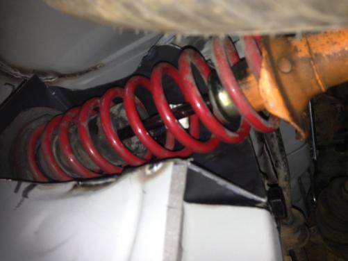

supra2 Posted January 15, 2014 Report Share Posted January 15, 2014 Hi Justin. Something to check which Ive overlooked and may cause a clearance issue depending on offset. As you know the irs has a lot of camber gain and they only have a shock as standard. Iam findind the tyre may foul the coil spring on full bump as the camber changes but wont know untill I get some weight on it. Ive allready moved the lower mount inboard but it still might not be enough. Just a heads up before you weld in your new towers. Quote Link to comment Share on other sites More sharing options...

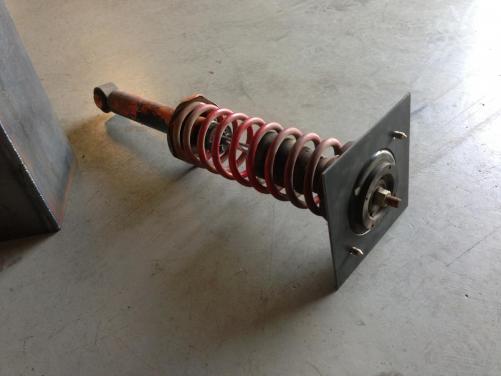

Tough_little_ke20 Posted January 15, 2014 Author Report Share Posted January 15, 2014 Cheers Craig, I never thought about the camber bringing the tyre closer to the strut, but mine is going on the original mount which has some angle on it that allows the strut to stay on the same angle while the arm gains camber, this means the strut goes through the side of the wheel arch and not out the top, so the tyre would hit the inner guard before the strut (hopefully) plus ill be machining up a bolt on spacer to change the stud pattern from 4 to 5 which will sit the wheel out another 20-25mm Quote Link to comment Share on other sites More sharing options...

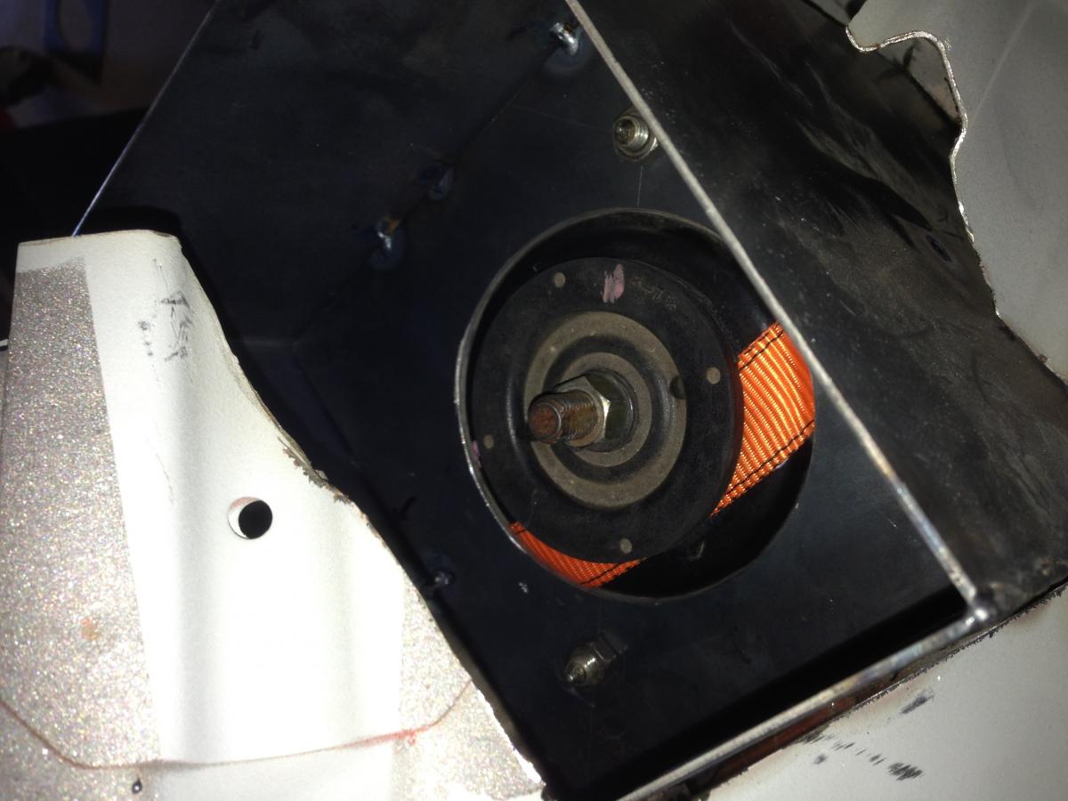

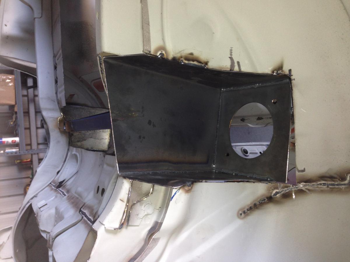

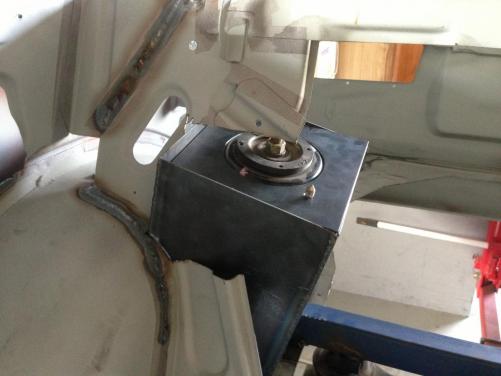

Tough_little_ke20 Posted February 3, 2014 Author Report Share Posted February 3, 2014 The extreme heat over the last few weeks (mid 40's) took away my motivation but I decided to get back into it on Sunday. So I made up both rear towers in the form of pressed sheet metal box section, and test fitted one side, trimmed and tacked it in place, today I made the tops for the towers, and if the weather is alright tomorrow after work I'll work out the tower height, pull the tower out trim the tower to length and weld the cap on the put the tower back in. Hopefully all goes to plan Quote Link to comment Share on other sites More sharing options...
Tough_little_ke20 Posted February 4, 2014 Author Report Share Posted February 4, 2014 I'm very happy with tonight's progress, got both towers tacked in place with the tops welded on and the wheels now hang all by themselves, now I need to fully weld the towers in, make a few gussets, sheet off the holes and finish seam welding then the rear is done ???? Quote Link to comment Share on other sites More sharing options...

Tough_little_ke20 Posted February 20, 2014 Author Report Share Posted February 20, 2014 Just about finished welding the towers in, will finish them off tonight then onto the floor work Quote Link to comment Share on other sites More sharing options...
Tough_little_ke20 Posted February 23, 2014 Author Report Share Posted February 23, 2014 Got the first sheet welded in today so that means the work on the rear end is done, just the tidy up jobs to do, gettin close now Quote Link to comment Share on other sites More sharing options...
