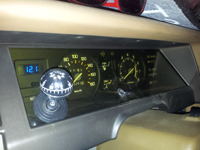

Was it difficult to fit the tacho? I have a similar issue, KE70 dash and a donor AE82 twin cam, so I might do this conversion :)
Difficult is a tough description... in reality... no, but it did take all kinds of changes... and it took destroying the E7 tach assembly for parts to allow the newer tach to fit. BUT no re-wiring was required. **IF** you want, I can also do the swap for a small fee ($50 US)
Since my friend has sent me the zenki cluster I've been debating re wiring that one as well... If I do the job again, I'd be happy to document it. In the mean time I did modify the AE82 tach face to fit inside the zenki cluster....
