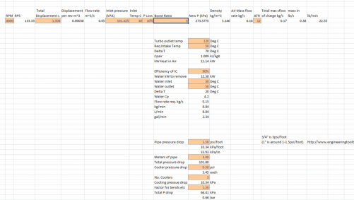

Just Throwing Some Fi Ideas Around
ATOYOTA
With just the 2 pulley's acting as a overdrive for the turbo compressor you would not get enough RPM from just the pulley's to get the turbo to start to work, as the turbo needs to be around 60,000 plus RPM to make boost & a lot will run up to 100,000 RPM ..
Even at 10 -1 gearing as an example & say the Engine is doing 2,000 RPM the turbo will only be at 20,000 & If the turbo is selected well it should be just on making some boost by itself then any way with out any other external driving force ..

I guess I'm pretty biased against turbos because every setup I've ever seen/driven was laggy as hell because the owners just couldn't resist that massive top end rush. The picture was just to illustrate my thoughts. In reality I know there would have to be some crazy gearing to get it to spin fast enough off the crank.
