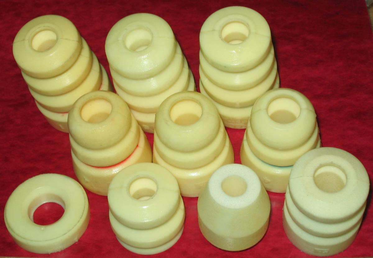

altezzaclub Posted December 30, 2016 Report Share Posted December 30, 2016 I wander around a wreckers yard for bump stops. There is an MX5 site that gets right into custom bump stops and their effects, it is quite fascinating. The Celica we rallied had Falcon front ones fitted in the rear... Longer and softer than stock, so they started to add to the spring rate earlier and then had time to decelerate the chassis before full compression. Quote Link to comment Share on other sites More sharing options...
ke70dave Posted December 30, 2016 Report Share Posted December 30, 2016 You can just cut ke70 bump stops with a hacksaw. Quote Link to comment Share on other sites More sharing options...

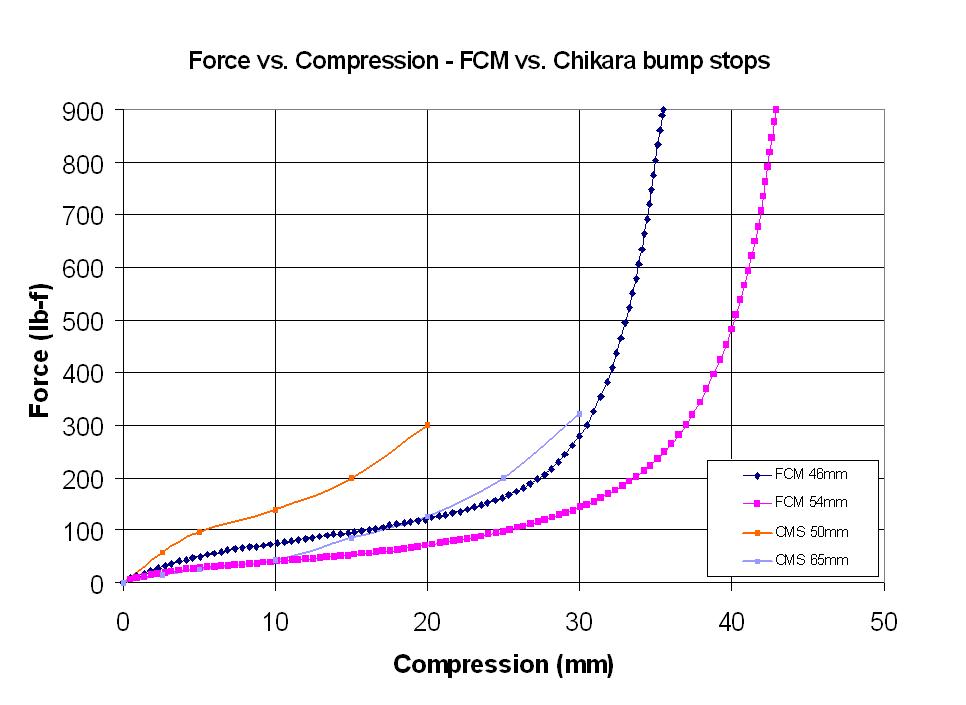

altezzaclub Posted December 30, 2016 Report Share Posted December 30, 2016 FatCatMotorsports are talked about a lot for gymkhana/autocross work with their progressive bumpstops. This sort of thing- https://forum.miata....ad.php?t=401320 They look like this- and work as part of the suspension setup like this- See what you can find... Quote Link to comment Share on other sites More sharing options...
