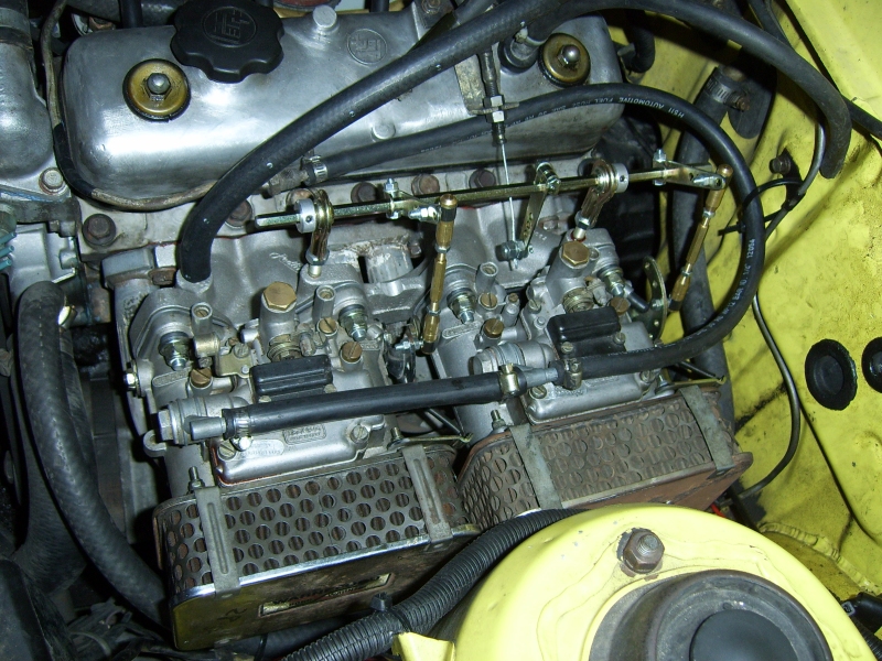

Picked up the Dellortos this morning, $80 to get the softmounts, Studs, Bolts, Fix up the balance linkage and new fuel line..
Just need to save to get the linkage kit/filters and some other stuff now..

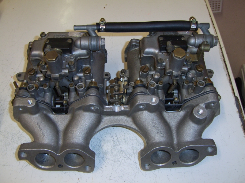

He gave me a list of the components/jets inside.
Chokes - 32
Main - 145
Emuls. 7772.1
Air - 210
Idle - 55
Pump - 35
Finally the Dellortos fitted - $345 all up.
Machine up of the manifold to fit, Hoses, Linkage kit, Accelerator cable, Manifold gasket and a rough balance and tune.
He said to drive it for a while because the carbs have been sitting for so long. After some decent drives everything should begin to settle in/free up. He also said the fuel wasn't burning the best and that the plugs may be shot from the other carby. Drove it home from work and to me it seems fine.
