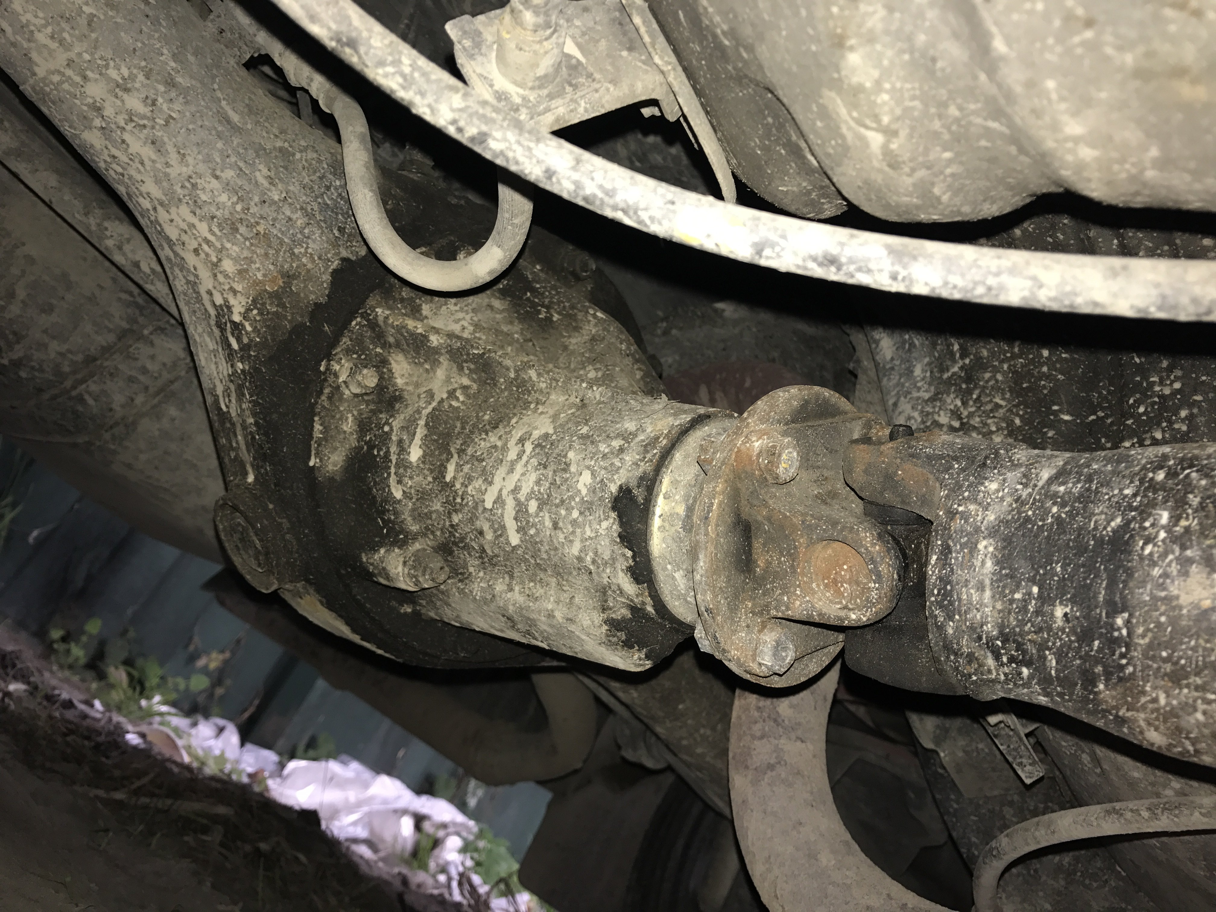

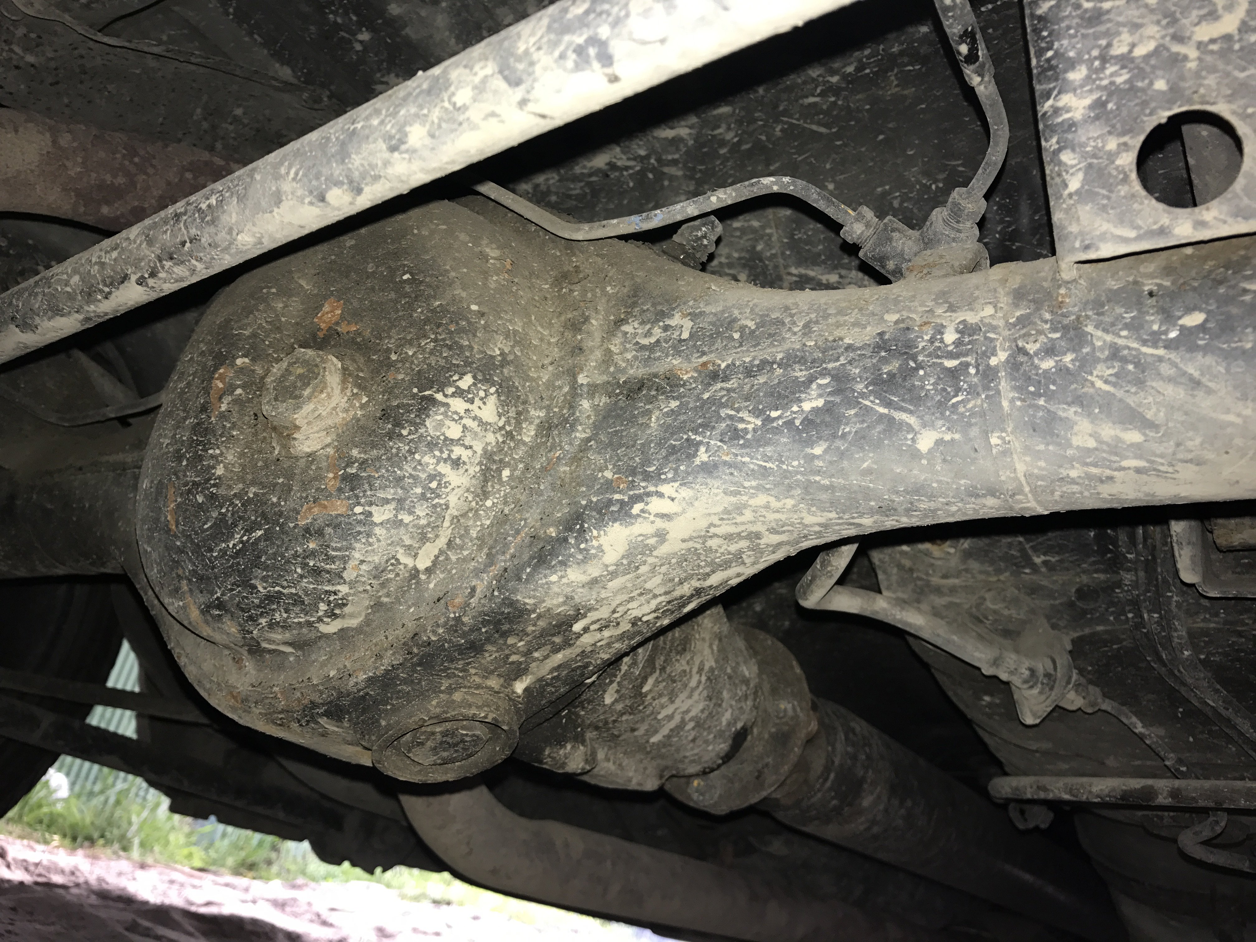

Ae70lowlife 0 Report post Posted May 16, 2017 Sorry I'm not a Toyota expert so I brought this hoping to learn more so I'm not sure what those diff look like so could you tell me what one this one is? Share this post Link to post Share on other sites

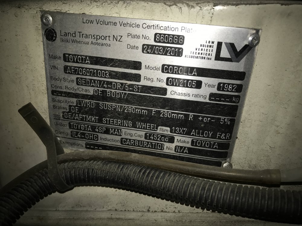

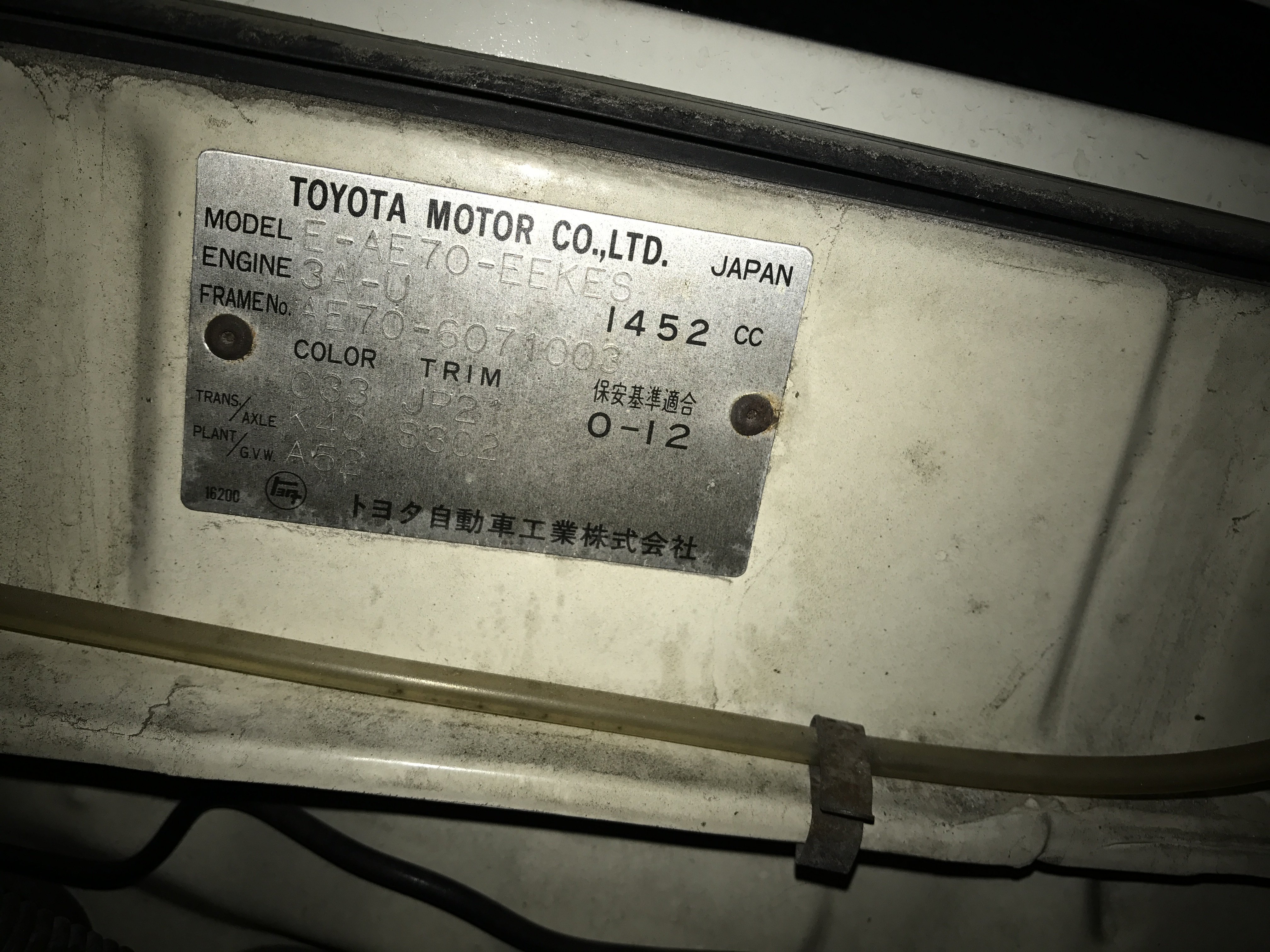

ke70dave 232 Report post Posted May 16, 2017 Assuming it is standard I reckon it is either an S series differential or a T series differential. Its definitely not a borgwarner diff. An S series will have 8 bolts holding the diff housing onto the axle housing, a T series will have 10 bolts holding the diff housing to the axle housing. The bolts i'm referring to are quite difficult to see in your photo i think there are 8? Though being overseas it could be anything.....can we get a photo of your built plate on the firewall of the car? this will say what diff it is also, assuming it hasn't been changed. Share this post Link to post Share on other sites
LittleRedSpirit 121 Report post Posted May 17, 2017 Looks S series to me, but pray for T. Count the bolts! Share this post Link to post Share on other sites

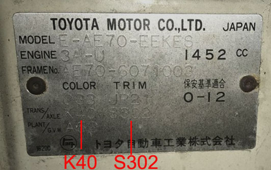

Ae70lowlife 0 Report post Posted May 18, 2017 Here's the plates in the engine bay I think it an a s series one though Share this post Link to post Share on other sites
