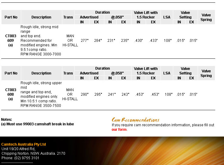

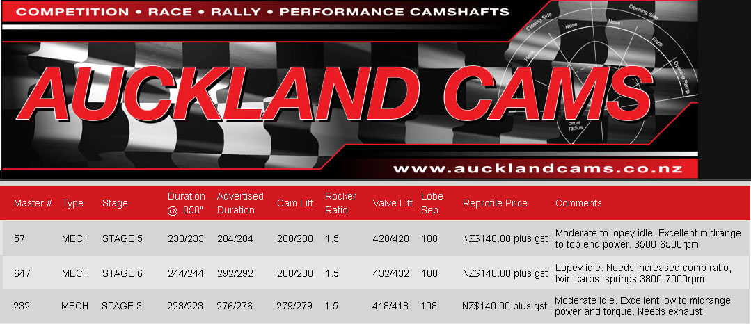

7000rpm Posted May 15, 2017 Report Share Posted May 15, 2017 (edited) Welcome Ben, I sent my cam to new zealand for regrinding http://www.aucklandcams.co.nz/cam_listings.php?title=TOYOTA 3K-4K In Nsw there are these guys http://www.camtechcams.com.au/toy_4cyl_3k4k.html There are others in aust that I am sure the guys will reply with. I suggest you get your lifters resurfaced at the same time, and dizzy regraphed if they offer the service. Edited May 15, 2017 by 7000rpm 1 Quote Link to comment Share on other sites More sharing options...
Ben carne Posted May 15, 2017 Author Report Share Posted May 15, 2017 Ok mate cool I seen this page online what stage did you go with and if you don't mind me asking what am looking at paying Quote Link to comment Share on other sites More sharing options...
7000rpm Posted May 15, 2017 Report Share Posted May 15, 2017 I went auckland 873, quite an agressive grind. Budget about $300ish from memory, plus $88 for lifters May I suggest you increase the compression ratio while you're at it. Might only be a small ratio increase if keeping the stock carb (to avoid detonation),though every bit helps. Quote Link to comment Share on other sites More sharing options...

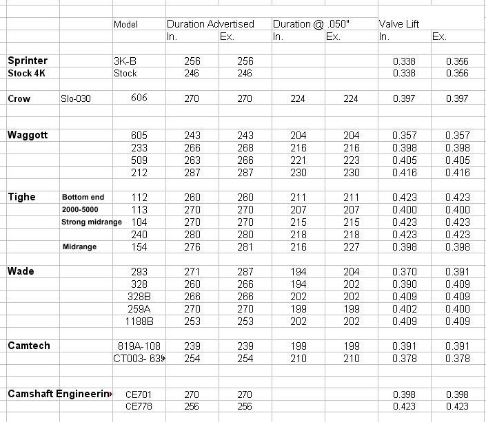

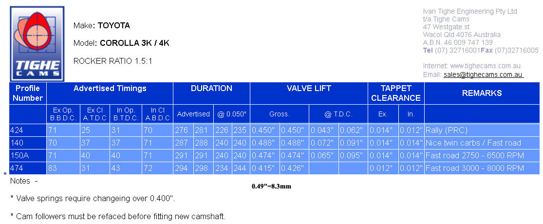

altezzaclub Posted May 15, 2017 Report Share Posted May 15, 2017 I ended up with a Crow that gave the fastest opening, the greatest lift at 50thou without having to change valve springs by going over 0.4" total. Cost $170 incl followers. I'd say 270-280 advertised degrees would run with a stock carb, but bigger cams are wasted without twin DCOEs. Quote Link to comment Share on other sites More sharing options...

altezzaclub Posted May 16, 2017 Report Share Posted May 16, 2017 Twin SU carbs- The usual extractors, inch & 3/4 exhaust, skimmed head, the Crow 606 cam. Keeps up with the traffic, but nothing like its stablemate with a 4AGE. build is here- Quote Link to comment Share on other sites More sharing options...

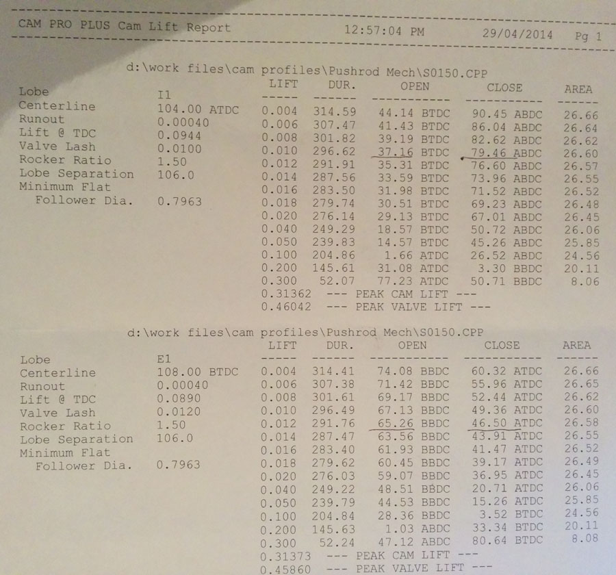

joshua.mathews Posted May 17, 2017 Report Share Posted May 17, 2017 I'm running a 265 269 104 cam custom grind Running a 32/36 webber 10.6.1 comp Electronic disturtor Quote Link to comment Share on other sites More sharing options...
7000rpm Posted May 17, 2017 Report Share Posted May 17, 2017 Hey Josh is that advertised duration or at .050? Quote Link to comment Share on other sites More sharing options...
joshua.mathews Posted May 18, 2017 Report Share Posted May 18, 2017 Thats at the lode Quote Link to comment Share on other sites More sharing options...
altezzaclub Posted May 18, 2017 Report Share Posted May 18, 2017 Quote With the twin Su carb mate what else did you need to modify IE cable ect Yes- check out the build thread, I made mounts for the cable, had an airbox made, bought a twin cable choke cable, lots of little things... SUs are fun, but old carbs nowadays. I'd use bike quads if I was to do it again in a serious way. Another option would be a single DCOE Weber, a great setup but the manifold is expensive. Twin Webers are not worth it for road use I reckon. Quote Link to comment Share on other sites More sharing options...

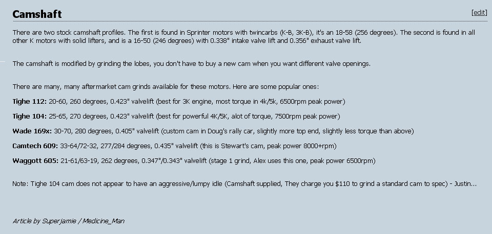

Medicine_Man Posted May 28, 2017 Report Share Posted May 28, 2017 My old 4K in my KE70 had the tighe 104 grind, was very nice to drive! Quote Link to comment Share on other sites More sharing options...
