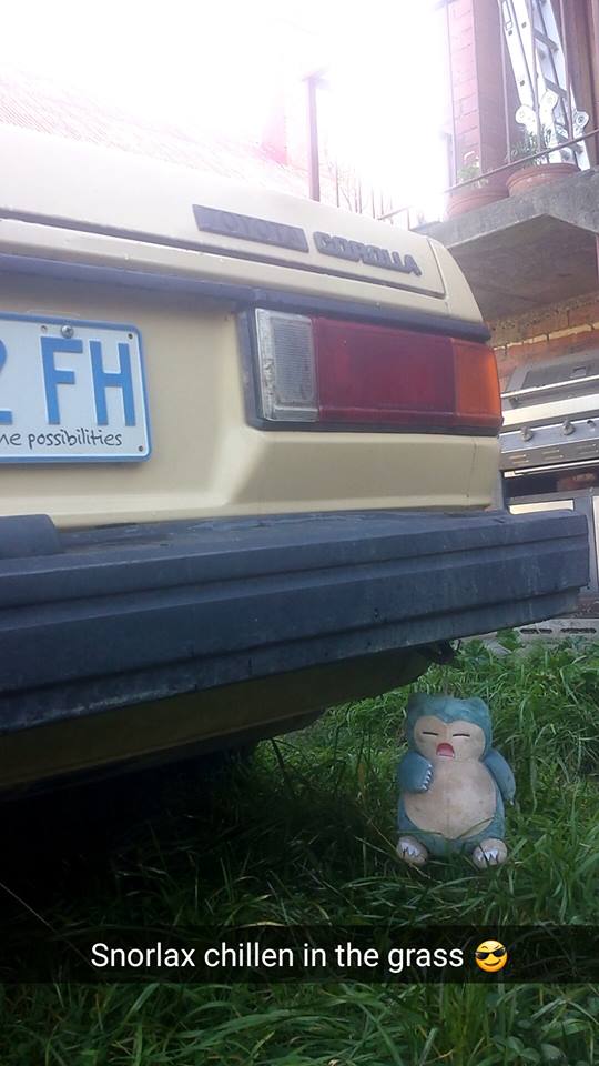

Hey everyone, i have just got myself a 1982 Ke70 toyota corolla CS it has a 4k, also has a ae86 front end and ae86 rear springs and diff has been welded, pretty sure everything else is stock was just looking for a few more power/jdm mods i could do if anyone knew of any from more power to style18685255_1907141732890892_1596096548_n.jpg.e32d79006eb3124c610fb2bfe94beb5a.jpg

Throw away the diff...  just a terrible idea!  otherwise the car looks great, and the AE86 bits are a bonus!

For style, anything goes.. I like the "quad headlight/chrome bumper on 6x13" rims"  look, but whatever you prefer is the way to go.
