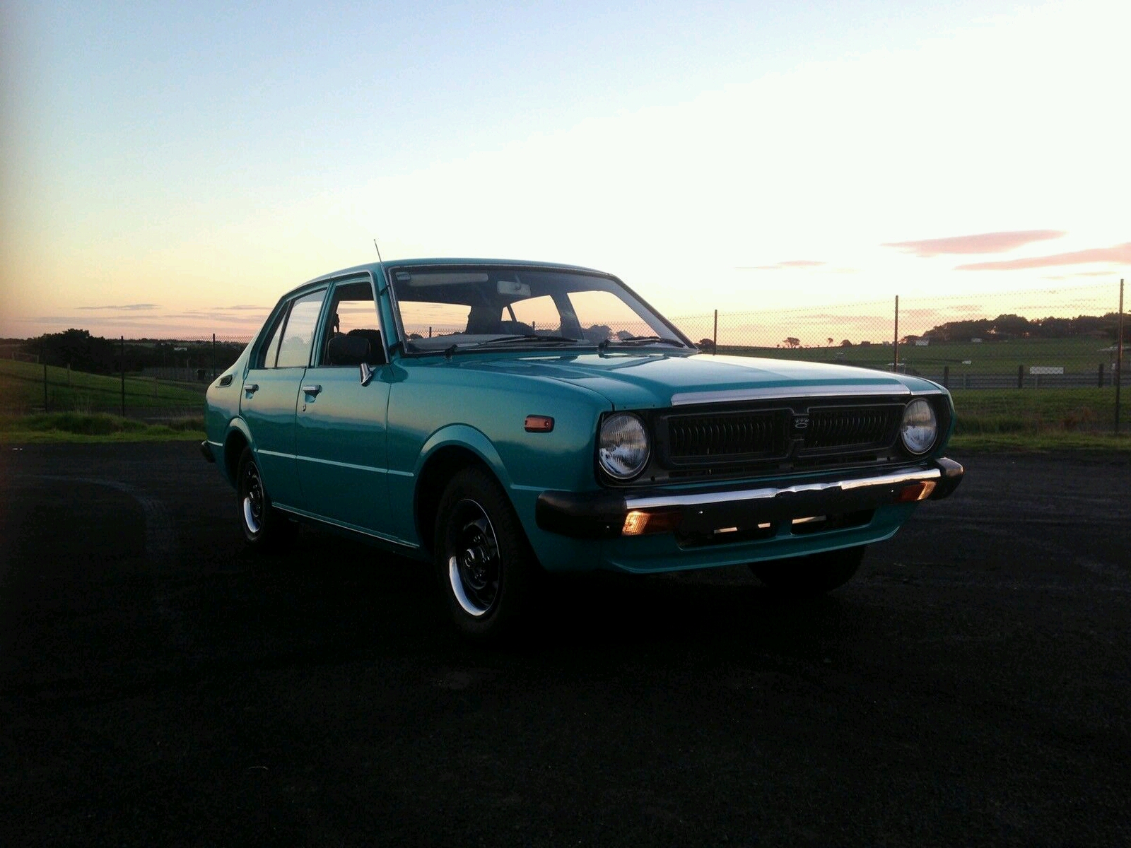

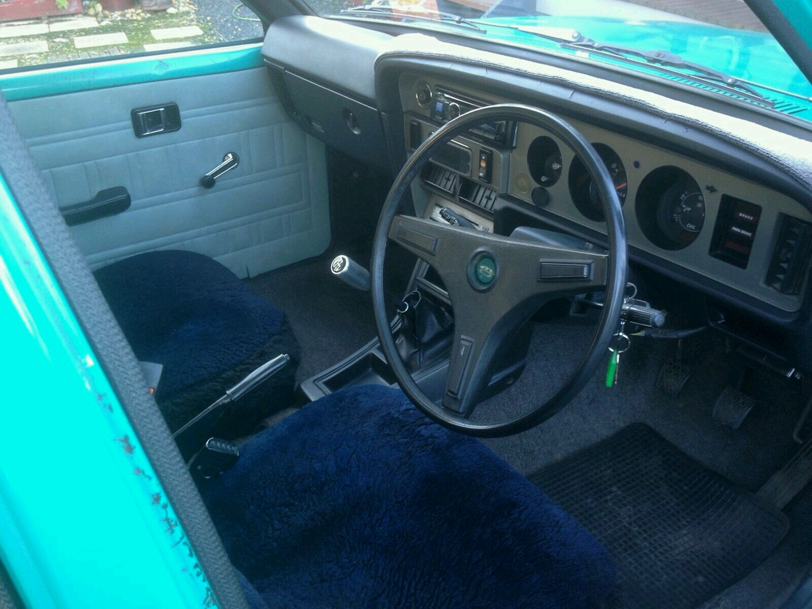

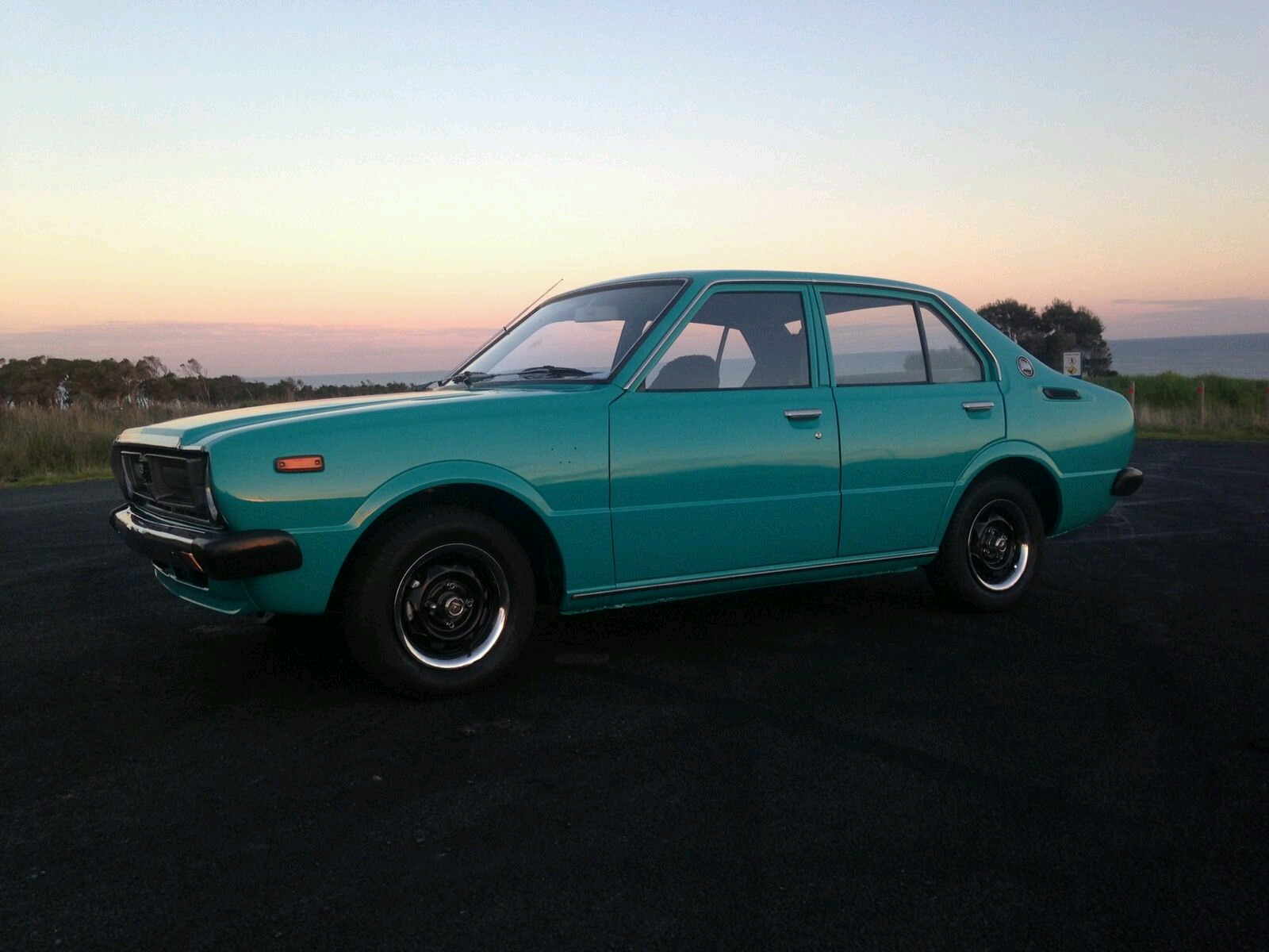

Wingsforwheels Posted October 18, 2017 Author Report Share Posted October 18, 2017 Quote You've got a 36 Y.O. Rolla with a Anti-Pollution tubing diagram on the inside of the bonnet, that you can still read ? This is some pristine Rolla ! Please post some pics here. Yeah she is pretty neat! Obviously some rust removal and a respray goes a long way. The last owner put these pics up on the sale ad, I'll have to take some of my own soon. Thanks for the advice guys. After half a can of carby cleaner and resetting the idle mix and speed screws, she's now idling steadily but backfiring a bit. When I spray some carb cleaner round the base of the carb the revs go up a bit, so I am thinking there is a crap gasket somewhere near there. Going to take out the carb and try to rebuild it hopefully this weekend, so fingers crossed. Quote Link to comment Share on other sites More sharing options...
