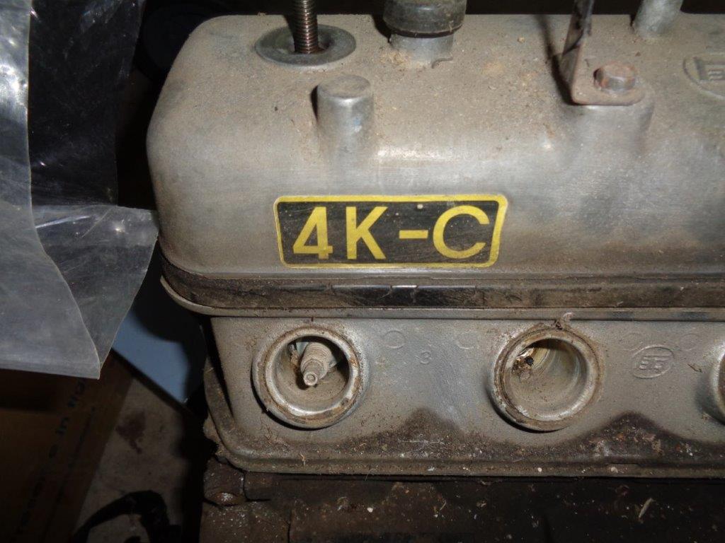

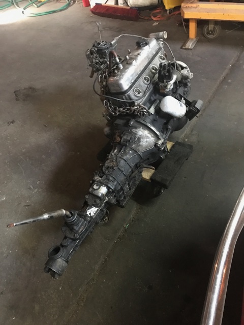

billyballer Posted January 26, 2018 Author Report Share Posted January 26, 2018 Banjo, Thanks for the warm welcome. The Engine is not in the car yet, but it is physically similar in size to the 1275 Sprite motor and also has the intake/exhaust on the same side. Bonus that the 4K is a slant 4 so it will clear the low hood on the Sprite. I'm using the gearbox that came with the motor which is a toyota 4 speed for now. May upgrade to a 5 speed at some point if it isn't too much hassle. The biggest issues with he swap will be a custom drive shaft (plenty of good shops who will do that for cheap here), building custom motor mounts, and adapting a transmission cross-member. I'm a decent welder so I'm not to worried about the mounts and cross member. I honestly would never have gone at this project but was given the car for free, and then the motor for free from another person. It's not a nice enough car to restore back to original so I figured I'd just play around and see if I could make a little budget driver. Sprites only weigh about 1600 lbs. soaking wet so should be good match for the 4K in terms of power. Maybe you can shed some light on what version 4K I have. The engine ID number (see picture) just says "4k" not "4K-C". It did not come with any fan, but I'm planning on running an electric fan setup. Take a peak at the pictures and see what you think. Sorry in advance the pictures aren't great and the 4K is shoved up against a 5.0L Ford motor which is destined for another project (yeah I'm that guy). Quote Link to comment Share on other sites More sharing options...
Banjo Posted January 26, 2018 Report Share Posted January 26, 2018 Hi Bill, Thanks for the pics. Gives us a clear idea. The letter after the 4K, never appears in the engine S/N on the block. It is usually on a sticker attached to the side of the rocker cover, just above no: 4 spark plug. From your pics, looks like that sticker has long since gone. I don't know if it is an optical illusion, but it appears that the point the gear stick comes out of the gearbox rear extension, is much further back than normal, for a 4 speed. Have you worked out where it will "appear" on the Healey's floor tunnel ? What is the measurement between the centre point of the gear stick pivot ball, to the front edge of the bell housing mating point to the block ? I'll go & measure a 4 speed box I've got on the garage floor, & post it here. Our 5 speed gearboxes, had the gear stick further back. The water pump pulley I have will fit your pump OK. I'll go & take a pic, & post here with hole dimensions. Can't imagine they would be different in the USA, but you never know. Cheers Banjo . Quote Link to comment Share on other sites More sharing options...
