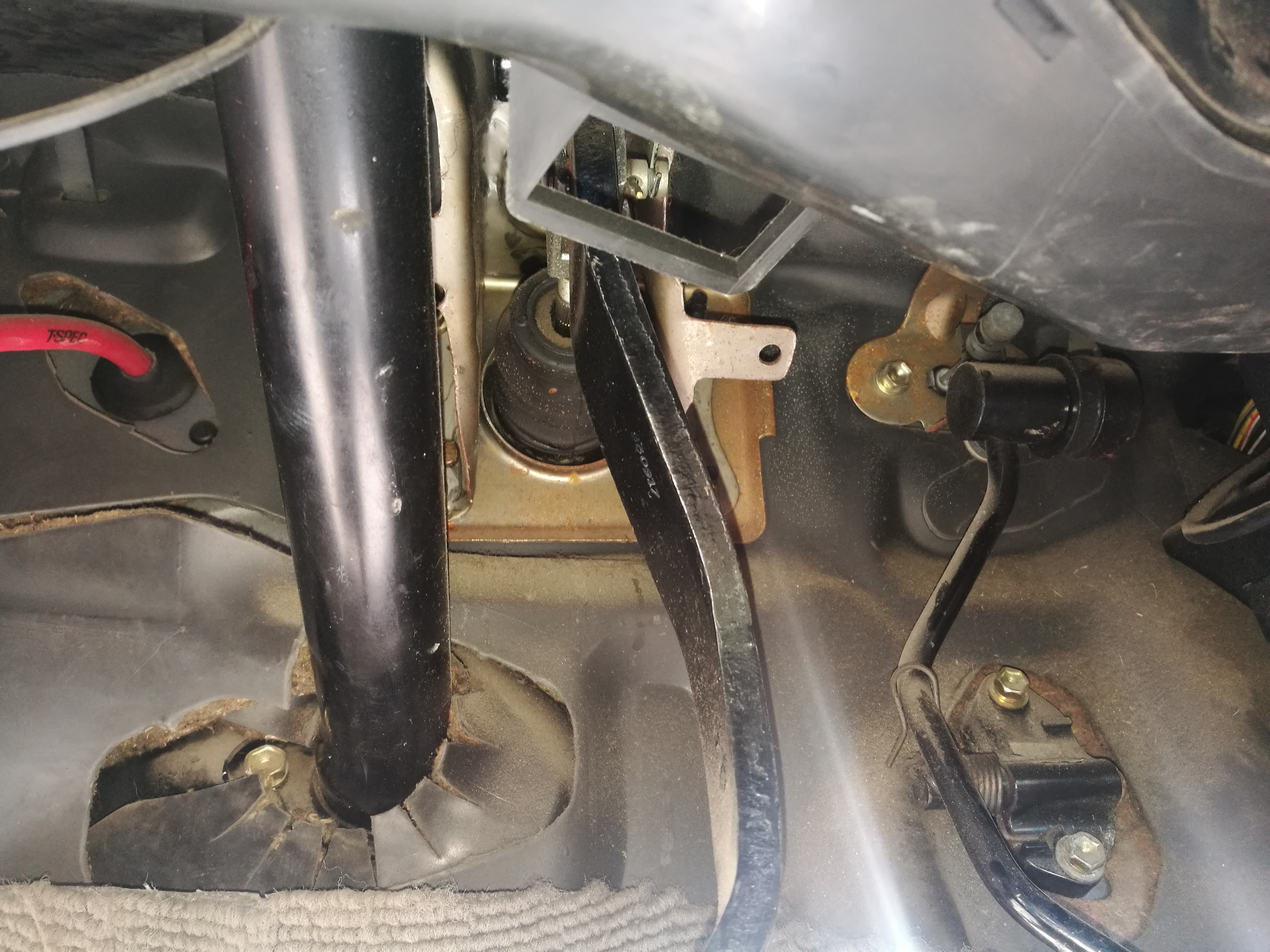

MrTougéTka Posted April 7, 2018 Author Report Share Posted April 7, 2018 Here's a picture of the current two pedal box, sorry its a bit dark. I was hoping a ke70 or even a Corona Pedal box would mount up with little modification. Kp60 definitely wouldn't work as the pedal arm for the clutch wouldn't clear the steering shaft from the wheel to the rack(unsure of what term to use here lol having a blank) Quote Link to comment Share on other sites More sharing options...

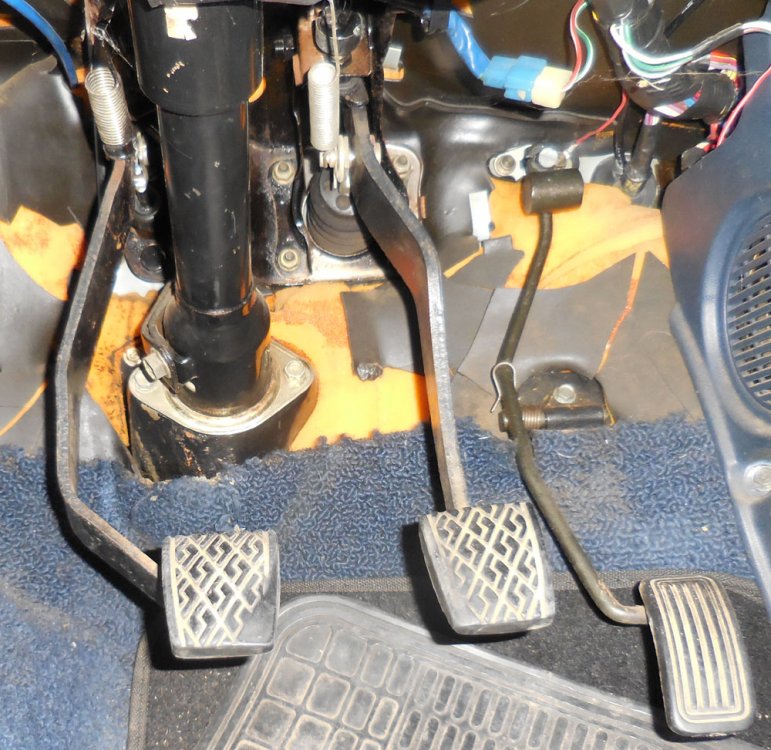

altezzaclub Posted April 8, 2018 Report Share Posted April 8, 2018 The KE70 just tacks a clutch onto the side of the brake pedal mounting, and the clutch pedal arm has a massive bow in it to get down past the steering just like the brake arm. Quote Link to comment Share on other sites More sharing options...

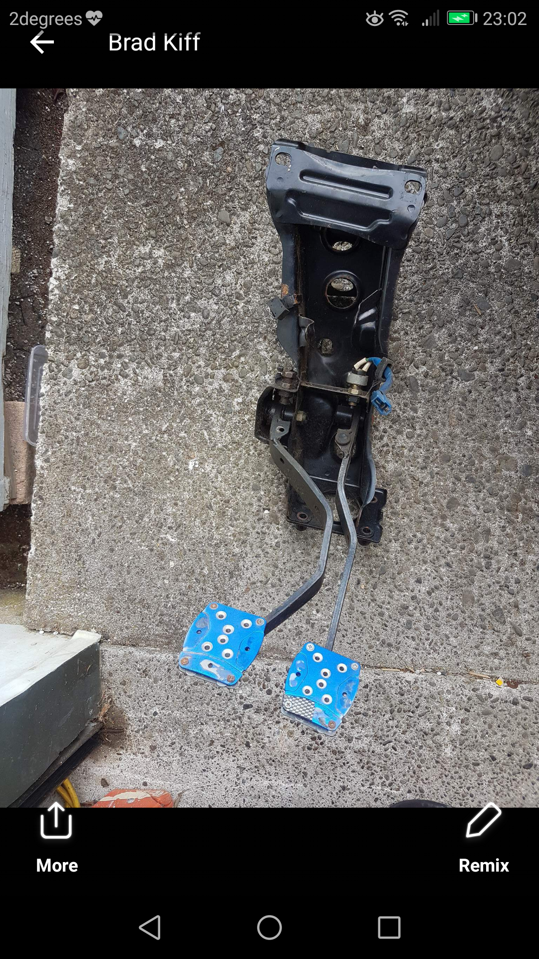

MrTougéTka Posted April 8, 2018 Author Report Share Posted April 8, 2018 2 minutes ago, MrTougéTka said: So you're saying a modded ke70 box would work? I'm just over thinking this probably, just need to get in there and buy one I got offered this for 10 bucks? Quote Link to comment Share on other sites More sharing options...
Jono.C Posted April 8, 2018 Report Share Posted April 8, 2018 You’ll probably need to pull it out for comparison to know what you’re looking at Aren’t the carina based on a corona platform so an st141/ rt142 pedalbox May be the closest? Although they are hydraulic. Quote Link to comment Share on other sites More sharing options...
MrTougéTka Posted April 8, 2018 Author Report Share Posted April 8, 2018 9 hours ago, Jono.C said: You’ll probably need to pull it out for comparison to know what you’re looking at Aren’t the carina based on a corona platform so an st141/ rt142 pedalbox May be the closest? Although they are hydraulic. Yeah thats what i reckon, or so I've heard. I'll get it legal before i rip it to bits, its going for a warrant this week so after that I'll rip the kent out! Quote Link to comment Share on other sites More sharing options...

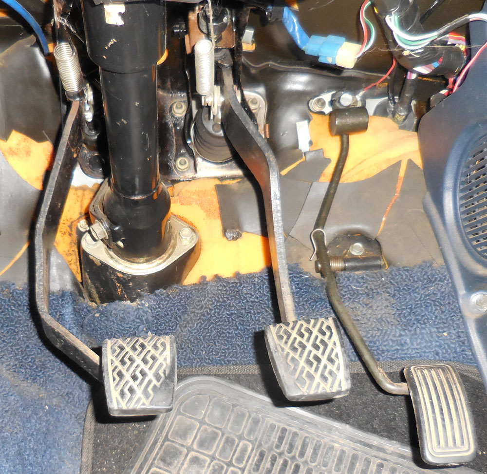

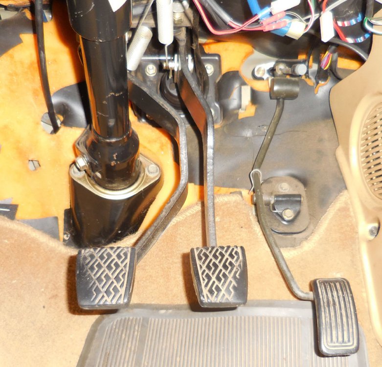

altezzaclub Posted April 9, 2018 Report Share Posted April 9, 2018 That looks like a stock KE70 pedal setup. Here's my 5K manual setup, converted from auto also. Here's my other KE70, pedals from an AE71 so it is hydraulic for the T50. Quite different, but bolts straight in. Quote Link to comment Share on other sites More sharing options...
MrTougéTka Posted April 9, 2018 Author Report Share Posted April 9, 2018 9 hours ago, altezzaclub said: That looks like a stock KE70 pedal setup. Here's my 5K manual setup, converted from auto also. Here's my other KE70, pedals from an AE71 so it is hydraulic for the T50. Quite different, but bolts straight in. Yeah so I'm guessing I'd need to go t series tranny and hydraulic clutch setup by the looks of that, Quote Link to comment Share on other sites More sharing options...

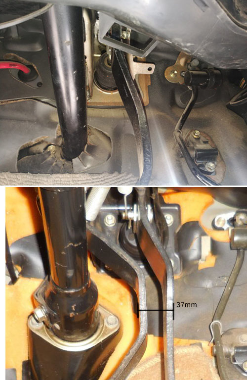

altezzaclub Posted April 10, 2018 Report Share Posted April 10, 2018 Well, its worth giving it a try. The pedal arms are 37mm apart, and it looks like the carina has that much room. Quote Link to comment Share on other sites More sharing options...
