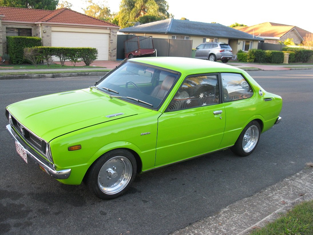

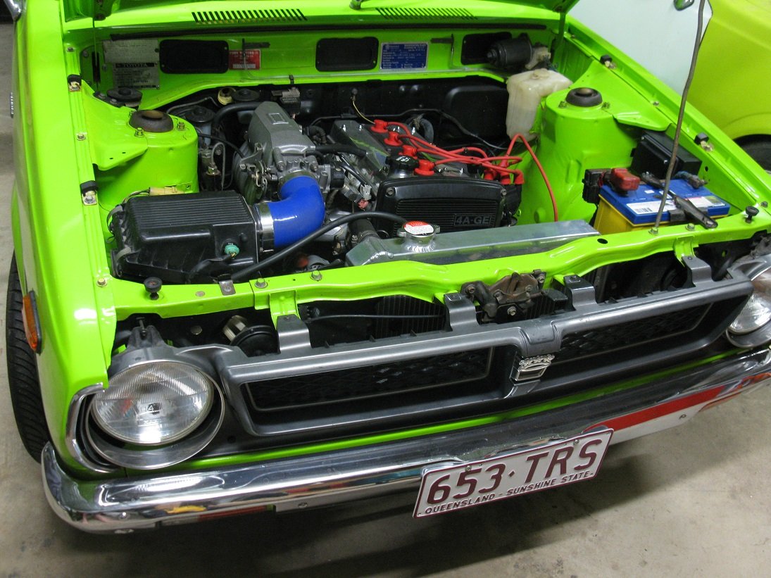

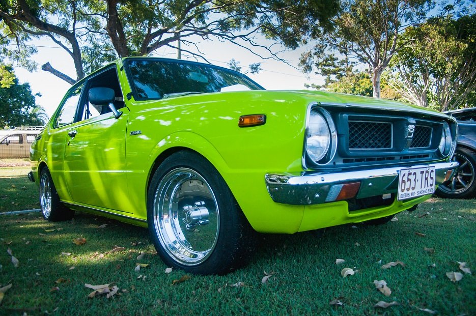

Had this car for a while now and slowly getting there. It came with the green backyard paint job, jellybeans, threaded bolts, wheel well half full of water and spaghetti wiring amoungst other stuff. Needed a bit of tidy-up. Ive had a few 4 doors over time and managed to hang onto a few bits which went into this car. I bought a written off AE82 twincam and did the conversion. I rebuilt and installed an AE86 front end still with ADM calipers. Its not quick but I like the 4AGE. Grant from NZ did the interior, He's a legend. I love the styling of 70's 2 door OZ fords, Holdens, Chargers so I like my rollas to look ADM if that makes any sense.

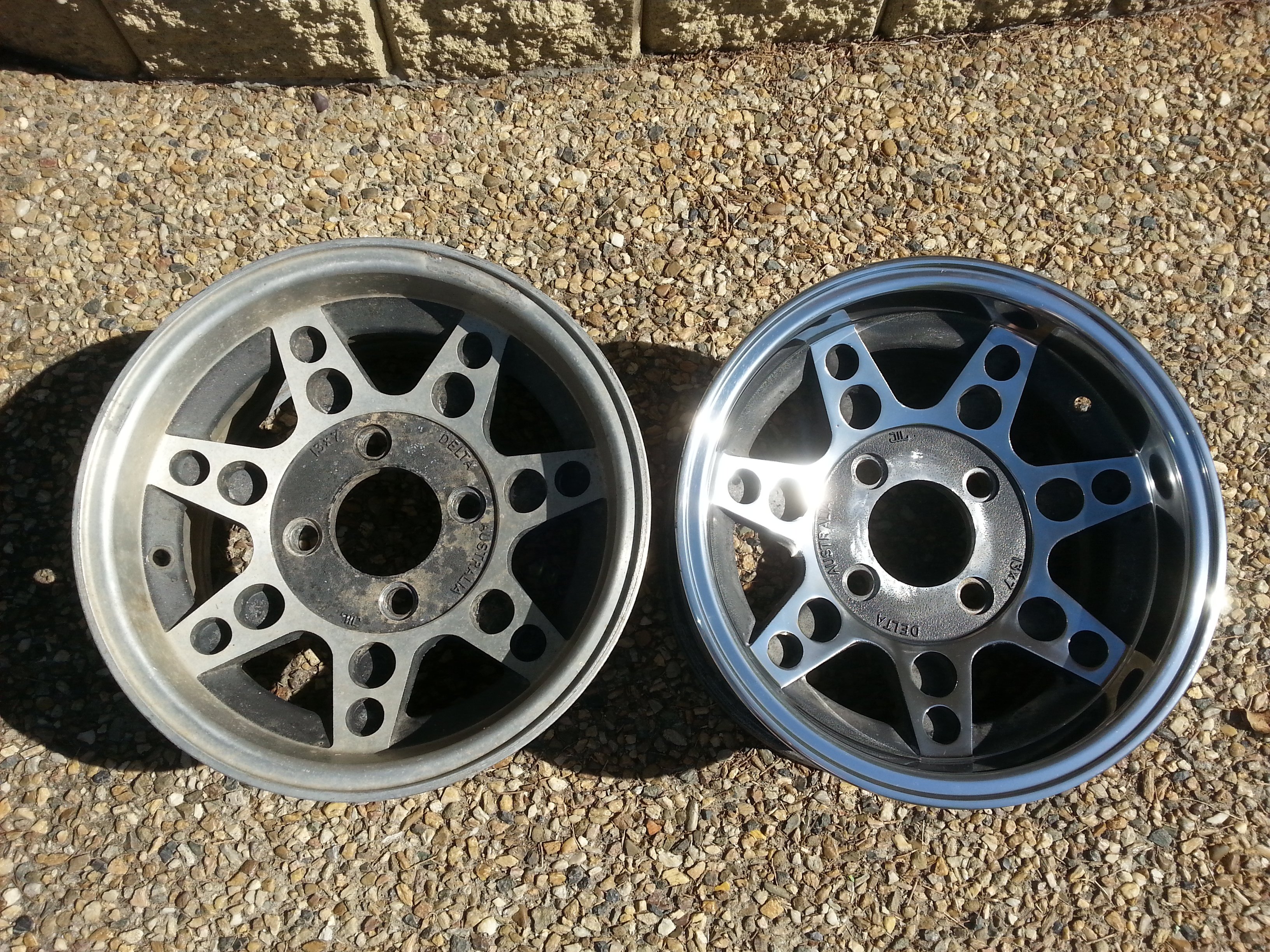

I have SSR meshies 16 x 7 fronts and 16 x 8 rears that will go on ( everyone rolls eyes but hey, its my car ). I also have some Aussie delta 13x7 that I'm refurbishing. The MK1's will go on my other Corolla.

Redo the wiring in the engine bay
spare 4AGE that I will rebuild at some stage with a little more poke. I don't know much about engines so might aswell have a go and learn something new.
