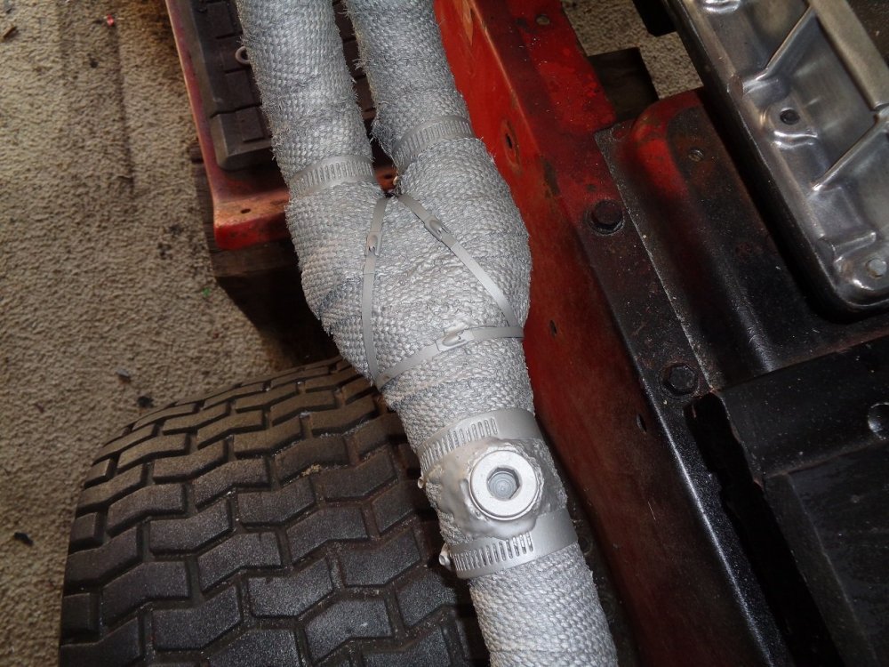

I finished up, just buying some ordinary  S.S. hose clips at SCA, which worked perfectly, as depicted below.
To stop the wrap from losing tension, as I wound the tape tightly around the pipe, I used oridinary plastic zip ties to temporarily hold the wrap in place, until I got to the end, & fitted the metal hose clamps.

I used simple tie wire and twisted it off with the tie wire pliers to secure the ends, you couldnt really see it and on the headers I did you could get it into pretty small spaces.
Id like to see it done on the collector:
Tie wire is a good idea. I might give that a try around the "collector" area.  Actually, if you look closely at the area you highlighted above, I did leave one of the temporary plastic zip ties there to see how it fared with the heat.  The big one going around the collector is a long one that was supplied with the tape kit, but it is loose, so I might pull both these off, & tie them off as you have suggested, & see how it looks & works.

I did a bit of cleaning up, on the collector area, as suggested, & although not using the tie wire, I did make a triangle, using the Bunnings stainless steel ties, which are heaps better than those supplied with the heat tape.
