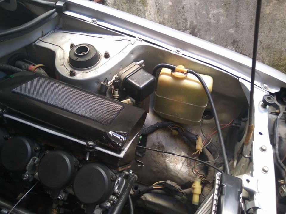

I rebuilt and upgraded my 5K on the last months and to ensure proper cooling I upgraded my radiator.
I chose a Nissan Primera GT (SR20DE) radiator because the inlet and outlet are on the same sides as my standard radiator but the Nissan one is huge!
Made my way with the mounts and pipes but I'm having an issue while the engine is running.
I'm still using the stock expansion bottle and when I push the engine hard the bottle overfills and spills the exceeding amount.
I have 3 possible causes:
1 - Since the radiator is far bigger and takes a bigger volume of coolant, can it be expanding properly and the stock bottle is just too small?
2 - Maybe my radiator cap is faulty?
3 - Blown headgasket (unlikely since it only has 1000kms and no other headgasket related issues are present. No oil/water mixing, no overheating, nothing)
As said above the engine is not overheating in any circumstance, it just expands too much coolant.

You can blow a head gasket between water and exhaust and this pressurises the cooling system and forces the water out. It wont overheat until all the water is gone. Check at the radiator filler point for bubbles of air when the radiator cap is off and the engine is running.

Everything is fine, I bought this tool to help me bleed the system and after a few big bubbles came up (after the thermostat open) it stabilized and no more bubbles appeared

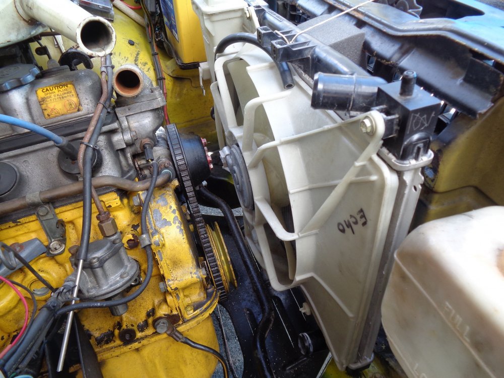

I did a similar modification, but I didn't use the Nissan radiator, as although it had the inlet & outlets in the right places, it was too big.
I used a Toyota Echo aluminium radiator, & the results were exceedingly good.  The Echo radiator, is very close to the original size of the K series radiator.
The aluminium radiators are so more efficient than the old brass ones, that my thermo-fan rarely comes on.  Usually, 4-5 minutes after I have stopped, & turned the engine off, after a "spirited" run.
I can imagine your engine maybe over cooling, if there was no thermostat fitted, but not overheating.
Have you taken any measurements of coolant temperature around the engine ?
Did the head gasket coolant holes line up OK, so the flow between block & head, was not impeded ?
Does this standard expansion bottle overflow water feel really hot ?
Have you simple tried a bigger vessel, in place of the existing plastic bottle ?
On the Echo radiator, I used, the overflow/expansion bottle, which is part of the radiator shroud. It was much smaller than the original K series, so I was initially concerned is might be too small. It was not an issue at all.
