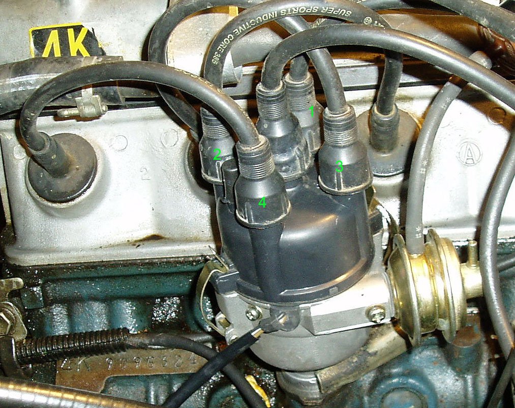

Did you pull the distributor? Could have inserted it 180* off, or plug wires switched? Pull the spark plug on number 1 and verify that the cylinder is coming up on the compression stroke, when the rotor is pointing to the number 1 terminal on the cap.   Davew7

Sort out number one firing as Davew7 said, watch the rockers through the oil cap to make sure its #1 firing stroke and not exhausting stroke. The #1 rockers will be still at TDC firing, but rocking for #1 exhausting.  It will fire as soon as the points open, so while you set the points gap on top of a square shoulder on the dizzy cam to get maximum opening, you time it before the shoulder as the points just open.
So rotate the crank to 10deg before top dead center firing #1,  make sure the rotor points to #1 plug lead as dave said, then set the gap with the rubbing block right on the square of the shoulder, then turn the dizzy clockwise until the points just close. I usually turn the ignition on and turn the dizzy back and forth so the points just spark at 10deg BTDC and then lock it down.
With the cylinder correct, the gap correct and the timing correct, the only thing left is the plug lead order, 1,3,4,2 going clockwise.

For any old car, take the dizzy cap off and turn the motor by hand a little to see which way the rotor turns. You'll find K motors turn clockwise. The firing order is 1342, only a few very odd engines use 1243, its unbalanced. Usually #1 is closest to the engine and at the front, so that lead is shortest, but when the dizzy is out it can be put back in any way.
So- turn the motor by hand until the rubbing block of the points is right on top of a dizzy shaft shoulder. That is max points opening. Check the points gap with feeler gauges and get them to about 0.4-0.5mm.
When the motor runs pistons 1 & 4 come up together, then 2 & 3 come up together. You need to have #1 on its firing stroke and #4 on its exhaust stroke for this next bit. Take the plugs out first. Then take off the oil filler cap and turn the motor watching the rockers at the front of the motor under the oil cap. You'll see #1 inlet rocker there, its in front of the oil filler cap and the exhaust rocker is wayyy at the front. When the crank comes up to top dead center that rocker will close and be still for the firing stroke, or moving and opening as the crank goes past TDC on the exhaust stroke. Both strokes have the same look on the crank pulley, which is why so many people set #4 by mistake.
Watch the rocker to work out if it is #1 cyl firing or #1 cyl on exhaust. You will want #1 to be firing, so the rocker will close at 1/4 before TDC and stay closed as the crank goes past TDC. If it is moving, then the next time the crank comes to TDC will be firing.
Then turn the crank to 10deg BTDC on the firing stroke, you'll see it on the cam cover and there's a groove on the back edge of the crank pulley that goes right past it. That's when the spark plug will fire.
With the crank at 10deg, you want the points to be just opening, so now you turn the distributor until the rubbing block is just touching the start of a dizzy shaft shoulder. That's why you need to know it turns clockwise, the rubbing block has to be on the clockwise side of the shaft shoulder.  Turn the key onto 'ignition' and it will spark just as the points open, you turn the dizzy back and forth a little until it just sparks and that's where you lock the dizzy. That's fine for running the motor, you can check it with a timing light later, but I find doing it by hand is just as good.
Whatever plug lead the rotor points to when you put it back on is now #1. The other 3 leads follow clockwise, 3 then 4 then 2.  You can change which lead is #1 by taking the dizzy out and turning it around so different teeth mesh on the cam.
