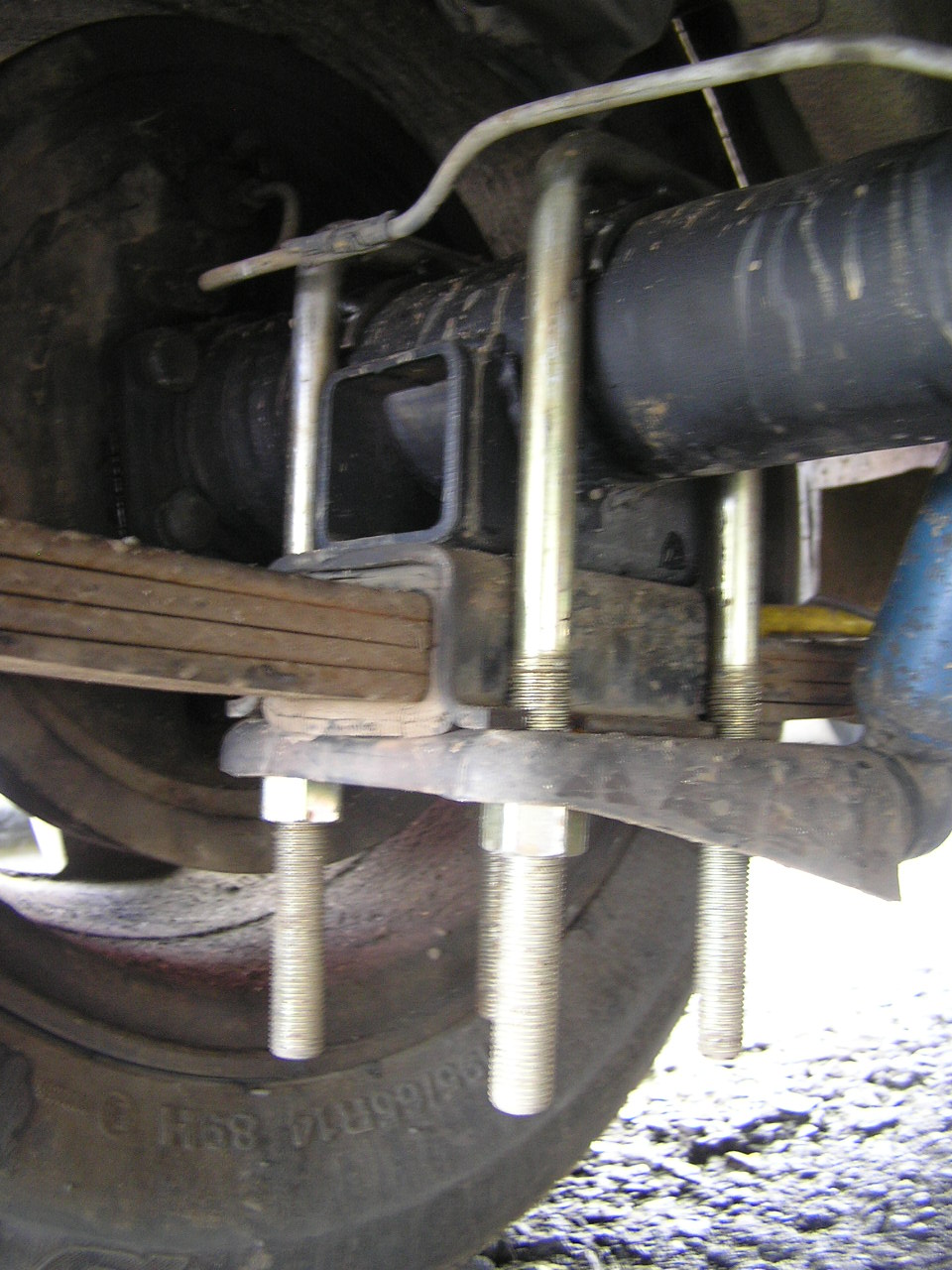

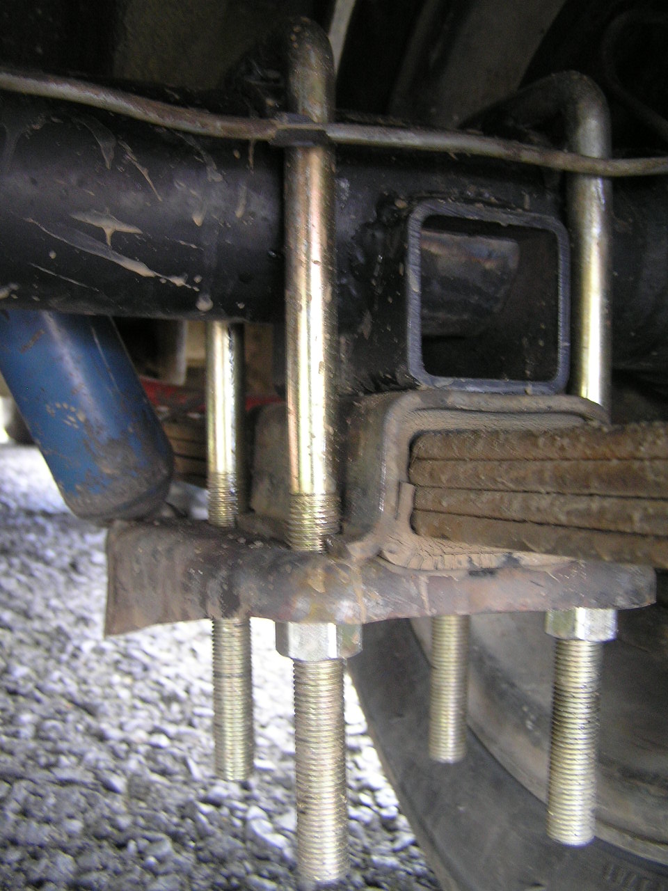

Falken_KE30 Posted August 24, 2006 Report Posted August 24, 2006 cut the ends of ya U bolt thiny....they a bit long!! but looks great though, good work...now you can do mine haha Quote
ke30king Posted August 26, 2006 Author Report Posted August 26, 2006 i'm not cuttin 100 bucks worth of u bolts. i'm gunna make some blocks to put in there. should take a bit of it up Quote
Spode Posted August 30, 2006 Report Posted August 30, 2006 (edited) well my friend, you have turned the good old corolla into a fire breathing machine. So whens are you putting the 4age in and stepping up to the big boys? haha kidding, your corolla is looking tidy as, conversion is neat and bar the U bolts sticking out 100cm Its feeaking TIIIGHT BRO. Take it easy, Tom Edited August 30, 2006 by Spode Quote
ke30king Posted August 30, 2006 Author Report Posted August 30, 2006 cheers cuz, yeahdont realy want to cut them off yet cause i'll be making up some lowering blocks maybe next weekend, dunno yet. cheers, lloyd Quote

toyrota Posted September 17, 2006 Report Posted September 17, 2006 What are you thinking using square U-Bolts? they are meant for square trailer axles not round diff housings.. Quote
Taz_Rx Posted September 18, 2006 Report Posted September 18, 2006 (edited) diddo lloyd!! and $100, you got yourself ripped!!!! ;) should of gone to aus spring in invermay, they make them in the thickness and length you want at about $10-$15 each!!!! oh, and if you are going to keep those ones, then DO cut them. by the looks of it, if you get a flat in the back end, you'll go very close to sitting on the u-bolts. do it in the car with the NUTS ON, then if you ever need to take them off again, the nut will re-cut the thread at the end. Edited September 18, 2006 by Taz_Rx Quote
NickZ Posted September 18, 2006 Report Posted September 18, 2006 I bought a set from the spring works at invermay for $60 full set Quote
