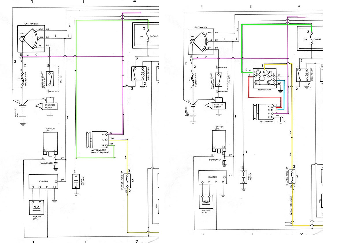

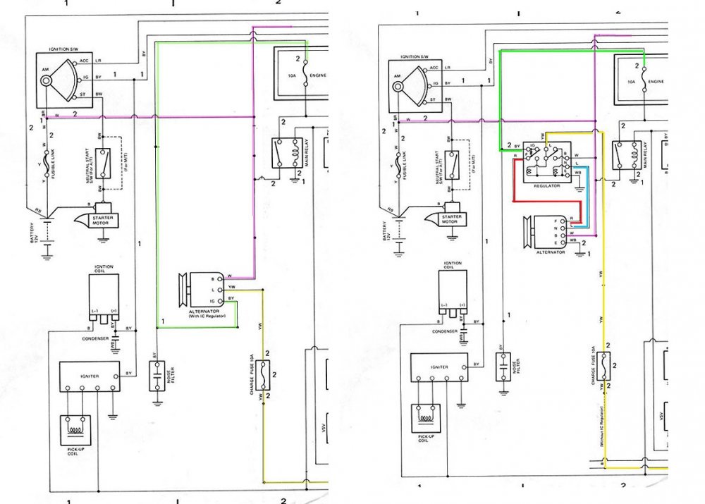

The charge light circuit looks like this-
or like this-
which shows both internal & external regs.
Have a read through this too-
or like this-
http://wilbo666.pbworks.com/w/page/39441708/Toyota Alternators
