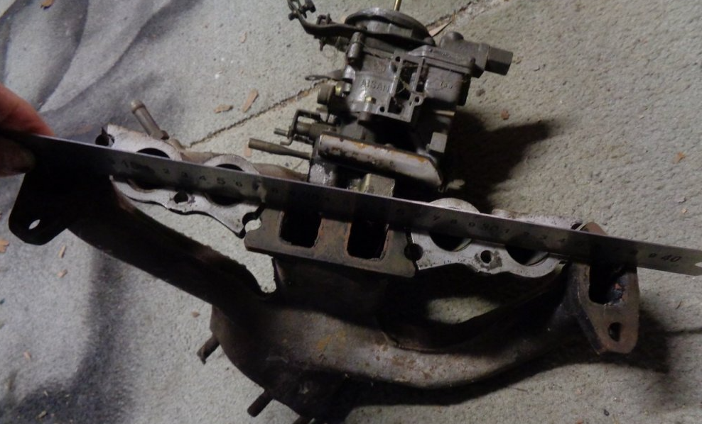

Guvna Posted April 6, 2022 Author Report Share Posted April 6, 2022 need to get it to idle first, its got extractors and no exhaust atm. the inlet manifold bolts are not able to be fully tightened. the manifold and header will need to come off for realignment and or modification plus new gasket. i think the carby has been put on the wrong way around, unsure if that makes any difference? I need to work out how to get the timing right also as it has an upgraded cam as far as i know so the timing marks aren't helpful. so far ive ironed out many of the electrical connections to get all light, blinkers etc working. Also got a nice set of work equips 13 x7 and 13 x6 with good offsets which makes it look great allready, will get some pics up soon Guvna Quote Link to comment Share on other sites More sharing options...

Guvna Posted April 7, 2022 Author Report Share Posted April 7, 2022 Thanks for the welcome and advice Banjo and guvna/coln72 haha i think i have the old 2 piece manifold / gasket based on torch inspection, ordered a Permaseal EM30 one piece gasket to correct, gonna get new studs also. i think the aftermarket headers and original inlet manifold aren't friends and i will need to grind or drill the duel bolt meeting points even to accommodate the bolt to stud contact. also, is this carby on the wrong way? does it matter? ie turn 180 degree? soz for starter in pic regards Guvna Quote Link to comment Share on other sites More sharing options...

Banjo Posted April 8, 2022 Report Share Posted April 8, 2022 (edited) Hi Guvna, Quote i think the aftermarket headers and original inlet manifold aren't friends and i will need to grind or drill the duel bolt meeting points even to accommodate the bolt to stud contact. You are totally correct ! There are four (4) of the total of six (6) manifold studs, that clamp/hold down both inlet manifold, & exhaust manifold or extractor assembly. It is imperative if you are going to achieve good manifold/head seals, that not only are the mating surfaces in total alignment, but that the the outer sides are also level, so that the extra thick washers used underneath the four (4) manifold nuts clamping these "shared" joints are parallel to the head manifold surface; so equal pressure is exerted on both inlet & extractor tabs. It may require a bit of filling, on the outer sides of the tabs, to achieve the same thickness, but is very worth while, in the long run. Also support the extractor exhaust header, to the engine / bellhousing joint area, so that any movement of the exhaust system, is not transmitted to the head/manifold joint area. Another suggestion is to now add a bug in your exhaust extractor header, assembly, just beyond where the four pipes all join. This allows the addition of a O2 sensor later on, if you really get into the K Series engine, & want to either, just monitor your air fuel ratios, or get really excited, & want to go EFI. The bungs come with a stopper, so even if you don't get an O2 sensor now; when you do, you don't have to remove the exhaust system to add a sensing point. Cheers Banjo Edited April 19 by Banjo adding copy Quote Link to comment Share on other sites More sharing options...
