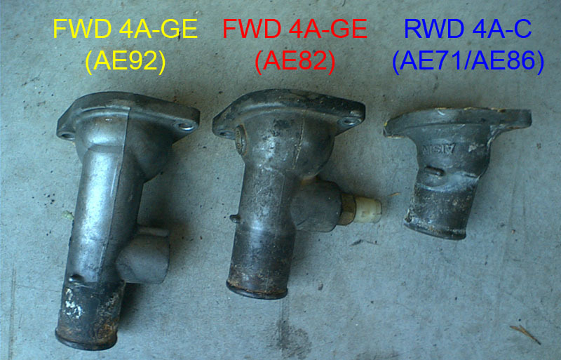

Thermostat:
As mentioned before the RWD 4A-GE pump housing rear has a thermostat integrated, again this is similar but not exactly the same as the RWD 4A-C one, it isn't really ideal to use on the RWD 4A-GE setup. The small inlet pipe from the radiator does not have any provision for a temp sensor and is the same for both RWD 4A-C and 4A-GE. The thermostat for a FWD motor on the other hand is different, it is in its own remotely located housing, there are 2 different types, one from an AE82 and the other from the AE92/3. They are fairly similar and both have provision for a temp sensor on the inlet.

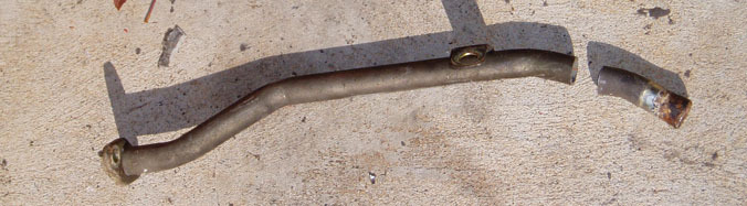

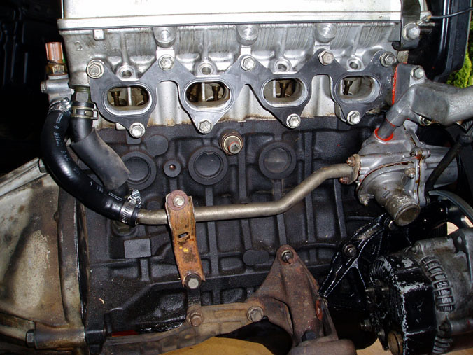

RWD Water System on a Smallport 4A-GE
As some may already know, you cannot use RWD 4AGE heater return on a 4AGE with a knock sensor (small port, GZE etc). I devised another plan which was to use the heater return off the 4AC RWD and twist it 180 so that it sat off the block and also sat lower than the sensor. Here are a couple of photos to explain.
You can see here the small amount I had to lop off to make the pipe fit in (otherwise it just goes straight into the sandwich plate). I cut up an old battery strap to make a mount for the pipe and it works brilliantly:
Shown is the incorrect connection of the heater water line, if a heater is not being used both ends should be plugged not connected together as shown above. This above water make an effective radiator bypass.
(Sam-Q)
