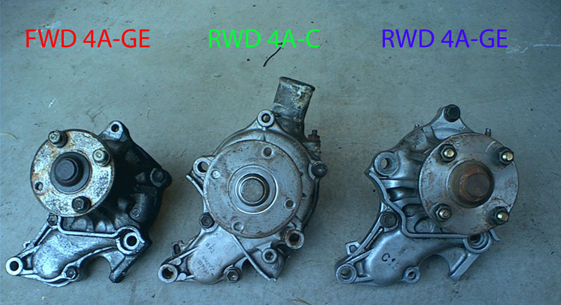

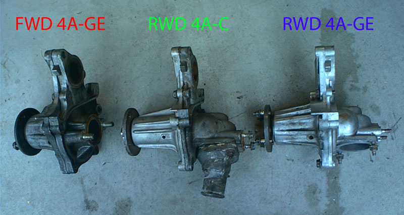

Water Pump:
A front wheel drive (FWD) 4A-GE water pump off either an AE82 or AE92/3 is fundamentally different from a rear wheel drive (RWD) 4A-GE pump from a JDM AE86. To begin with, the RWD pump is taller than the FWD pump (i.e. Sticks out further from the engine block). The RWD pump also has better bearings in order to support the weight of a pump mounted radiator fan. Note: If you attach a fan to the front of a FWD pump it will soon fail and no longer function. Interestingly, a RWD 4A-C water pump is almost identical to that of a RWD 4A-GE pump. The only difference is the position of the little ridge on which the cam cover sits.

Water Pump Rear Housing:
Once again the FWD variety of the 4A-GE rear housing is very different to the RWD version. It consists of only a single large water inlet (from thermostat) and an outlet which bolts directly onto the front of the 4A-GE block. The RWD version on the other hand has in integrated thermostat just after the water inlet as well as a bypass inlet from the front water outlet on the head. There is also another inlet which comes from the heater core and had the same outlet bolted onto the block. The RWD 4A-C rear housing is identical to that of a RWD 4A-GE one.

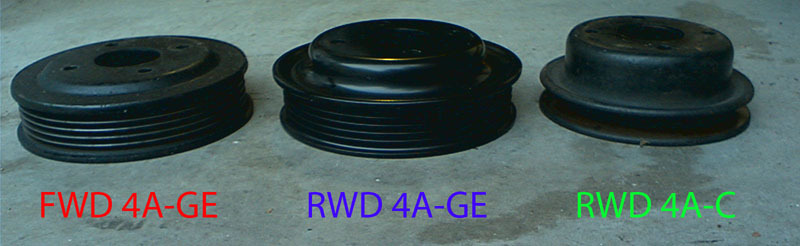

Water Pulley:
A FWD 4A-GE has a pulley with a smaller offset than the RWD 4A-GE one in order to compensate for the shortness of the FWD water pump. The RWD 4A-GE one is considerably more offset. The RWD 4A-C version has the same offset as the RWD 4A-GE one but it uses a single V belt rather than a 5-rib belt.

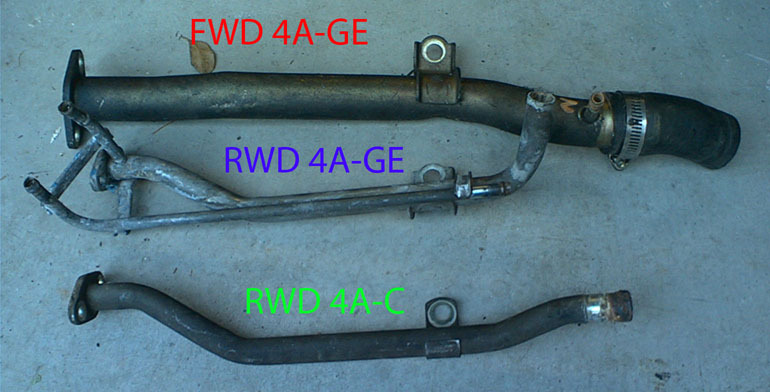

Rear Water Pipes: (From the back of the water pump rear housing)
As mentioned before, The FWD 4A-GE has a large inlet pipe coming from the remote thermostat. The RWD 4A-GE system has one main pipe which comes from the heater core, It also has some smaller pipes which direct water into the throttle body. The RWD 4A-C pipe is just a single return from the heater core.

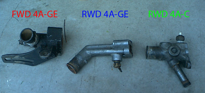

Rear Water Outlet from Head:
There are 2 different FWD versions of this outlet the AE92/3 4A-GE has a pipe which protrudes out further from the block than the AE82 4A-GE version. The RWD version from an AE86 4A-GE is very similar to the outlet from an AE82 4A-GE except the outlet pipe is longer and has another small pipe coming off it for the throttle body. The RWD 4A-C one is not at all similar to any 4A-GE version.

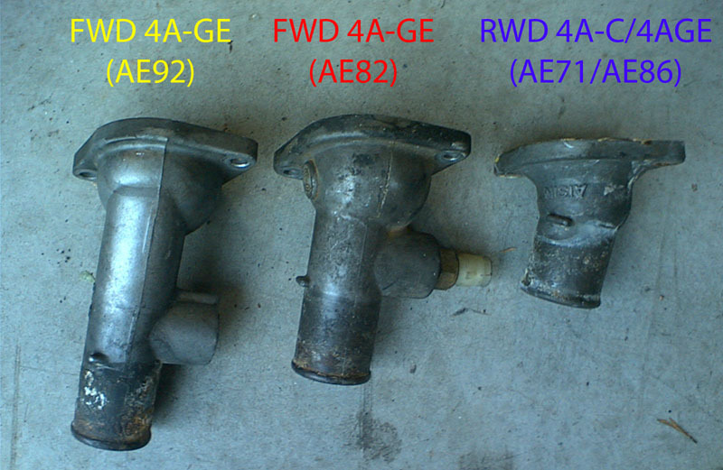

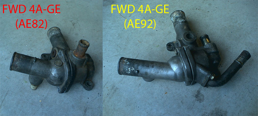

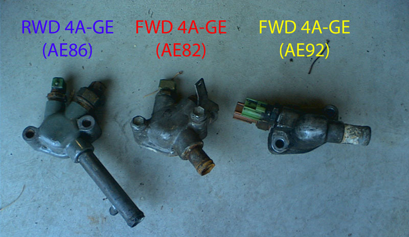

Thermostat:
As mentioned before the RWD 4A-GE pump housing rear has a thermostat integrated, again this is the same as a RWD 4A-C one. The small inlet pipe from the radiator does not have any provision for a temp sensor and is the same for both RWD 4A-C and 4A-GE. The thermostat for a FWD motor on the other hand is different, it is in its own remotely located housing, there are 2 different types, one from an AE82 and the other from the AE92/3. They are fairly similar and both have provision for a temp sensor on the inlet.

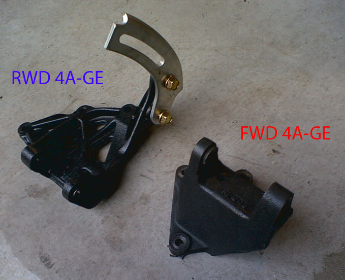

Alternator Bracket:
There are 2 main different types of alternator bracket for the 4A-GE the FWD one bolts on at the bottom of the block and sits the alternator relatively high. And adjuster strap is mounted to the front water outlet from the head. The RWD one on the other hand bolts to the same place but sits the alternator lower and has an adjuster strap mount on itself. It also has one extra bolt, sitting on top of the RWD engine mount. Why does this matter? You cannot run a RWD water pump and rear housing without it, otherwise the inlet will be blocked by the alternator.
