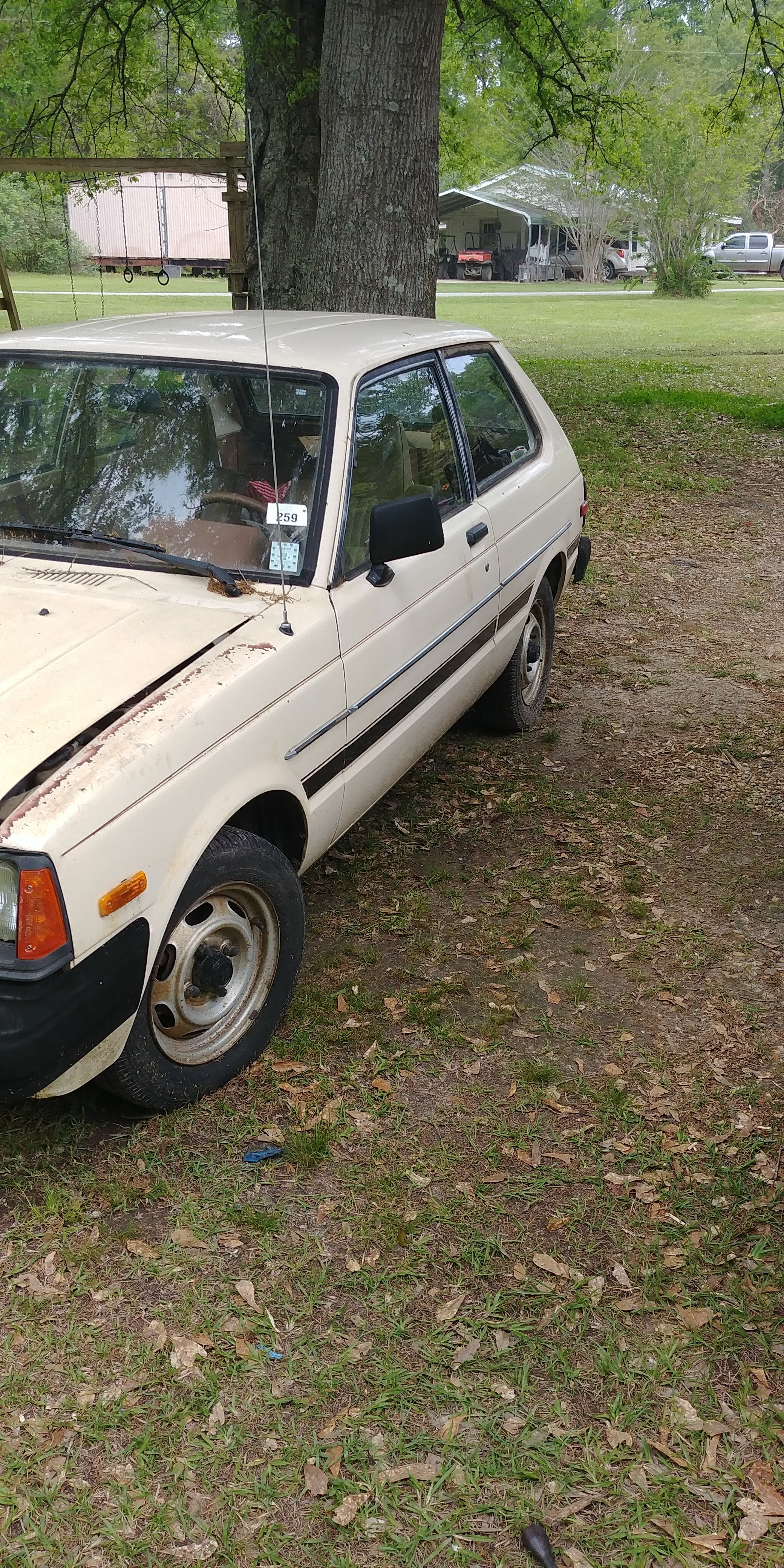

  5. Yeah, it's a rear wheel drive, black bumpers. I found a pin out of the ecm on this website. I have power to batt and b+ at the ecm, and good grounds. Also pin STA which is "ecu start signal" is hot. Here are a couple more pics. Not perfect, but to me nice for an untouched 1983.

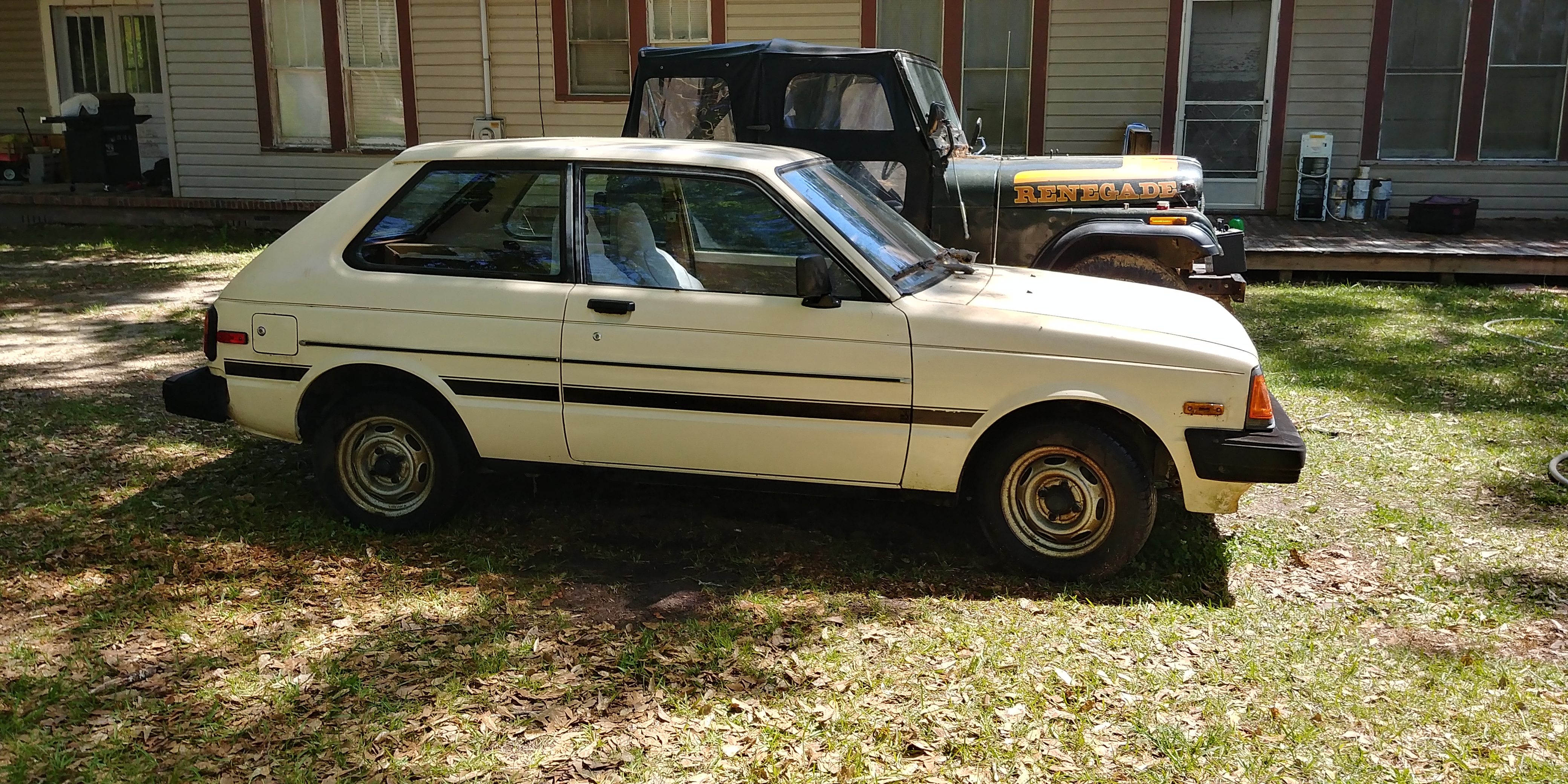

  6. Here's a picture of it as I wait for the ecu to arrive.
