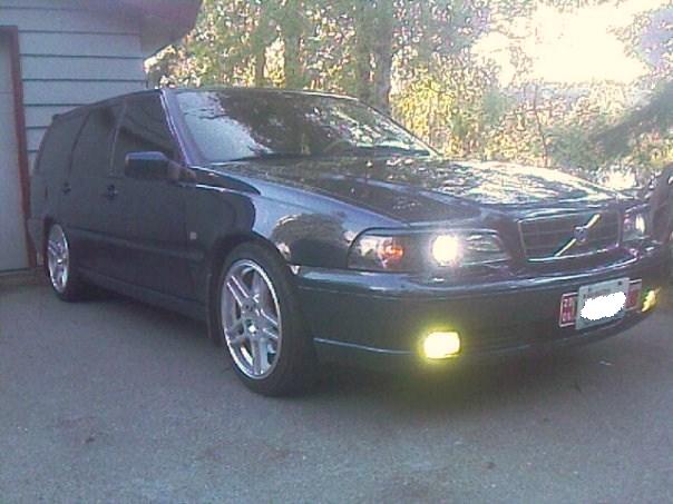

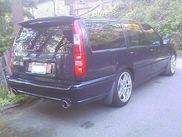

  5. Thanks for confirming parrot! 7shades, I have a 98 V70 T5 manual trans. Dyno was 239.5 Wheel HP, 330 wheel torque. I believe I have an old pic around...
