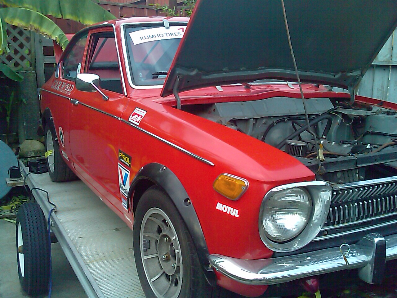

    yeah, I called mahle, no luck. Venolia will build them cheapest $400 or so. Here are a couple more pictures. Since these were taken we fixed some minor rust in the towers and where the fenders met the fire wall and we added a proper braking system with a new pedal and new reservoir. We also put in a stainless exhaust. BTW I went and looked at my TRD 3k race pistons and the pins are LARGER than stock. WTF? I'll send pics of those too, later. Maybe someone can ID them.

    Here is a picture of the race car that needs pistons -- its a Ke 17, and its been raced since 1971 pretty much constantly. BTW, have some original forged race pistons for a 3k -- the pins are different, bigger -- also they are a short skirt single ring. Very trick. I don't want em. I want longevity.

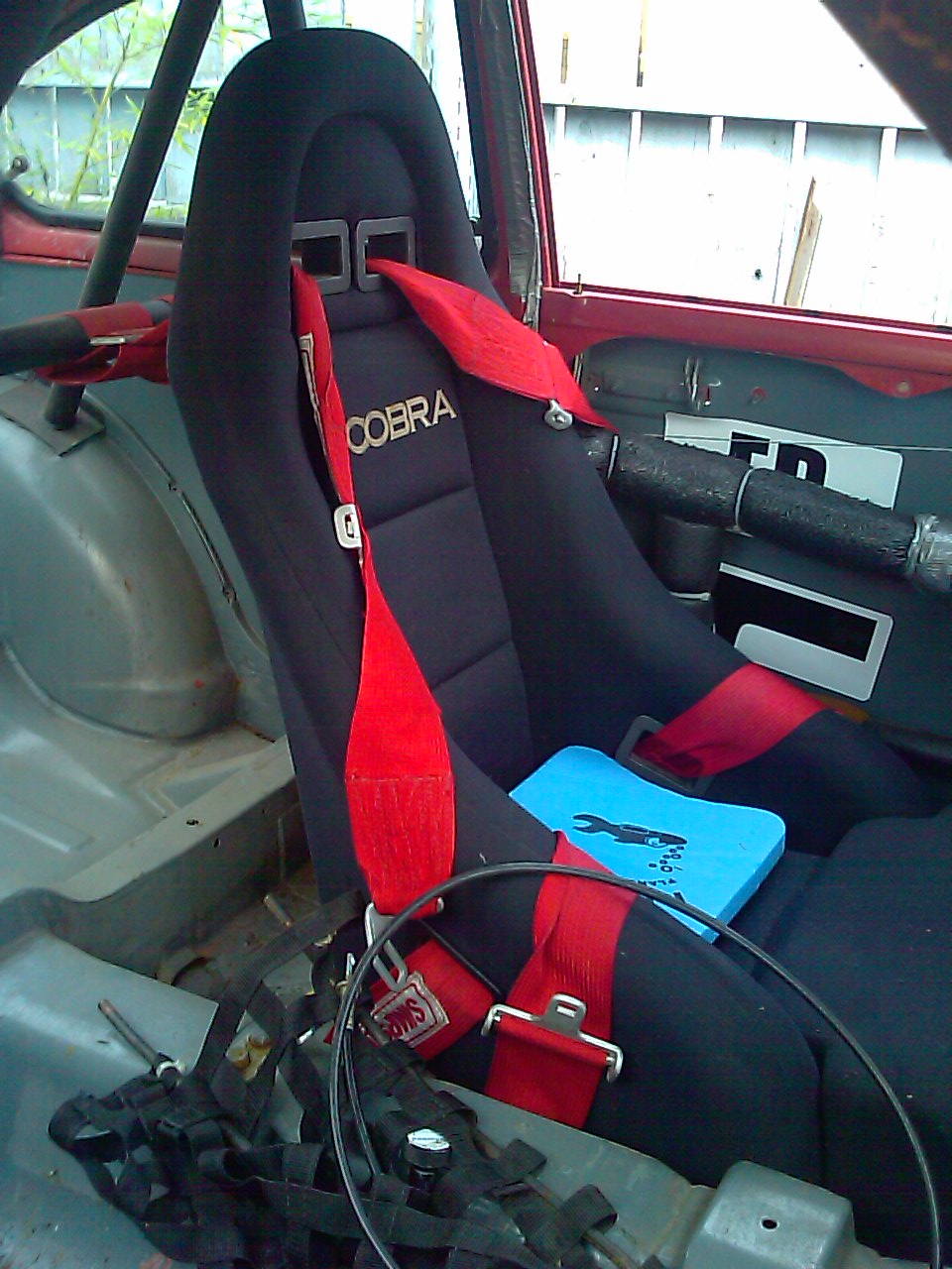

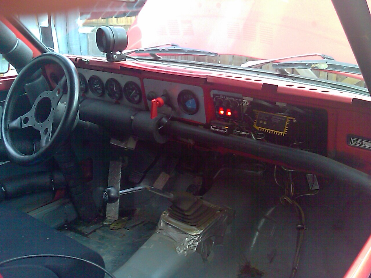

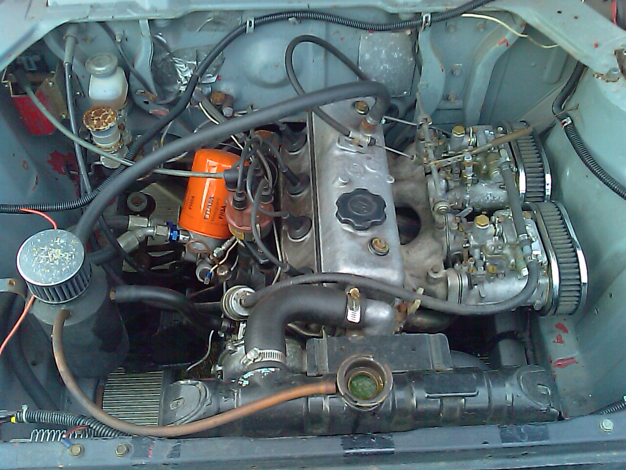

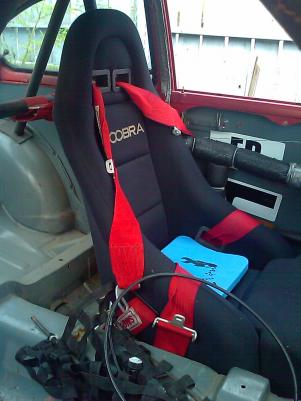

  14. I have a KE17 sprinter race car in Seattle. I got it in a trade for a cortina project and raced it once. I liked the car and decided to restore it. I just redid the body/chassis but the motor needs help now. It has a 1200 3k in it, but one of the original TRD pistons had cracked ring and I am scared to use it. I have heard that a 4k or 5k looks the same and swaps in. I was thinking that would work, but it would need to fit with my trick head and intake manifold. is a 1200 head a bolt on for a 4k or 5k? The new motor needs to look identical to the original or I'll get busted. What cars used the 4k and 5k here. I see many are T motors and they look totally different. I attached some pictures of the car. Any help would be greatly appreciated! Pete
