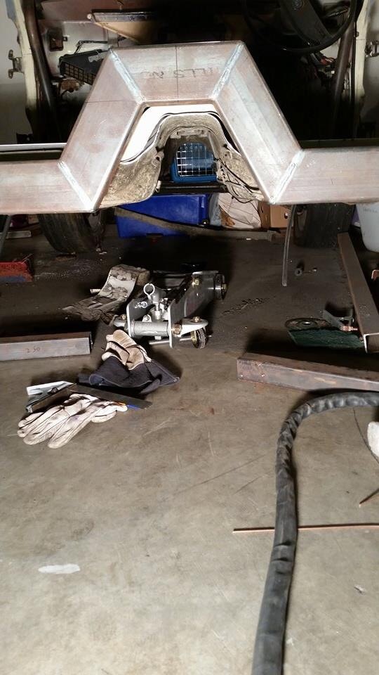

  1. Cheers guys..I'm not that phased as i will be mounting everything off the crossmember which is centered it just bugs me that it looks like ive made a mistake haha.. Thanks for the help guys
  2. Picture is taken from the back and the tunnel is closer to the drivers side Thanks for the reply
  3. Hey guys! So I'm building my ke30 project and installed the main crossmember that the suspension etc will mount from and I panicked thinking i had make a mistake but it turns out that the tunnel is offset to one side if your measuring from the door sill. Is this normal? My guess is its extra clearance for the brake/fuel lines? Cheers for the help guys
