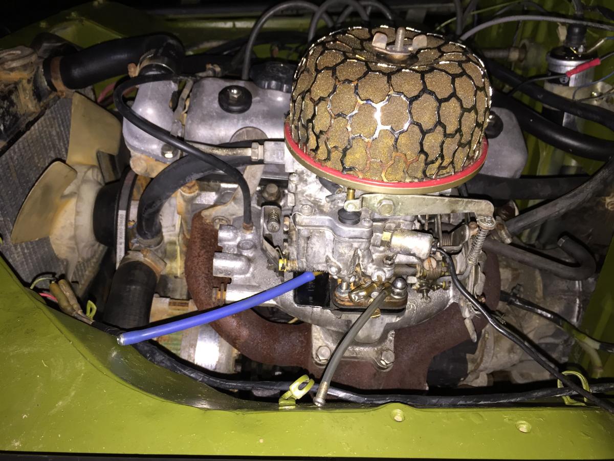

  6. Righto. Its been a while, but I did manage to get the old pig running nicely (briefly). A big thanks to all that gave advice.... What i eventually did was replace the points with an electronic set, and clean the carb AGAIN. What i ofund this time was bits of airfilter (hks mushroom ) in the fuel bowl and jets. It turns out the filter is disintegrating, and bits were going down the carb. Some were going down the bowl breather tubes and making it into the fuel bowl. It's fair to say it was driving me up the wall :wtf: Heres what it sounded like after all that . Anyway, this was its first proper trip in the mud. My mate had to throw it in 2wd and do some skids to keep his 5yr old happy : You asked for vids, i'm happy to oblige. It goes pretty well, and revs out nicely in the mud, . So nicely that we bought about 100kg of mud home stuck to it. But it has a flat spot mid revs that shows up on the sand, and it struggles to get up in the revs. I've broken it now though. Running on 3 at idle, and a snapped driveshaft :bash: I got the idle issue down to either a vacuum leak at the head on #2 or a blown head gasket. So i got new gaskets for both and ripped the head off. No clear sign of a blown gasket, but #2 cylinder head is much cleaner than the rest. I also snapped a head bolt that was frozen to the head. Bugger! Anyway, that can all be fixed pretty easily. Where do you get new head bolts from for a 4k???? And what am I going to do for some more power??

  9. Thanks Gavin, Banjo & Altezza. I took your advice, headed back down the fuel blockage route. I pulled the carb off again tonight, and checked the main jets again, all good. I missed the idle jet last time, other than spraying with carby cleaner. I think I cleaned the idle adjust and associated galleries. I pulled out the idle jet and checked it, couldnt see through it. cleaned it out with a mig tip cleaner, soaked it in carby cleaner, then put the tip cleaner through it again and got a bit of varnish out. Now I can see through it :) Now it runs really nicely, much smoother than before. Less hunting at idle than before, and consequently a lower idle. You guys are awesome! Thanks for helping out!!!! I can't wait to get this thing out in the mud!!!!

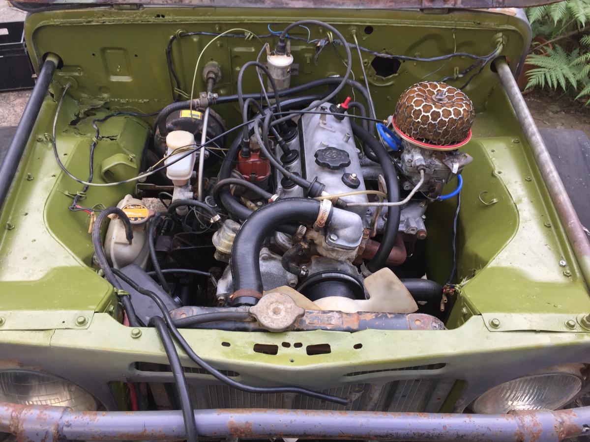

  12. Hi I've got a 4k in my bitza offroader. Its an old Suzuki lj81 running a 4k and k40 box, I picked it up recently , it was running pretty rough, so I have been working through usual maintenance, and had it running fairly well up until this weekend. All of a sudden it started running rough and died. It will start and run on choke, but dies when the choke is off, even if I work the pump. Heres what I've done so far. New plugs, gapped 0.8 Cleaned & lubed dizzy. set points .45 Timing set at around 10deg with the vacuum disconnected. Dwell reports as 45Deg. New coil. 12V no ballast. Carb rebuild. Cleaned and put most of the parts from a rebuild kit into the carb. Gaskets, pump, needle valve, reset the float and stop. New intake/exhaust manifold. Released the hotbox bolts to get the intake and exhaust to makte up nicely onto the block. New vacuum hose for vac advance Blocked off other vacuum ports with new hose. New fuel filter Its been running nicely since all that, but it died suddenly. Nicely. Rough. I have checked these things.. Spark. Still got spark. Plugs are white. can't find a vacuum leak. Blocked all pipes. Took the brake booster hose off. Sprayed carb cleaner everywhere, can't hear it rev up. Disconnected the vac advance and blocked. Took the carb off, cleaned it again and checked that no jets are blocked. I've run out of ideas. can anyone tell me what else I might me missing? Thanks in advance. Dave
