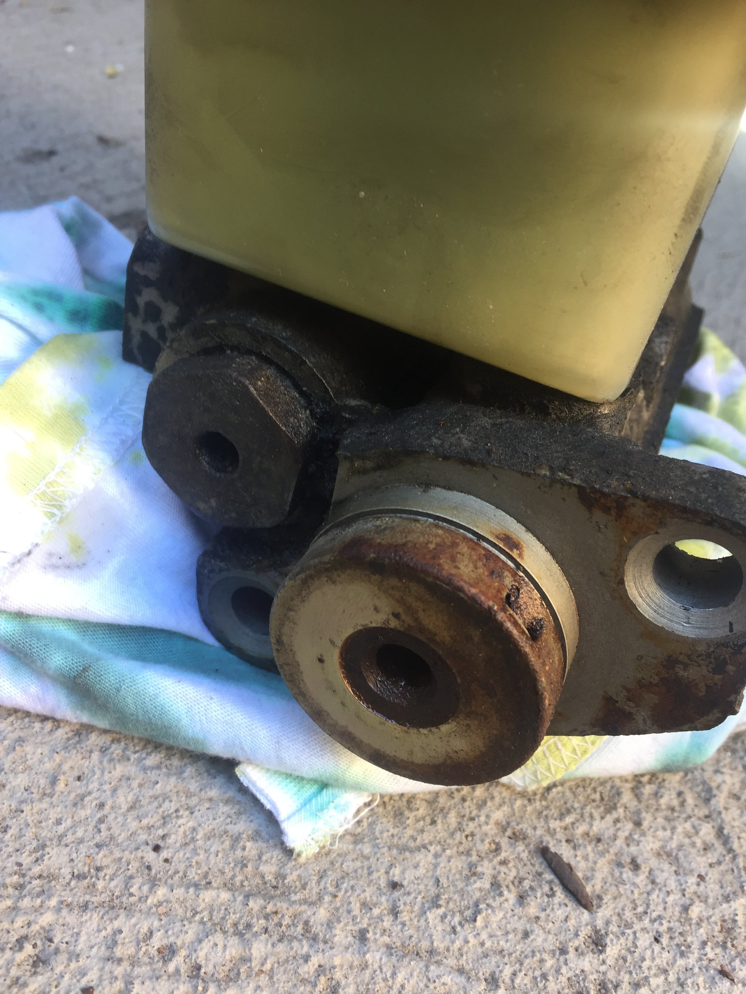

  1. @Big G That'll most likely be my next option if this seal kit doesn't work. Not sure who you used but I seen on a couple of threads people using a company up in Qld called "Master Cylinder Exchange". Being down in Vic I'm sure I could find someone locally. @altezzaclub I started to pull apart the master cylinder and had the same problem, unscrewed that hex nut and the seal block did not budge. Tried to give it a knock as per the service manual, I might have been a bit to careful, but wouldn't move. Seal kit arrived this afternoon so I'll give it another go over the weekend. If it doesn't budge I'll follow on with the rest of the instructions and see how I go. Again, thanks heaps for the information, it's been fun getting stuck into it.
  2. Thanks heaps for the info @altezzaclub That one on ebay pretty much looks exactly the same. For now I'll keep that as a last resort, however I will contact them to make sure it'll actually fit if I need it. Sounds like a plan, I'll strip it, give it a clean and try a seal kit and in the meantime I'll ring around a few wreckers and see if I can find a decent second hand one just to get me back on the road. I've got a workshop manual so I can use that for reference to help pull it apart. If that doesn't work I'll suss out either getting it rebuilt or converting it. Again, I really appreciate you taking the time to help steer me in the right direction. Note: This it what it looked like after I took it off...

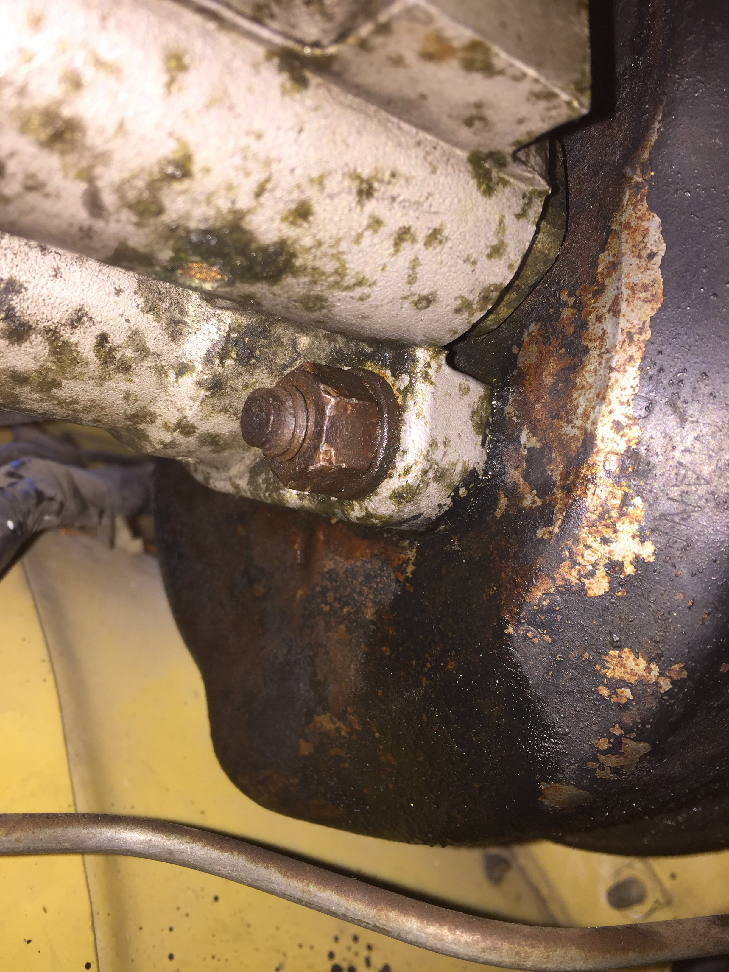

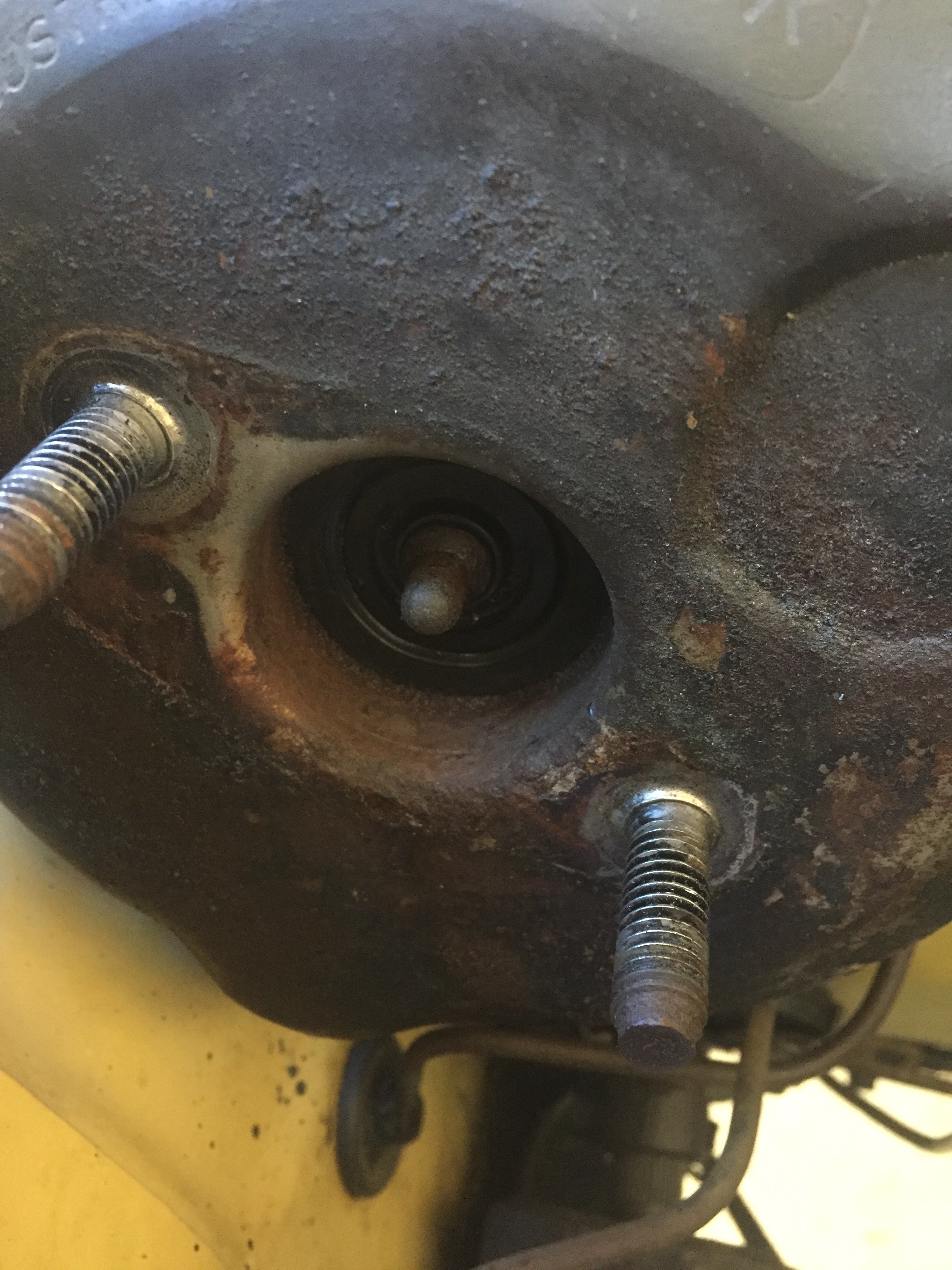

  3. Hi everyone, First time post and newbie with all the mechanical stuff. My KE38 is leaking between the master cylinder and the brake booster (pictured). The master cylinder is the PBR square type and looks to be leaking between the flange to the booster. Just after some advice before I start pulling things apart, is there a after market master cylinder that will bolt straight on to the booster? I've had a look on ebay, but the flanges look a little different to what i've got. Or could it be something else that would cause the leak. I know it's hard to tell without actually looking at it but just after some advice if anyone has come across this before? Sorry if my post seems a little naive, just starting to learn the mechanical side of cars. Gotta start somewhere. Cheers, Caylan
