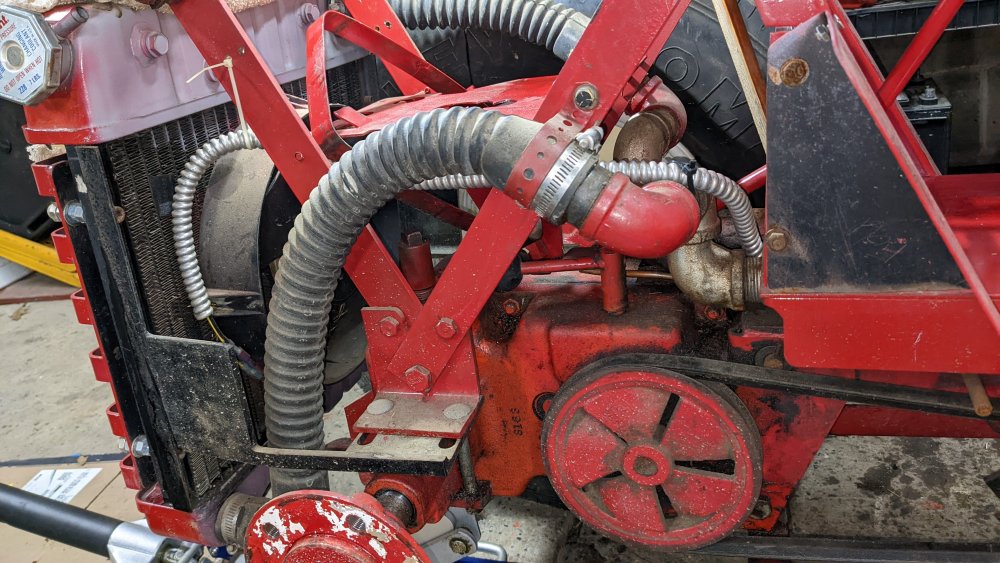

  2. I believe the old guy who designed and built this changed the water pump arrangement so that it would fit under the hood of the tractor. I have no plans of changing his design, it works just fine. The tyres are Mickey Thompson racing tires. They're about a meter wide! He made the wheels too. Original tyres were same as seen here on my C-121. As I said before, This "Wheel Big Horse' started off as a C-series Wheelhorse lawn tractor. These came with 8hp, 10hp and 16hp engines made by either Kohler or Tecumseh. The hood and frame on the "Big Horse" were elongated and it was fit with the 3k engine and big wheels. But originally it looked like my 1972 C-121 shown below I'm planning on using it mostly for show. I'll take it up to the fair and we have a couple parades every year I'll probably enter it in. Also thinking about setting it up with a hitch so I can pull my boat and a couple trailers around on my property. Maybe mow the lawn... lol seems like the turning radius would be a little bit tough but I'll look cool! It's an oddity. To me it's a work of art. I just marvel at the skill and work that went into it and would like to preserve it and share it with other people. People who are familiar with wheelhorse tractors, which are no longer made and have become somewhat collectible and sought after, recognize it when they see it. Oh, we have tractor races over here! Well see how it goes... maybe enter it in the races at the fair this summer!
  3. Thank you sooo much Banjo! I have an electric fuel pump, Brand new, had to replace it because it sat dry so long. Thanks to your pics, I was able to locate the manual fuel pump was. There is a plate over it already. So... I'm thinking of running a 1/2" hose from the small hole on top of the rocker cover and then drilling out the fuel pump plate and fitting it with some sort of barbed fitting to accept the 1/2" hose. Do you think this will work? These holes had been sitting open. I just think they should be covered up so dirt doesn't get in there. This is what I've done for now. This does not have an onboard water pump. That pump on the front circulates water to the radiator in the rear. I had to replace the pump. It was completely seized. When I removed it and looked up the number I found out that it was an agricultural sprayer pump. I bought it up the road at Tractor Supply. I had to paint it red to match. Not sure where the pully was from but he did a good job mating it to that pump and it was easy to replace. Here it is: https://www.tractorsupply.com/tsc/product/delavan-4-roller-pro-pump-cast-iron-4900c?cm_vc=-10005 I picked this up at a local auction. It was a last minute bid. I had been watching it but thought it would go for a lot more than I was willing to pay... Figured since I was a big fan of Toyota's and Wheelhorse tractors I could give it a good home. I would have hated to see someone tear it apart and scrap it or sell it off as parts. Like you said, whoever built it put a lot of time and love into it. I didn't even notice that the intake had been rotated 90 degrees until you pointed it out! Had to look at yours to figure out what was going on. Very cool! This guy was creative. BTW the carb is the original Wheelhorse carb. Same one I have on my C120 shown above. he made an adaptor plate to make it fit. I just took the carb apart and rebuilt it last night. It was clean inside but starting to leak around the bowl... from sitting dry for 15+ years. I have two tractors (now three) with that carb on them and they're the only carbs I've never had to rebuild. This was the first one.
