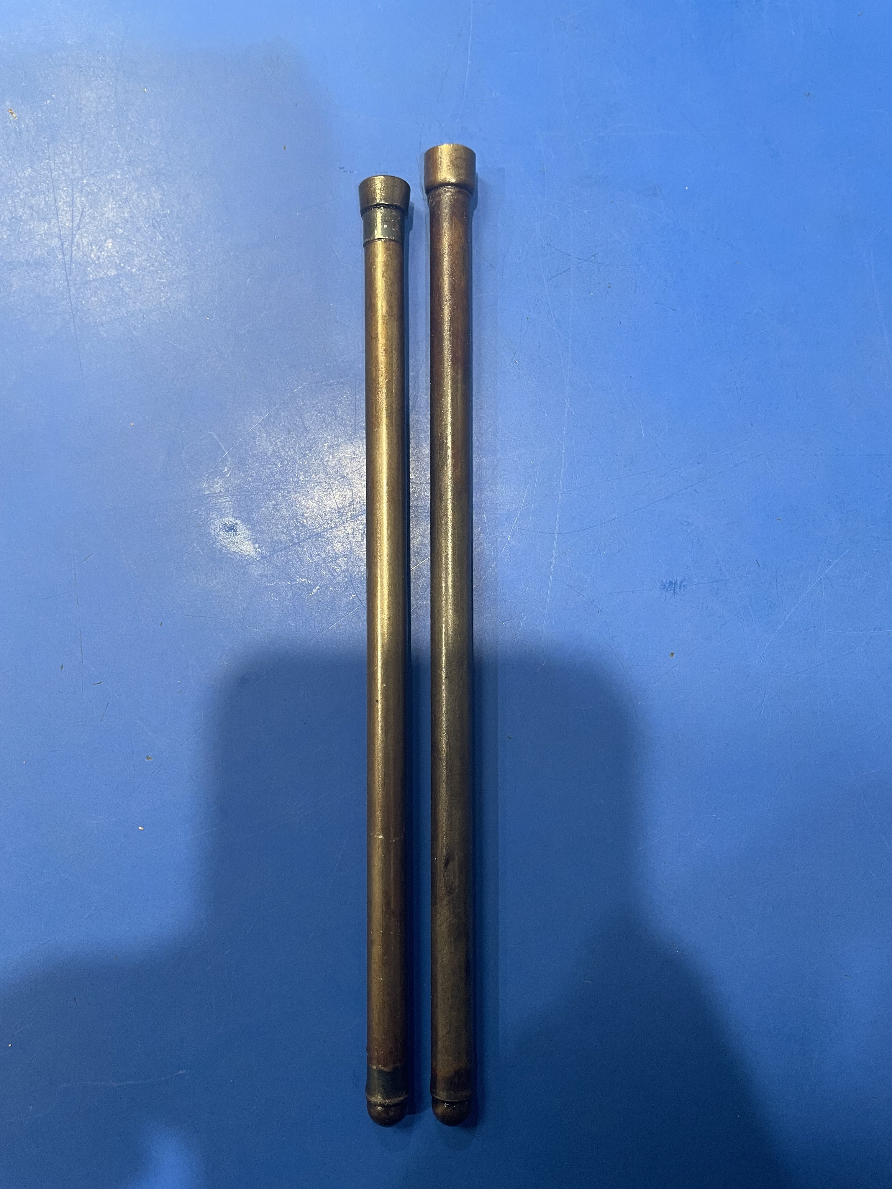

  1. the number on the block is 4k 9075652 and the number on the head is 3 Cheers Jack

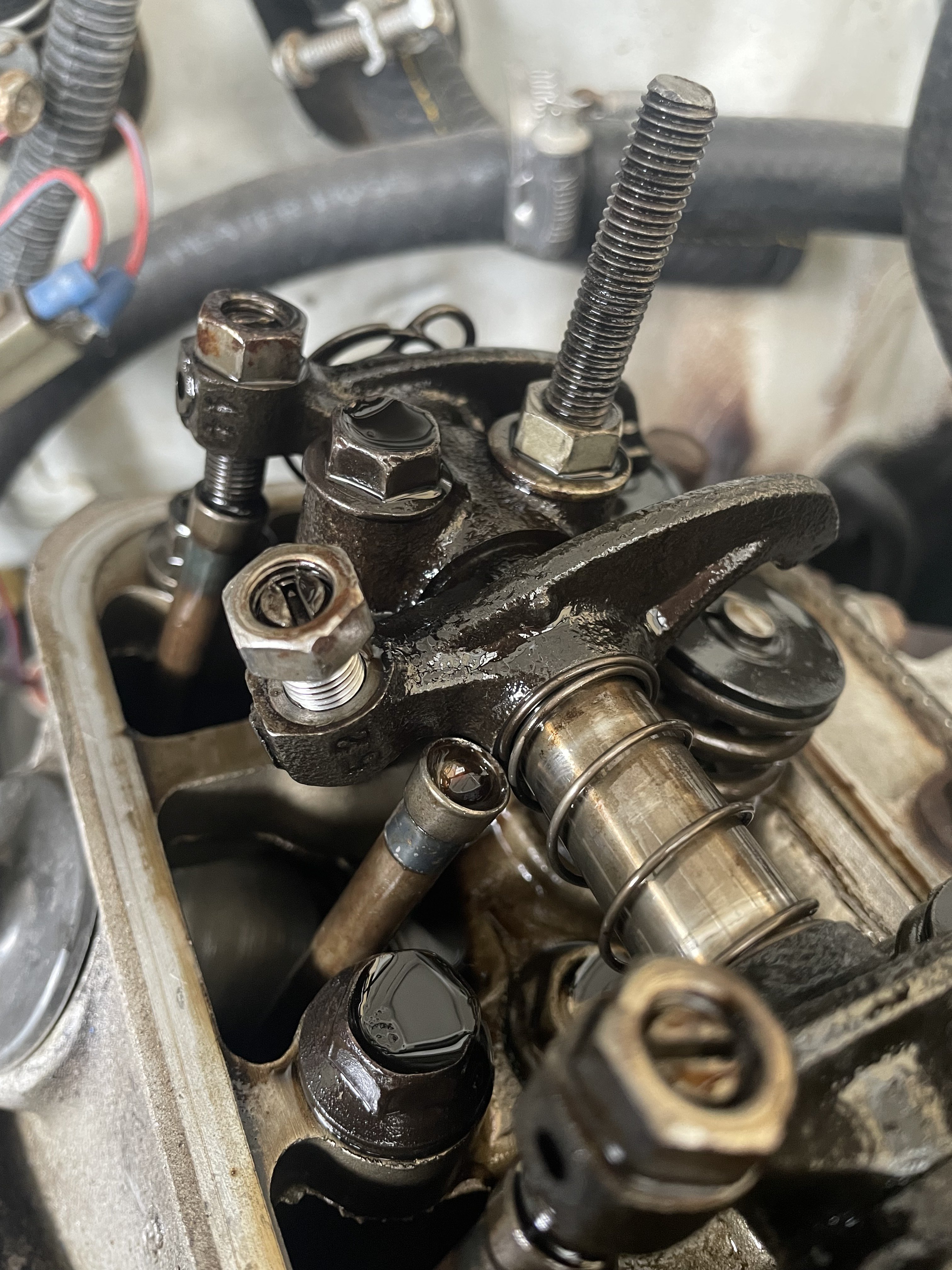

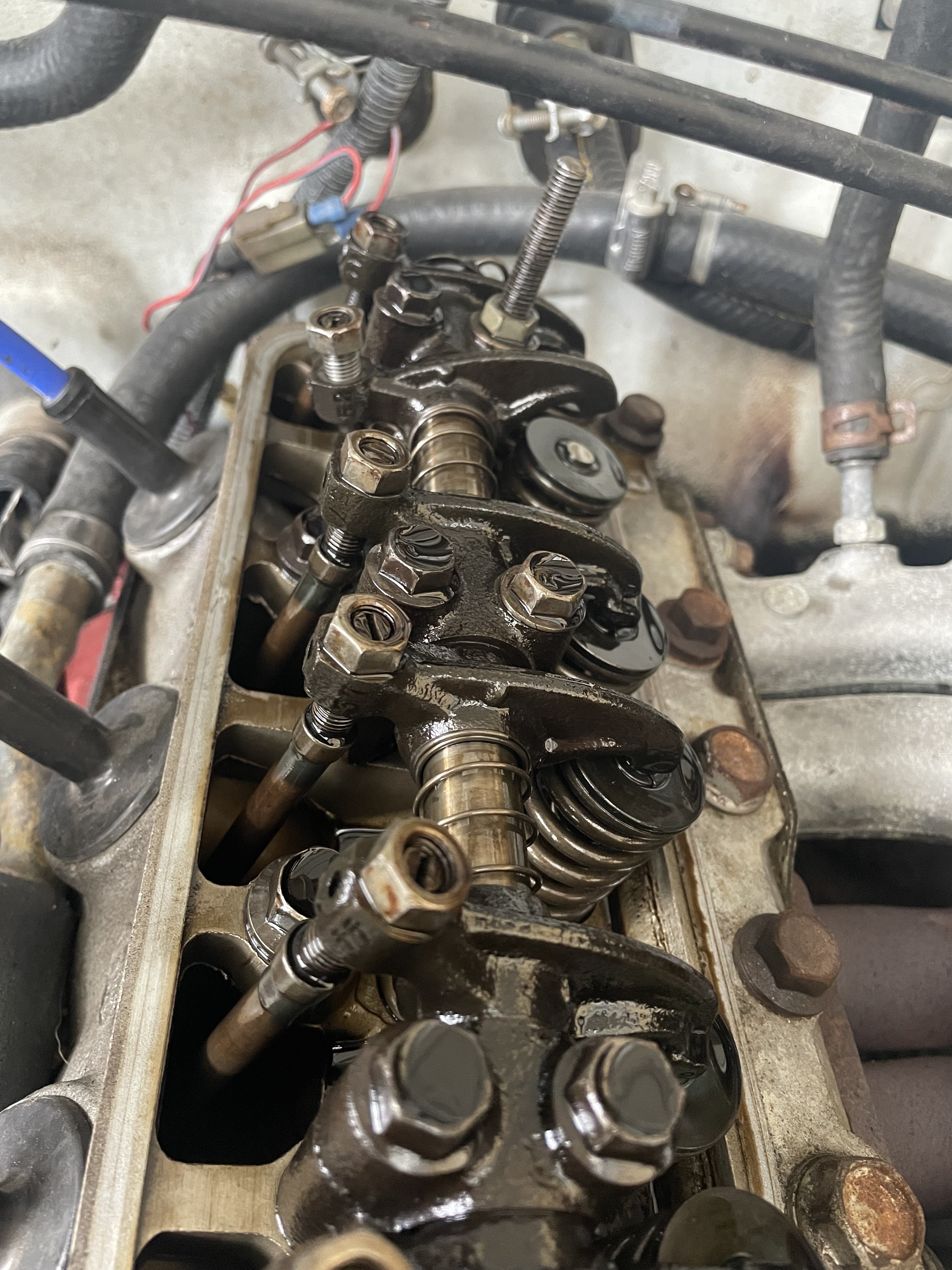

  2. I have just pulled apart the spare engine that had come with the car, not sure if it is a runner but the push rods from my engine were 180mm long while the ones from the spare are 186mm. Do I have to take the head off to find the head number? And should I just swap these out and call it a day or is it better to look for any other mistakes that may have been made. Here's a photo of the different rods. The one on the right is from the spare engine. Cheers Jack
