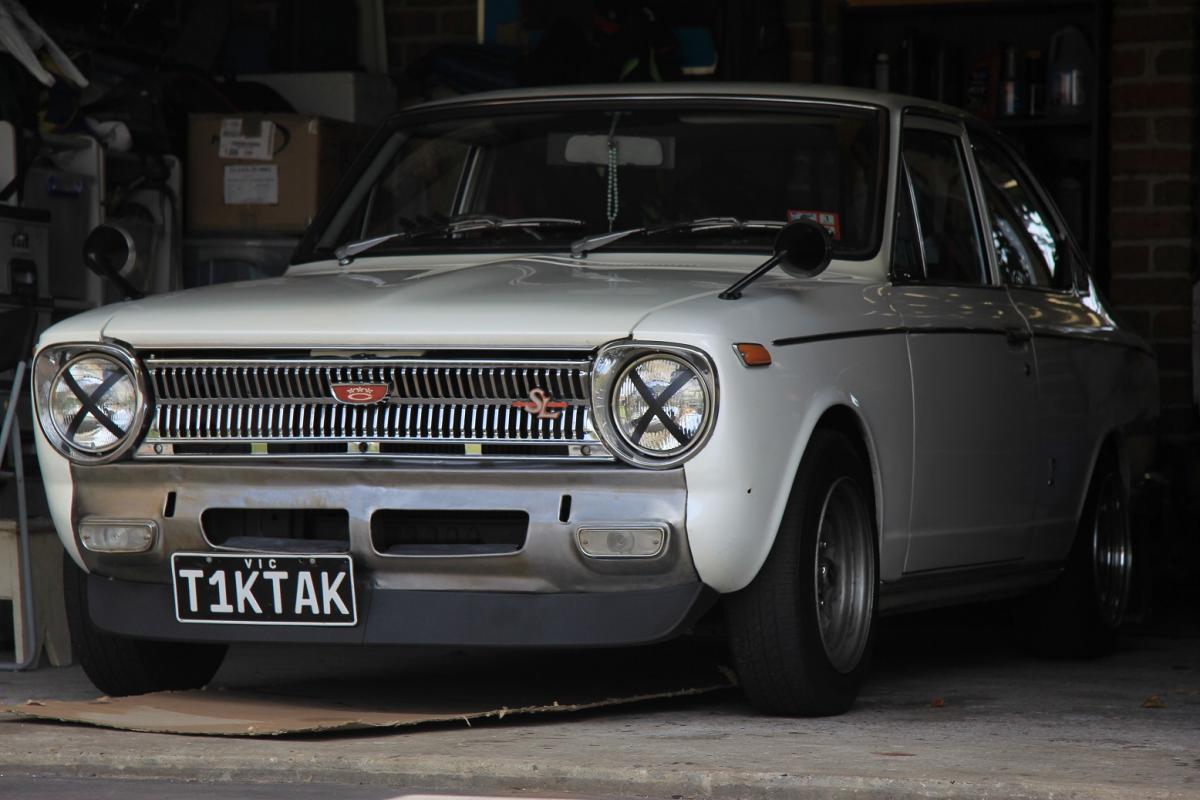

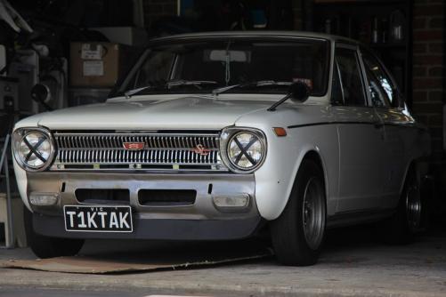

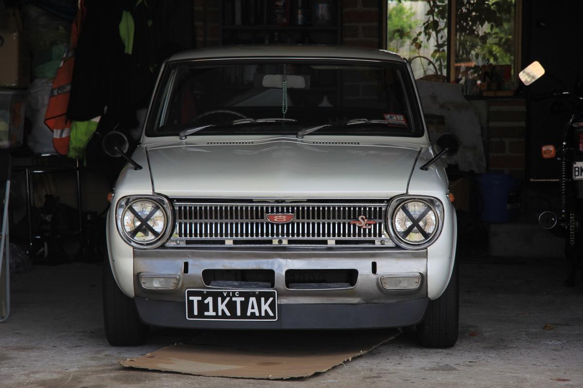

  4. What it looked like yesterday.. At the stage where I'm not sure if i want to go cutting it up and putting flares on.. Hrmmm.. Cheers, hope you like... Also .. getting cam done.. Got told by Clive Cams they will do a 161? haha no idea.. I'm an idiot and didnt get the specs.. heard they are quality place so.. hope its all good :)

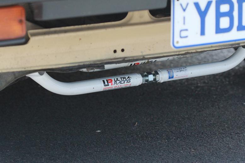

  8. One of the boys has it on his ke70.. well didnt have a close look... looked like a sway bar :P the pic is below.. Now for my sway bar. I will go check one set up that a bloke said worked out n then update this.. haha don't want to even post a picture of 'what was planned' haha ..

  10. haha ferk, don't want to be pole vaulting anywhere! :P Gave it a crack yesterday, quit half way coz of the temperature haha but noticed that the bar will probably foul on the body now. Ill try n upload a photo soon.. its getting too 'Ugly' now.. not sure if ill be doing it.. :S ... If the bar is under such loading how can there be those adjustable one's? Like with that thread and bold set up in the middle of it.. Wouldnt that give way as well? Cheers. Ill take some photos today.
  11. Yes it chamfered, not too much but yeah after cutting it we cleaned it up and layered the welds. I think it should be strong enought to hold but will it loose its 'spring'?
  12. so i bought a whiteline swaybar for my ke17.. annd it fouls on my brake calipers so i had it shortened.. as in cut a chunk out of the middle n then re-welded it. now I'm getting mixed reactions..some say it needs to be heat treat it, lost its strength etc.. and some are saying it will be okay to chuck it on... opinions.. ? think ill chuck it tomorrow, see how we go? cheers amar
