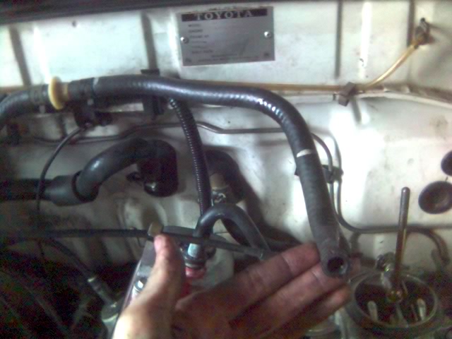

got my engine back together, man its fun pulling apart k engines
anyway, i ran into a snag
where does this go?
anyone familiar with ke70's please reply
That is the vacumm line for the brakes, It needs to get vacumm from the inlet manifold and it is needed if you want your brakes to work.
Yes, When you start the car let it run for 5 mins or so then pull that hose off and it should hiss a bit from losing the vacumm just make sure its working.
