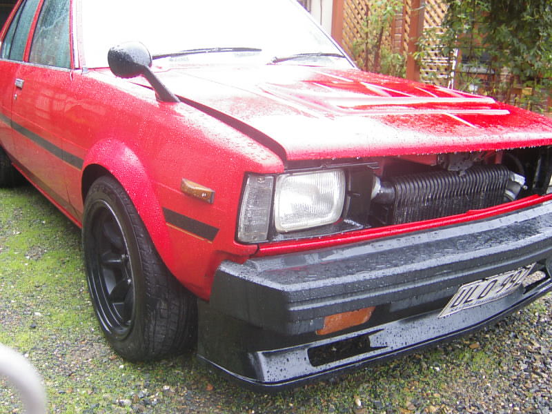

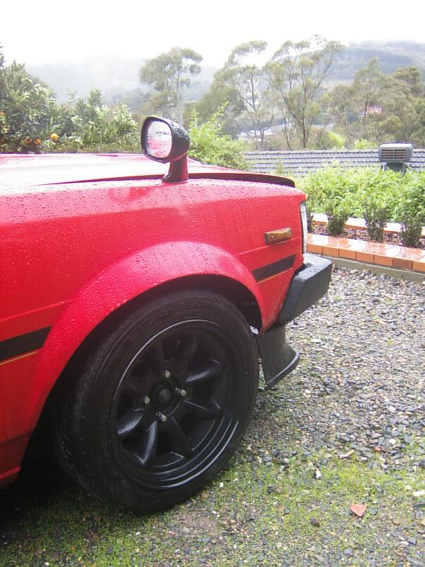

post-2860-1182474982_thumb.jpgget a hammer and a dolly block and bashthe living shit out of your guards... bog, sand and then paint the guards.. its easy as, just takes alot of time... heres a pic of mine..
hahahaha nice how the shi! did you get them so even hahaha
Edited by AE71 DRIFT
hahah getting em' even takes patience my friend...
it took me like 4 goes of bogging sanding, bogging sanding.. etc.. the key to sanding it is to use a large block of wood with paper... good luck
