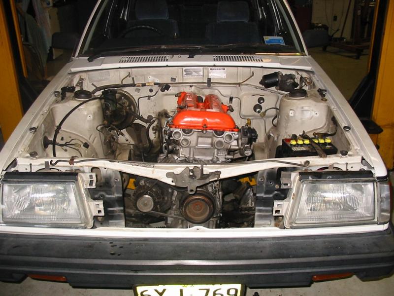

  1. One of the most helpful things you need to know about doin this is you CANNOT put the box in after the engine or drop the box once its in you need to put the engine and box in already asembled.. I'm in the process of doing an SRde+t into our little AE71 fairly simple all i did was drop the engine moked it all up then cut the engine mount brackets off the crossmember and re tacket them were they needed to be.. I'm only 18 and this is my first project car this massive lol but i think youll find with some patience and a few late nights youll be fine.. heres a link to some of our progress pics enjoy.. and good luck with your build.. if you have any questions please don't hesitate to pm me :jamie: Pics here http://www.putfile.com/shiftee86/images/114562 http://www.driftwa.com/forums/index.php?sh...c=2353&st=0
  2. Werll so far weve only been doin the project for about 3 weeks and the engine and box are in :jamie: all were waitin for atm is a clutch pedal that will be here tomorro yay.. lol.. other than that once ive finished the fuel system and turbo lines we pretty much will just need a diff and tailshaft made to get it on the road again.. then the other things like suspension and paint and wheels will come.. :o can't wait so I'm guessing another month max till its on the road again.. We did have it easy though i have full time acess to a hoist and all the tools you could think of as the car is at my old mans workshop.. chipmaster :lolcry:

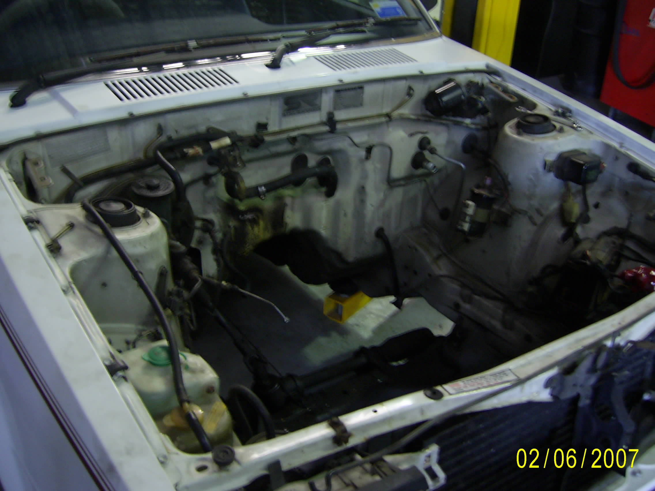

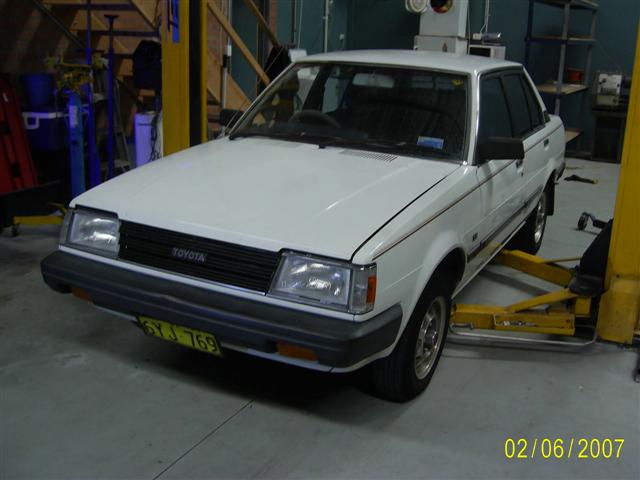

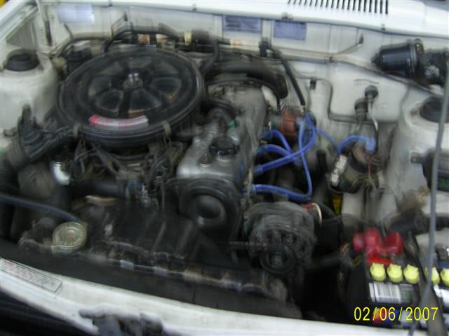

  5. more :jamie:
