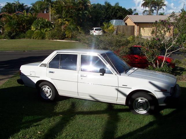

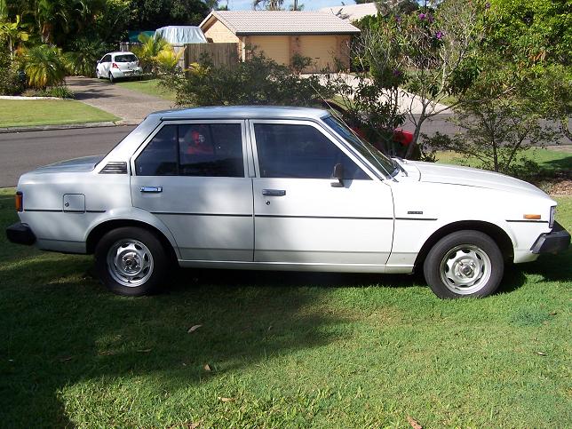

Jordan's Immaculate Ke70.
Car: 1983 Ke70 Sedan, Flat front, one of the last flat fronts :(.

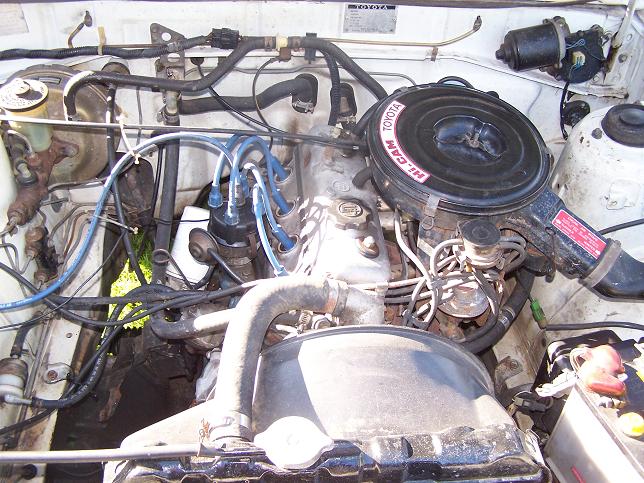

Motor & Driveline: Stockkk!
Suspension & Brakes: Stockkk!
Wheels & Tyres: Stockkk!

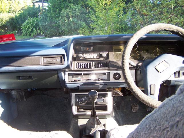

Interior: Stockkk! But immaculate! :y:
Body: A few dints on the bonnet, Absolutly no rust at all! :y:

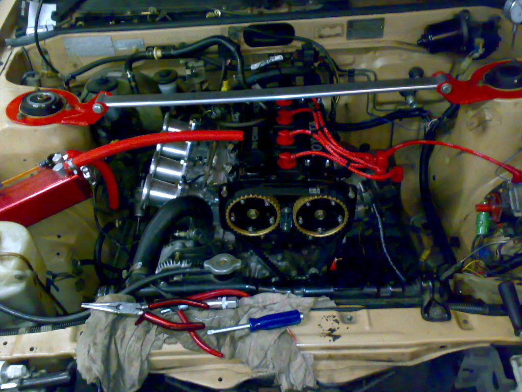

Engine: Specs:
Bigport 7 Rib Bottom End
Small Port Head, Shaved a tad for slightly higher compression)
Fully Ported and Polished, Valves Re Lapped
HKS Valve Springs
Wade 800A Cams (253 at 40 thou)
Techno Toy Tuning Adjustable Camgears
Techno Toy Tuning Velocity Stacks
Techno Toy Tuning ITB Manifold Adaptor
Silvertop Quad Throttle Bodies
Kaizen Garage Extractors (not fitted)
Adaptronic ECU
TRD Ignition Leads
Just had a new timing belt service done and cams dialled in to Wade Spec, to make max power between 3500 - 7500 RPM
Head assembled by head works in carnegie and clearence set to wade spec (10 thou) setting up the head was $900 on its own
This engine owes me well over the $6500 mark, not including the time it took to put together.
The bottom end was in the car before i put the rest on, was standard bigport as it was my daily, rebuilt approx 20000kms ago went it went in, has a exedy HD clutch of the same age.
