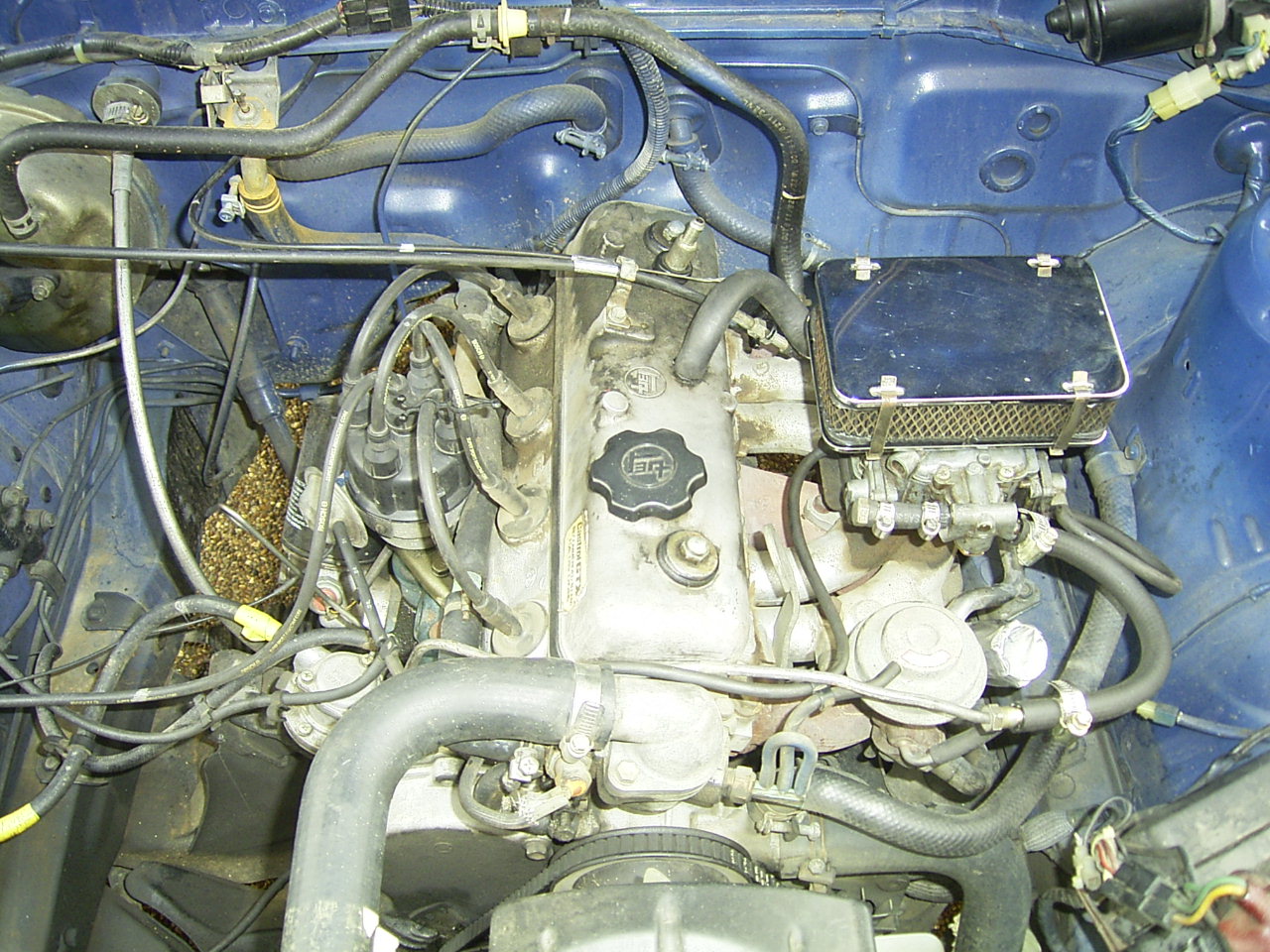

I found this picture... so i might have a crack at this setup tomorrow..

that is a weber^^
I'm not sure if the carb needs some of those vaccumes etc for it to run properly or not. you could also swap over the carb from the ke70 4k.
i put a weber on my 4ac and ripped off all the emmisions, only run the advance to the dizzy.
I know it's a weber. I found a picture of a 4k with a normal carb (3k carb i think) with one emission line going from the dizzy to the carb..
No one has any input?
That would be my engine bay in that pic. Engine is a 4K-C but I removed all/most of the emission's gear when the Weber went on. All you need to do is connect the the Vacuum Advance from the dizzy and the fuel line and it should run. I'd say it should be pretty much the same idea if you are trying to use a 3K carbie as opposed to a Weber. I think there is a picture of Medicine Man's old Nikki carb set up on a 4K in the FAQ which I used to work out what emission lines could be blocked/removed.
Thanks mate, i just looked that one up. I will try that tomorrow as it currently does not have the fuel line one (?) connected.. I'm not sure if i have it in the correct vacuum on my carby (4k pretty sure, different from my other one) also, as it's different to the one i have in my manual and on my old 4k carby...
