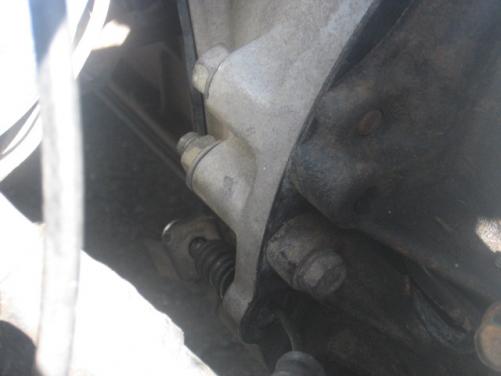

guys just got a new clutch cable other one broke.. but need some help ive got most of it out but its still in the gear box.. i don't know how u get it out heres a pic of what i mean.. would it be easy to do coz i don't have much time coz i need the car tonight please help!...

hey rob
give me a minute i'll go look at mine
Edited by dashills
hey rob ,
there seems to be a hook on my cluch folk so it should just pull the cable towards the boxs and unhook
just relooked at the pic and are you stuck on the folk or the cable hole on the box
Edited by dashills
yeah I'm stuch on the cable hole.. i thought it would be easier coz its just a cable.. grr
yeah i know what you mean when i did the box in my e7 i had a s#%t of a time but you have to force the rubber boot thing though the hole take the bit that folk holds and unscrew it
putting the new cable in be careful you don't rip the dust cover boot do it slow
Edited by dashills
comes out the other way, asin pull the cable through the hole towards the box, not towards the engine
hey , sorry my mistake, it is towards front
lol it was easier than i thought... my mate came and helped me it only look like 10 mins piss easy
