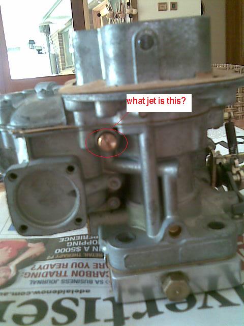

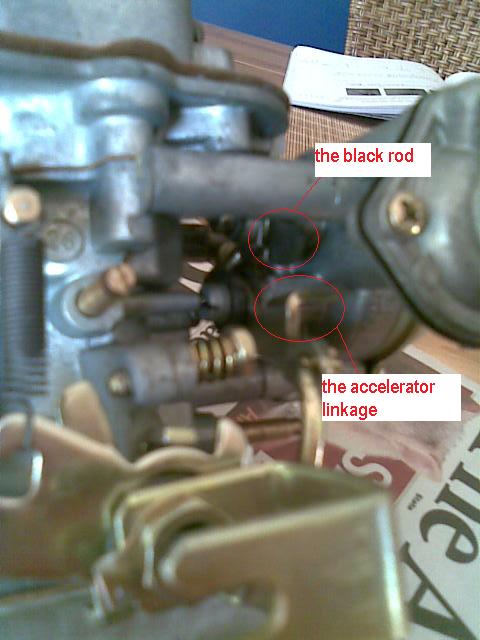

Palmy Posted October 7, 2008 Report Share Posted October 7, 2008 1. in my 32/36 dgav weber i am yet to change the jets to the sizes recommended in the FAQ (as i have a stock 4k) but when i read: 130 mains 170 air jets 50 idle which jets r the mains? are the 2 small jets (fuel jets) in the fuel bowl the mains because they r the only other changeable ones..... and a few other questions.... 2. should i fill the fuel bowl a bit when i first put it on to start it? 3. what jet is this? it has a 50 jet in it. but i kno that the idle jet is on the other side. 4. when i rotate the accelerator linkage, it does not open up the top flaps. there is a tab that is meant to be pushed by a lever on accelerator linkage but they don't come into contact, pics below. Quote Link to comment Share on other sites More sharing options...
toyota_ae71 Posted October 7, 2008 Report Share Posted October 7, 2008 1. in my 32/36 dgav weber i am yet to change the jets to the sizes recommended in the FAQ (as i have a stock 4k)but when i read: 130 mains 170 air jets 50 idle which jets r the mains? are the 2 small jets (fuel jets) in the fuel bowl the mains because they r the only other changeable ones..... and a few other questions.... 2. should i fill the fuel bowl a bit when i first put it on to start it? 3. what jet is this? it has a 50 jet in it. but i kno that the idle jet is on the other side. 4. when i rotate the accelerator linkage, it does not open up the top flaps. there is a tab that is meant to be pushed by a lever on accelerator linkage but they don't come into contact, pics below. Hey mate, 1)where the jets are... clicky clicky 2) shouldnt really matter 3)there are 2 idle jets thats one of them, and the other should be 60 if I'm right? Quote Link to comment Share on other sites More sharing options...
Palmy Posted October 7, 2008 Author Report Share Posted October 7, 2008 Hey mate,1)where the jets are... clicky clicky 2) shouldnt really matter 3)there are 2 idle jets thats one of them, and the other should be 60 if I'm right? hey thanks for that, didnt kno there were 2 idle jets. the question i desperate 2 kno is number 4...... or i could jus sell it n get dellorto's hahaha if only money wasnt an issue Quote Link to comment Share on other sites More sharing options...
